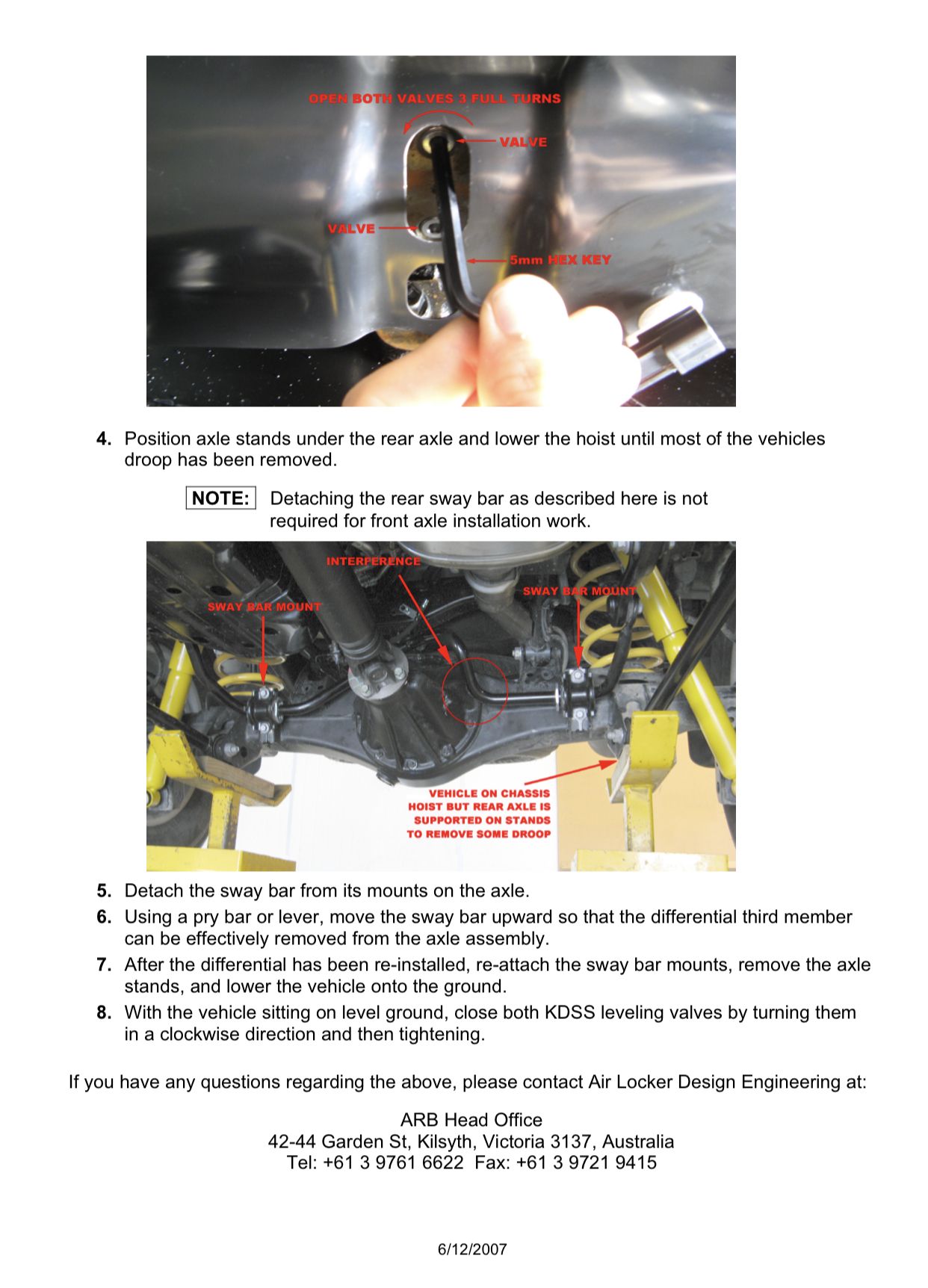

Here’s the word from ARB to their techs for install re KDSS: (I keep thee pages on my phone if ever I have to hand my truck k to a tech just to be sure they get it)
