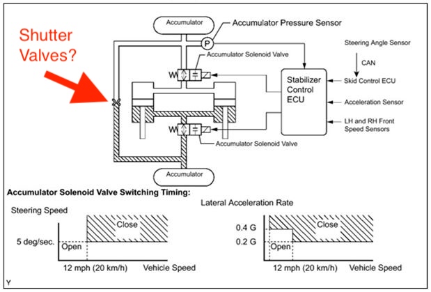

I've seen videos where the KDSS lean is corrected by opening the KDSS shutter valves, compressing the KDSS pistons (located on the LH side) by rolling the LH wheels over a block of wood or by lifting the RH side to compress the left, and then closing the shutter valves. This seems to help 'balance' or correct for a bias in the system.
Does this mean if you disconnected the stabilizer bars entirely, opened the valves, pushed the KDSS pistons themselves all the way up (with floor jacks for example), and closed the valves that the pistons would stay compressed?

If I'm understanding the KDSS diagram I normally see, only one accumulator will be compressed and the other will be uncompressed, not both.
Full disclosure I have a 4runner but I feel like the LC community might be more technical. Is there any functional differences with the LC KDSS versus the 4Runner?
I feel pretty confident that the system will allow the pistons to fully compress at maximum articulation, also I was doing this with the shutter valves open so the pressure should be equalized between the high and low sides. In the testing I've done though, the pistons always return to their full length, regardless of the amount of fluid I move from the high to low side (or vice versa) across the shutter valves. I'm guessing the intrinsic force of the piston pushing down is enough to overcome the pressure of the accumulators.
I'm trying to figure out how all the discussion about 'calibrating' the KDSS piston position works, from what I've experienced it really shouldn't be possible because the pistons always extend. There's no way to keep a piston in a 'neutral' position with the fixed stabilizer bar link.

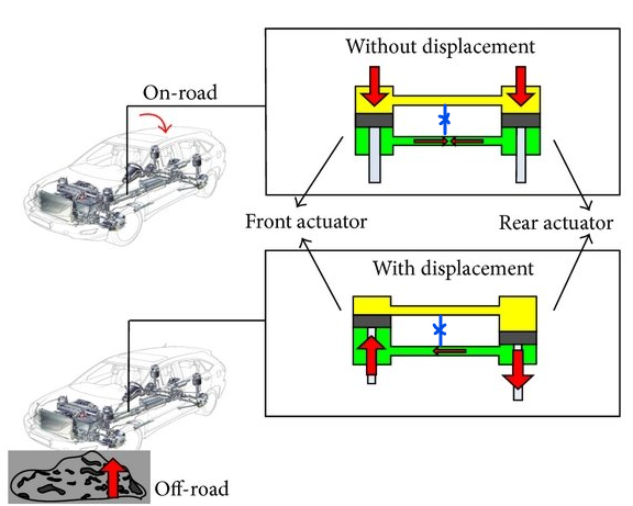

On a 200 series I do not think lean can be corrected by KDSS in the long term (I actually assume on the 4 Runner and GX as well, however never looked at that setup in detail). You can maybe temporary force the lean to be cancelled, but within days it will be back to the position the springs and weight distribution of the vehicle is pushing it towards, as the system is not perfectly sealed between yellow and green sides.
Now it is possible when you work on a vehicle (e.g. I experienced this during a tire rotation at home and having lunch in between) that you create a lean which is temporarily forced by KDSS. The way to resolve is a two turns on the hex (like on my 2021) or allen (older 200) bolts and let the vehicle settle (either parked and rocking it some like i did, standing on the running boards and using the roofrack or by driving around) and close it up again.
I have expanded on how KDSS works in another thread. The 200 series has no electronics like the GX and the 4 Runner. Nice and simple.
Copying the simplified diagram below, including the blue representing the hex/allen bolts allowing equalization (2 turns open) or isolation (normal closed position) between the yellow and green parts of the system.
I do not think lean can be corrected by KDSS in the long term on a 200 series. You can maybe temporary force the lean to be cancelled, but within days it will be back to the position the springs and weight distribution of the vehicle is pushing it as the system is not perfectly sealed between yellow and green sides.
Perfect this is similar to the diagram I posted. So, theoretically, if you open the valves marked by blue (the hex bolts, called the ‘shutter valves’ by FSM), move the pistons up such that most of the fluid moves from the high (yellow) side to the low (green) side, then close the valves, would the pistons stay up (suspended by pressure below) or still come down?
Your simplified diagram doesn’t have the accumulators which may make answering more complicated. From my practical experience though, doing exactly what I described above, the pistons still come back down to full extension. Now I just want to know why!
