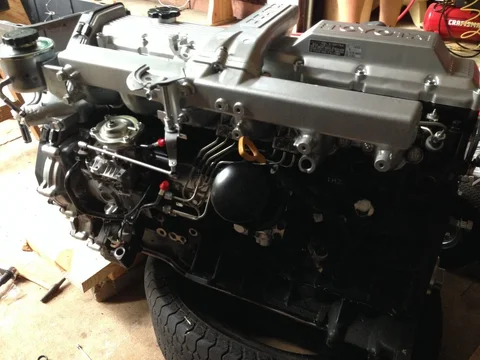

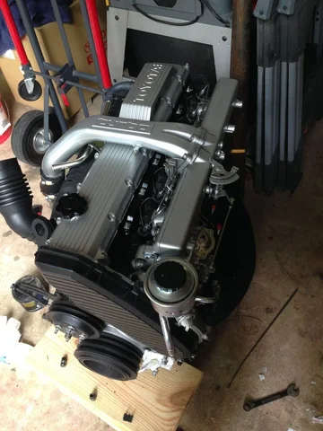

Hey Zac. Having been down this road recently I can tell you that you cannot get a complete 1HZ engine assembly from Toyota here in the states. You can however get the 1HZ short block for about $3300 then you'd need to source a core 1HZ to pull the head, IP, timing case and gears, etc. You can source most every ancillary part you would need through the dealers here in the US, but a few items would need to come from Toyota parts suppliers outside the US. Akella here on the board is a great source for those needs. Beno is a great source for your state side parts needs and very knowledgeable.
All that said with some time and a nice pile of cash you can have essentially a new 1HZ here in the states :grinpimp:
If you have any questions shoot me a PM.
Good luck!
