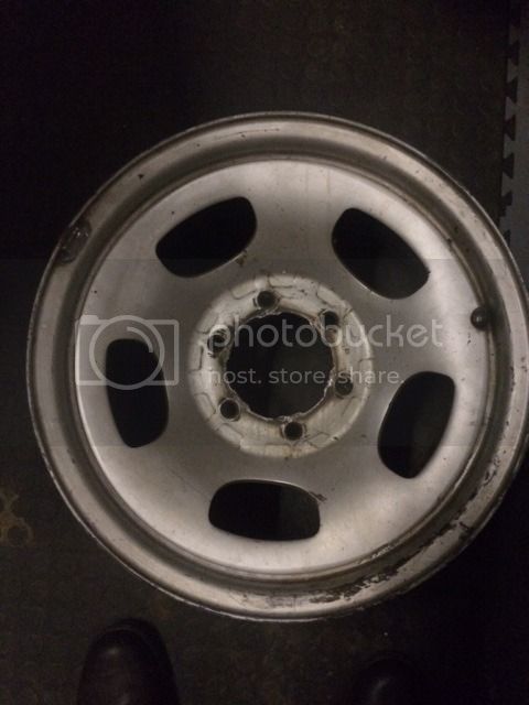

I just bought Maxxis Bighorn 255/85/16 tyres for the 74. These will go onto the 80 series steel rims. I will post pictures once done. Next step is body shop on Monday. These are the steel rims before they went in for powder coating.
Don't forget the spacers...
Thanks @Diesel42 I will locktite them. Once again thank you. Great quality.
