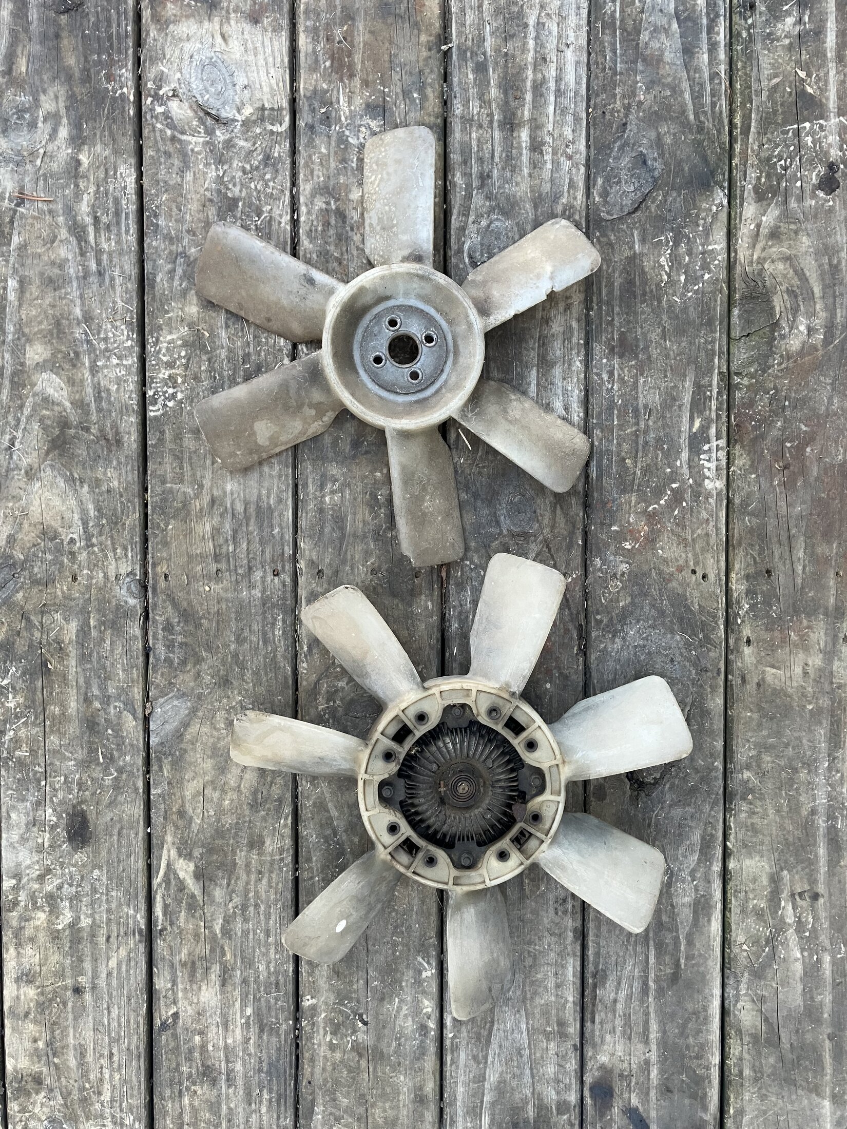

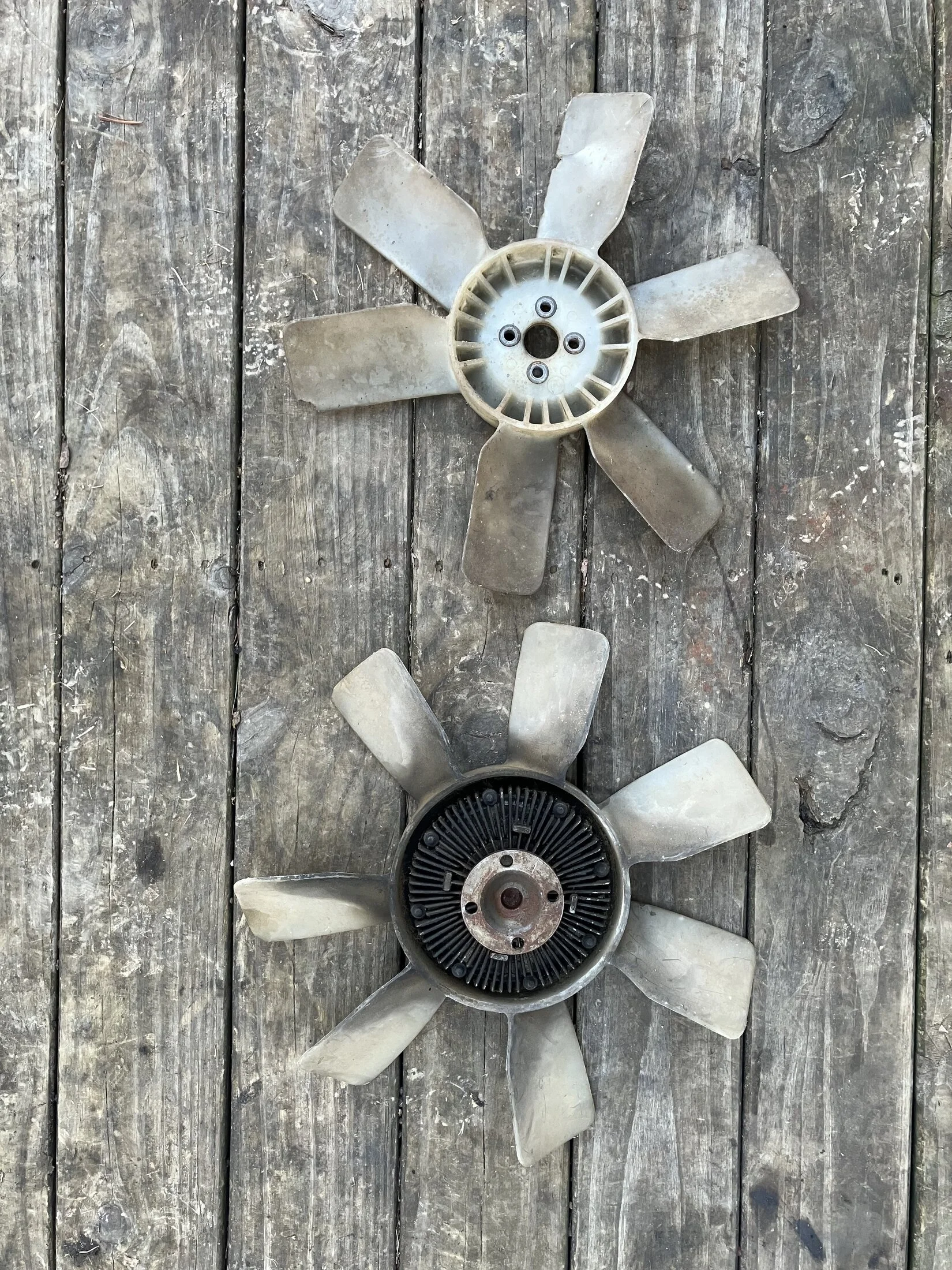

Thanks so much for taking the time to dig through your stash and post photos. The top fan looks like the right unit. I'm just worried about with cracks with the older plastic, if a piece cuts loose, I'll be rebuilding a fresh radiator. Again, thanks for looking but I'll keep hunting. If I fail to find anything, I'll let you know.

The lower fan in your pic has a fan clutch. Those don't go well in a Pig, the direct-drive fan will
