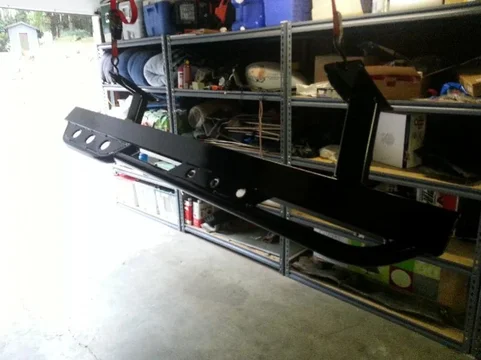

I have OPOR sliders (MT made) with 3 legs and after installing/reinstalling about 5 times I wish mine had only 2 instead of 3 legs. The 3rd, middle mounting leg makes contact with the body of he LC due to the MT mounting flange. 2 legs is plenty sturdy to take the weight of the car. I wish I could have ordered mine with with only 2 legs. The groaning sound of the body/slider contact drives me crazy.
I believe the non-ahc sliders have 3 legs... For me it's not going to be a big deal.
Sent from my Galaxy S III using IH8MUD app.
Thanks, good to know.
Interesting, why are you taking them off so often?
