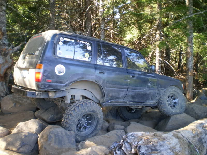

Nice! Seems like a 80(fronts stiff).

Great rig.(like mine)
