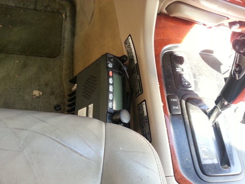

2m Ham mounting location. It's hard to hide a FT2800 and still make it usable:

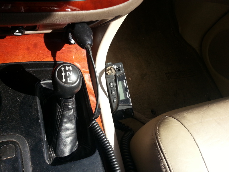

It worked so well I matched it with my CB:
