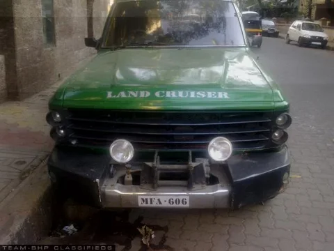

:clap: Congratulations! I just came home from 5 months in India. I only saw one landcruiser the whole time there! Where did that grill come from? Keep us posted with all the upgrades. What part of India are you in?
Tks @ cruiser pilot I'm from south India as far as grill I'm not sure where does it come from looks like a properly done grill n head lights but no idea how they did it as I procured the vehicle from auto dealer and no info about the previous owner. Planning to rebuild right from chassis as it is rotten needs proper attention to every part of the vehicle.

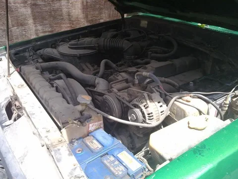

The underside alternator seems the original one, bring it to a shop or check the alternator brushes yourself. Remove the upper one?
Remove the extra battery next to the exhoust, is that thing shielded fro the heat? If you want the extra power (camping) replace it later?
Or that extra battery can help the original battery charge? is seems a separate sytem.

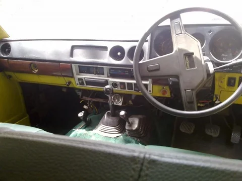

I was just noticing, factory rear slider window? wood grain dash insert? and what is the extra lever on the floor for on the far left- ahhhh, PTO drive lever? Yellow interior is because its got to have bright colours. In-dash inclinometer. ANd of course the ever cool highline roof.

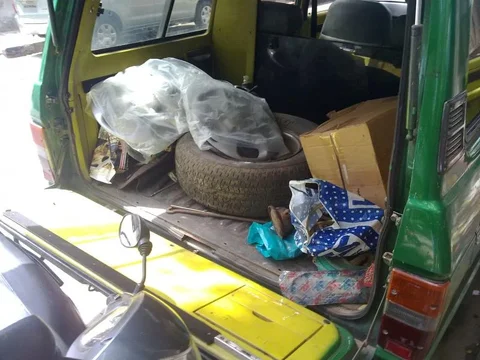

Could you open it up from the back and take more interior shots? Does it have rear barn doors?

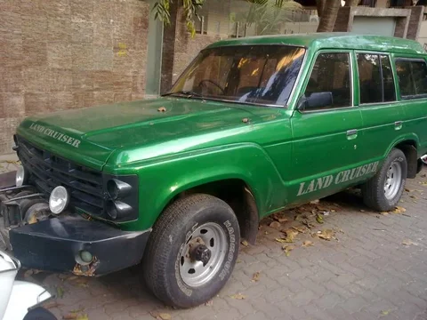

@ Hj60- your words gave me some boost, will upload shortly some more pict to give you all clear pict, drove the vehicle for 700+km engine is giving out lot of smoke not yet gone for compression check of the cylinders PO has Betten up the vehicle to a great extent, I'm not into frame off but frame looks rotten so needs sand blasting and proper rust proof coating at the same time rear leaf spring is almost flat which needs hammering are will go for iron man if got money. First thing want to get wiring checked with my electrician then alternator hope can be repaired, fluids already replaced service radiator etc.
Sure would like to see more pics..
@ cruiserpilot , Hj60 and who ever view the pict please do not get angry after seing the pictures will try to fix things and get to a level from where i can say i own a FJ60 sorry for the current state of the vehicle :bang::o
you can see the condition of the chassis and rear leaf so am i wrong about reparing the chassis:bang: any sugestions and comments frieds
Looks interesting. I left a plane @ Delhi for a month, it looked like that engine compartment! Just got to clean it up. 3 batteries? It even looks like storage in the tailgate. This is a unique vehicle. Like I said, I only saw one 80 series in all of N India and I travelled alot for 5 months there. Good luck getting it all up and running.
The leaves are tired but ok for now, the chassis seems ok, need more pics from below. The rust in the door is ok> it is a door :D
