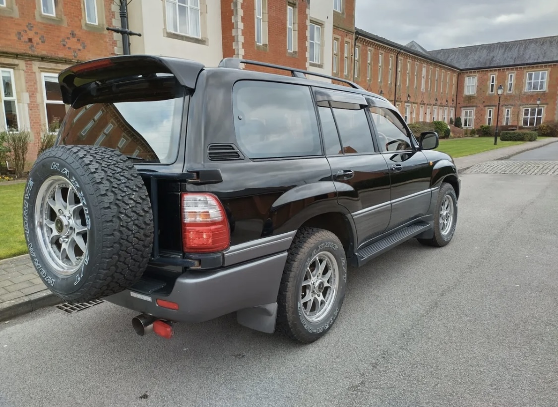

Hi all
I just converted from Land Rover Discovery 3 to LC Cygnus 4.7 1999 70kms - due to my Disco having suspected crank snap
Was advised to visit this forum due to being petrol 4.7 LC100 model
I’ll use my LC Cygnus petrol for towing 3.5 tonnes nationwide for work purposes in the summer
I wanted to ask some questions to get me started if anyone would be able to help please? I’m hoping this forum is like the LR one and will have enthusiast happy to help people like myself
Am technically minded and did a lot of work on my old car so am confident I can do some DIY to the new LC
Firstly - I can’t see when the timing belt was done so I wonder is it easy to do or should I take it to a Toyota garage? I’ve done a timing belt before on two occasions so if it’s not a hard job I’m sure I can do it. What brand should I go for?
Is there a local indie to north wales / Chester area?
Any other parts I should renew now I’m the new owner to ensure it’s got what it needs?
My car doesn’t have a tow bar - I’ve just ordered one to bolt on so that’s hopefully sorted and I’ve located the wiring loom
Can these be mapped to improve MPG? As I’ll be towing fully loaded 3.5 tonne trailer and 5 staff nationwide I’d like to save on fuel if possible by mapping
Is there a specific code reader tool people use for Land Cruiser? My LR one was a GAP IID tool so I’d be looking for a similar phone app style decent plug if there is one for LC?
I’ll start with these and then throw more questions in as I progress
Thank you in advance!
Chris

Hey man, to comment on stuff that should be replaced, I’m sure many people will say the same thing but HEATER T’s. Common failure point. Just check them religiously and replace if you don’t know the last time they were replaced. As far as the timing belt goes, I’m not sure how much work it is in comparison to how much work you’re willing to do. I’ve always had a shop do mine because I can’t afford to have my daily driver torn apart for long.

Welcome and beautiful truck!
Coming from a Rover, you'll likely find less local support in the UK but an even more engaged and enthusiastic international community. This forum is great. Definitely read all of the FAQs if you have not yet, plenty of useful info in there.
Regarding a code reader, almost any code reader works for the basics on these trucks, so you could just get a bluetooth OBDII reader and use your phone. However, I would recommend getting a Techstream cable ($35-40 USD) and downloading Techstream from the thread on this forum. That acts as a code reader, gives live outputs, can help with tasks like bleeding ABS system, and allows you to tweak preferences like security, auto telescoping steering wheel, door locks, etc.
As mentioned look out for heater tees. Also read up on the brake booster and ABS unit, while yours may be in good health they operate a bit differently than many other cars (at least from this era) and are pricey to replace.
I am not aware of any mapping changes that yield significant MPG gain at least while towing, but it may exist. The best thing I did for MPG was replace the fuel filter, air filter, clean MAF sensor, and clean throttle body. That, plus running tires that aren't too heavy for your application, should be good first steps in seeing your real life MPG from a clean slate. I would also replace your spark plugs and check the coils for cracks. Not only will it possibly help MPG, but it ensures that the plugs are properly tight, the plugs like to slowly walk out of these 4.7L heads if not properly torqued down! The above steps should only cost a few bucks and yield a more reliable and efficient truck as your starting point.
You may already know, but assuming parts are less plentiful than they are here in the US, PartSouq is a great resource for ordering OEM Toyota parts for the best prices. You could likely pick up heater tees, filters, and plugs from them for cheap.

Congrats! Welcome to Mud.
I can't speak to the complexity of the timing belt, search on here or youtube for DIY stuff, there is a lot of good info. Toyota or AISIN parts.
There are a few FAQs on here, folks use the term 'baseline'. Essentially you'll want to change out all the fluids and filters, catching up on maintenance in case any deferred items and address any common failure points, although on these vehicle it's not much. Also scan the car for any trouble codes and address. If your Cygnus has AHC Heigh Adjustable suspension you'll want to flush the system and level it.
I've not heard of any tunes that increase mileage. Unfortunately these are thirsty vehicles with the 4.7.
You should just get the factory setup, Techstream. There is a thread on here about how to set it up... This is the cable I use, plug and play https://www.amazon.com/dp/B097YC5LSR?tag=ihco-20

Thanks I’ll get that cable today then - looks like I download software to laptop to do readings. And thanks I’ll get the suspension flushed just need to find a local indie now!

Thanks the plugs and filers and oils have been done already
I’ll look at these heater tees now - is it just a heating part or engine? Silly question maybe haha I’m no pro!

Heater tees. I’d prescribe two of these part number 8724860460 every 90,000 miles. Do not buy fakes off eBay like me. Get them from Toyota directly.
Really cool rig you have there! Congrats on the 100 series and welcome! Treasure trove of knowledge here...
