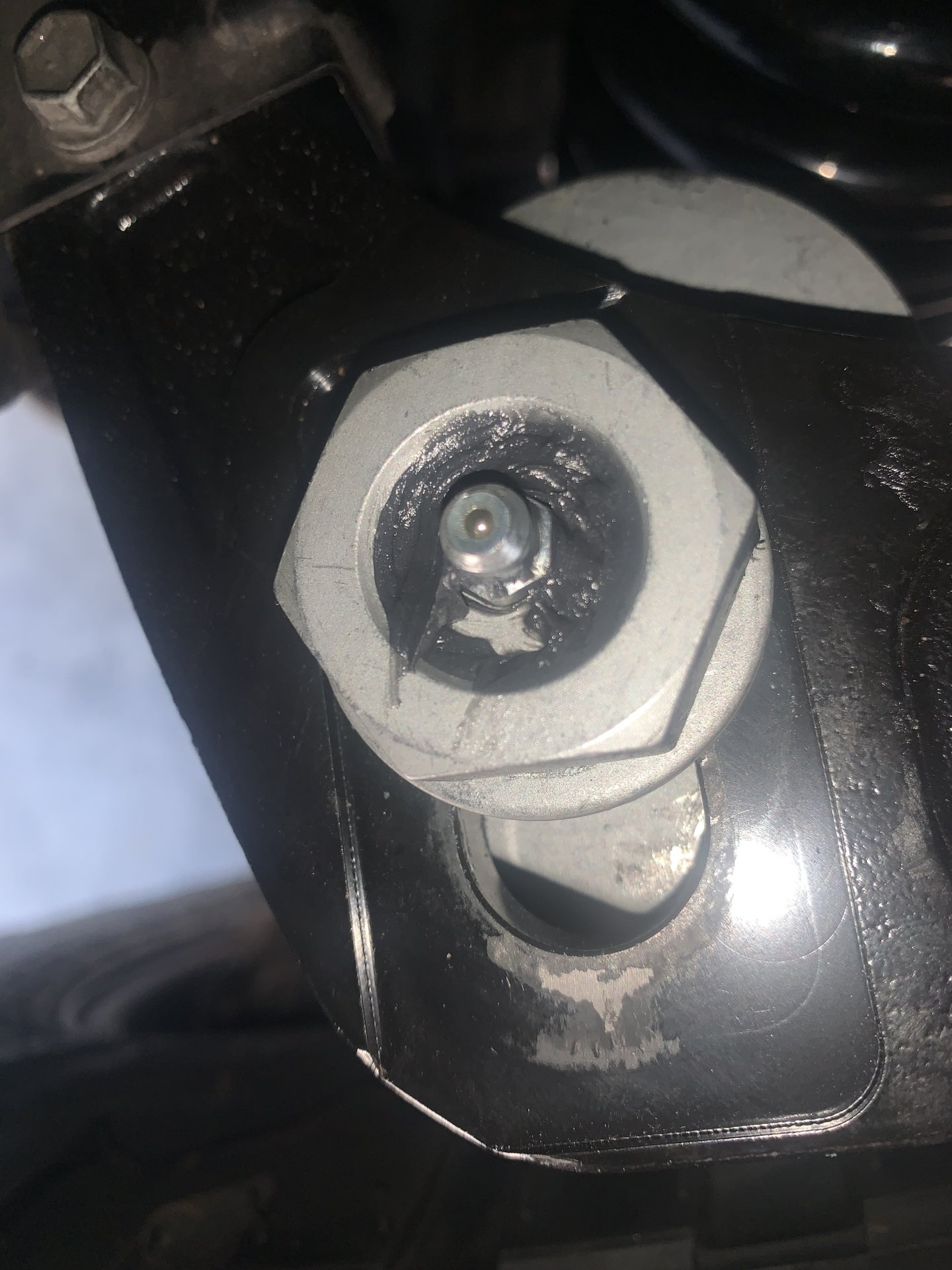

See if this makes sense, maybe post up pictures of the tops of the upper ball joint assemblies from both sides. The "star plate" and the star-shaped splines at the bottom of the threaded stud keep the "U-shaped" piece in position relative to the arm. It would have to be pretty sloppy for that to change. However, if the upper nut was not torqued down, the assembly could side in/out with steering forces, which would screw up your alignment.

View attachment 2719680Yes that is what I’m referring to as the U shaped piece. When I installed, both sides were at the “D” position. Now the passenger seems to be at an “E”. I could take it apart and reset it, but I’m curious if I would have to lift all 4 corners for KDSS or would the one side be ok

Stick your cell phone in the wheel well, and take a picture looking down at the nut in question, and its position in the slot, and you'll know for sure what's up. If both sides are centered, your issue may lie elsewhere. I hear you on alignment shops. Ones around here that come highly recommended for lifted trucks are booking several days to a week out. That's one of the reasons (besides being cheap) that I went with the Freedom Off Road UCA's, there no camber adjustment bolt/nut to confuse the kid doing the alignment...
you’re spot on with your assessment. The bolt is sitting in different positions on either side. Sorry to be redundant but should I try correct this on my own, or is this something I should have the alignment shop adjust?

Looks like the passenger side ball joint has slid all the way inboard. You can see the paint marring. That might have been the "pop" you heard. Can't imagine they had to put it there to get camber in spec. Is your steering wheel offset clockwise?
