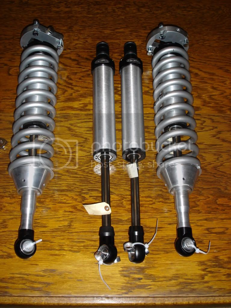

Radflo included two front coilovers, two rear Internal Floating Piston (IFP) shocks and all necessary hardware. For the rear, I continued to use my existing OME medium load springs, which was recommended by Glenn.

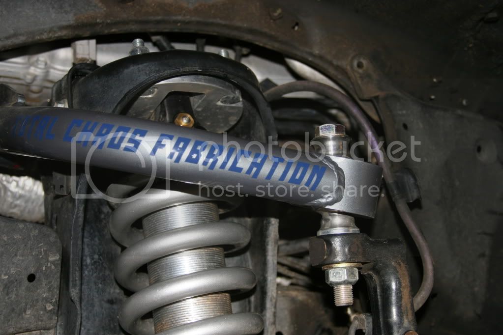

In addition, I’d highly recommend the Total Chaos Upper Control Arms which allowed me to increase front downward travel. I also added the ICON Rear Lower Trailing Arms. They look awesome and should provide better protection, however, I'm not sure how they affect performance. Either way, I’d highly recommend them as well, although they're not required.

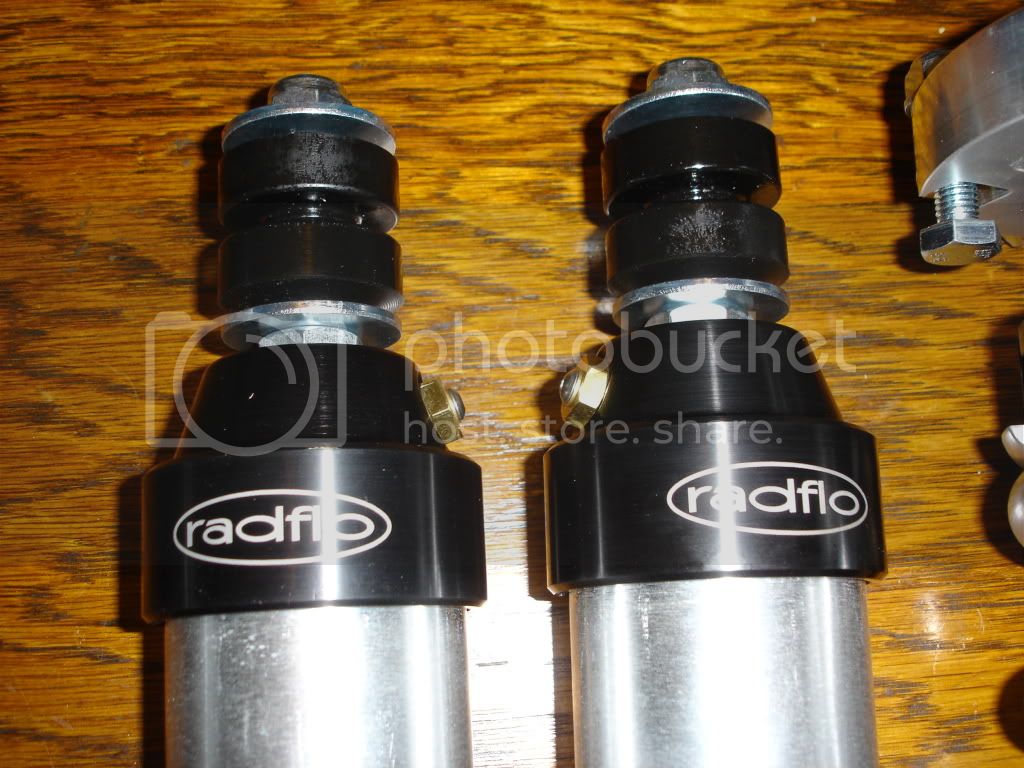

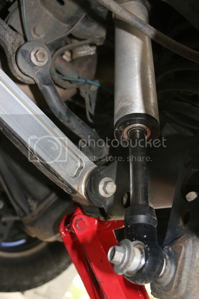

Are the brushing in the shock rod-ends metal on metal or is there a polly brushing?
This post had me looking at a LC at the Toyota dealer during lunch, as with this sort of excellent lift pioneer work, a LC lift would be much easier to than doing one on my LX570. I barely escaped with my wallet.
The heim joints are Teflon bearings I believe.

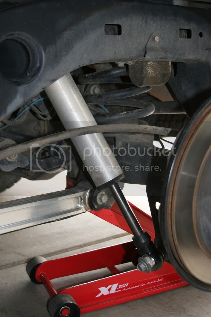

JB, the rear shock piston looks awfully exposed the way it is shown on your picture. Is there no sleeve or shield mounted in front of it to protect it from sand and stones? If I look at my OMEs in the back, there is no paint left on the front of the units, sandblasted completely clean by the fine desert conditions here. Also, from driving on gravel tracks, plenty of nicks in the sleeve of the shock.
You can use the Icon shin guard to protect the bottom portion of the shock along with the piston shaft due to the design of this particular product. It is a simple bolt on, and it is made out of stainless steel so no rust or corrosion to worry about.
Icon Shin Guards
