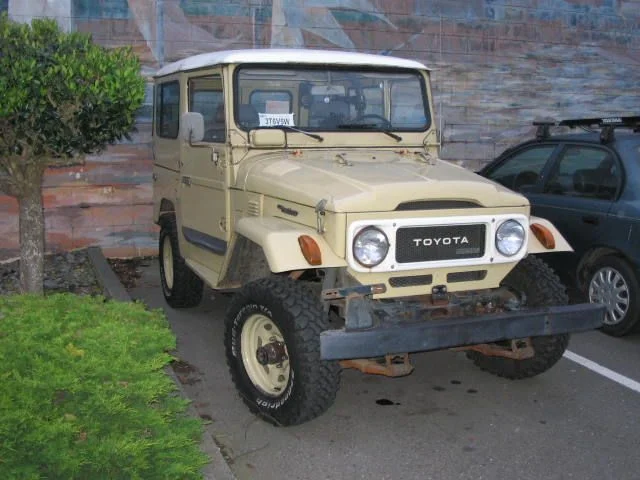

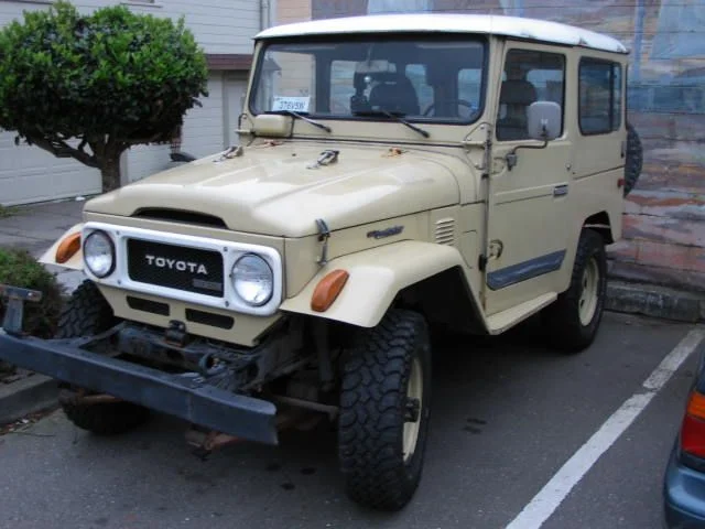

Well folks I just got back from 2 days worth of driving from Vancouver B.C. to Eureka, Cali in my new to me 1983 BJ42. What can I say.... a little buyer's remorse when I drove it and found the tranny to not be as smooth as advertized (feels like 1st and 2nd syncros are really worn :doh: , hard to get in each gear, but maybe a clutch adjustment problem?--yeah right, wishful thinking). As some of you remember, I have been posting about the 3B SWB diesels. I know everybody recommended the BJ70 for a DD, but I just couldn't resist a BJ42 with the 5 spd. and power steering.... and already with an Alu tub and fenders (yeah, I know, detracts from the collector's value, but this one already has over 400k kms on the clock, so forget the collector value...).
Positives: It was actually confortable, though everybody's comments on my earlier post held true (stiff ride, loud, etc.). I did 11 hours straight today, Seattle to Eureka. By my preliminary calculations I got 28 mpg on the 700+ mile trip. It cruises at 70 all day long no problem. Way more spritely and nimble handling on road than my FJ60, but it is just begging to get off the pavement. The compound low first and 4.11 diffs scream technical hill climbing. Massively powerful braking, dead on front end, great low-end torque on the engine. I haven't owned a diesel vehicle in a while and I forgot how much speed control one has with the throttle because of the high compression engine. All in all, a really good example I'd say.
The Cons: Even though I was comfortable, it was a stiff ride, and I confess I wore earplugs for the last 6 hours or so. Needs shocks--very bouncy. A dog on the hills. 5th is not a hill gear, but 4th and lower pull great.

New tires and Paint Wheels (wheels are color matched to the Beige body--need to be white, or chrome???. Tires are 30x9.5 BFG Mud Terrains--really noisy on road, too small)
New rear springs (saggy in the butt and leaning to port), new shackles (recommendations?), new bushings, new shocks all around. Want to keep stock height springs, slightly extended shackles (like CoolCruisers' HFS 1.5" dumbell shackles).
This summer: Rust Patrol. Bottoms of doors, hardtop, cowl. It already has an Alu tub and fenders--I may go with an Alu cowl depending on the quote on the cowl.

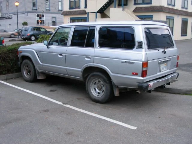

PS Anybody wanna buy a strong running, leaky, excellent frame, good body FJ60 for $2kUSD???

The wheels should definitely be white to match the top of the hard top if you want that classic look.

By the way, what color is your 60?

The 60 is the light silver cover. My fav. The BJ42 is beige unfortunately. If I ever do a frame off, I'm going with Freeborn Red.

"Fixed" the tranny problem--I forgot the seller said you have to really push the shifter to the left, then it goes in gear easily--is this normal for an H55F? However, the linkage seems a little loose too, like when it's in 3rd, so I wonder if that's an issue. But is there any linkage? I'll check the FACTORY MANUALS that came with the truck!!! Muh haha. In any case, driving it today to DMV and back made me remember why I went for one. It's really smooth I have to say. Glad the tranny was not an issue so I can put my money into the body this summer. All the mechanical stuff seems perfect (which is why I got it--had records up the wazzu showing so many new parts). Lots of rust issues though. Not horrible, but lots.

Don't sweat the color. Its one of my favorites.
As far as the shifting goes, make sure to swap out the little teflon cup on the bottom of the shifter. Its a couple of bux from the dealer and really affects shifting. I'll bet the h42s in Fj60s had the cup after '83 but I'm not sure. Check with your local dealer or get a Canuck to mail you one.
