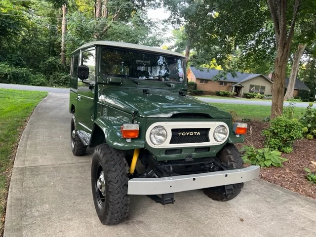

Just received my 1977 FJ40 (originally from Ecuador) that I won on BAT a day or so ago. First time FJ40 owner and bought it understanding there would like be some issues so overall as expected so far. My classic experience is with a 1966 Ford F250 4x4 that I've done quite a bit of work on but I've always been a FJ40 admirer from afar. Happy to join the club and get on with the learning and making it my own.

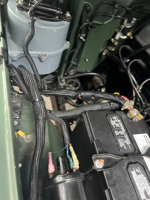

Showed up about as expected from the pics/descriptions. Body not bad, frame solid. Engine rebuild in 2018 totally unknown, could have just been paint. Everything generally works, wiring relatively terrible from an OCD perspective but I enjoy that part of it. Already pulled out a poorly executed security system and put it back to original. Today was spend running down a few bad grounds to get lights all in order and wrapping harness and some other wires with mesh wrap (see pic). Not totally happy with wiring organization yet but getting there. Pile of wires pic was the security system!! Looking forward to many conversations and advice here. Running down a few things here and there and have already spent many hours searching old and current threads. Big plans would include potential disc brake upgrade on all 4 wheels (at least the front, 77 SA has all drum!), possible roll cage like the OEM but will be a little bit of a challenge with the long bench seats, not a lot of room. I'm in Nascar country here so plenty of fabricators/welders to help if I head that direction. What a wealth of knowledge on here. Looking forward to the journey.

Welcome aboard! Lots of enthusiasm with a new project. You look like you've got some good material to start. Now it is just a matter of deciding what is next and knocking things down one at a time.

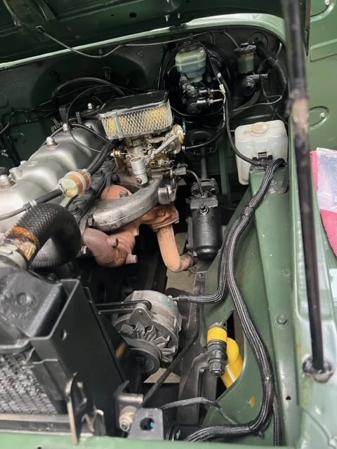

Looks nice. I can see that you don't have a vacuum pump on your alternator (which I think even petrol engines should have right?). This would improve your drum brakes.

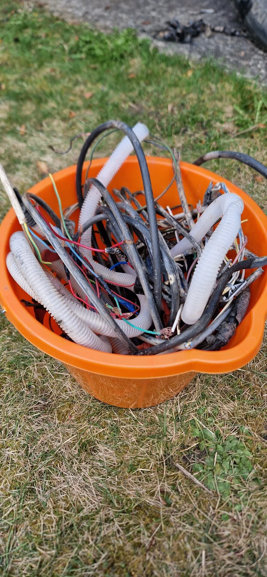

I have a similar pile of removed wires from my 77 HJ.

The wiring harness cleanup looks fantastic. Hope you continue to share your progress and adventure here on the forum!
Vacuum pump? On gas engines, typically you get vacuum from the intake manifold.

Ah really? I thought they all had the pump - my bad. Do they not have the vacuum reservoir either then?
Nice truck. Sounds like you are realistic about what you bought. I would be curious about the amount of Bondo on the body, maybe better left unknown since it does look good.

On naturally aspirated engine air passes thru the venturi in the carb which creates vacuum, which I'm sure your familiar with. When the engine is running it always creates vacuum. A line goes from the intake manifold to the power brake booster, which is like a canister that has a large diaphragm in it to assist in a easier pedal to push. You can see it in one of the OPs pic, it's the round fixture behind the master cyldr.
Yes indeed. The diesel engines create much less vacuum at the manifold so use a pump on the alternator.
This then charges up a vacuum tank under the floor which in turn feeds the servo. This way you have plenty of vacuum even at low revs and after a few pumps of the pedal.
I thought that all 40s had this, but apparently not (this explains the extreme rarity of used vacuum reservoirs).
In my case, I've actually fitted an electrical VW vacuum pump and a reservoir from an Isuzu Trooper. Now I have permanent vacuum as soon as the key is switched on.
The OP probably doesn't need this info, but worth checking your servo for leaks, and your non return valve on the servo too.
