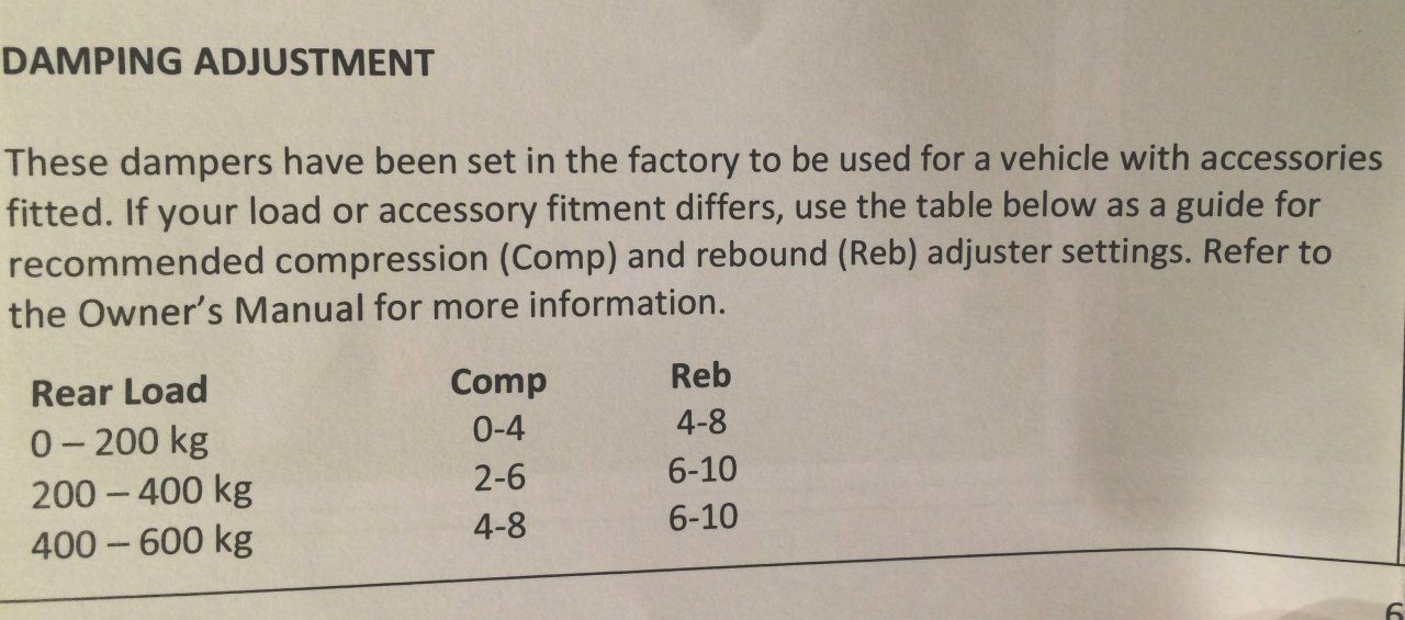

Do any of you know where I can download the install manual for the bp-51 with the suggested comp and rebound for stock LC ?
My shop threw the papers after they installed, going there tomorrow to lower the settings.
I can't seem to manage to do the rear myself as I barely fit under the truck. I'm a big dude.
I'm thinking of going with comp 2 Rebound 4 as I'm looking for max comfort.

Here ya go...
Also... I posted the entire contents of the paperwork that comes with the BP-51 setup here... Scroll down in this thread and you will find photos of pages:

Awesome Thanks.

With the help of my jack I was able to change the setting, I noticed in the ARB documentation the rebound for the front is recommended higher than the back, so now I'm at comp1 rebound 6 for the front and comp 1 rebound 4 for the back, my LC is stock weight, no bumpers etc...
Man what a difference, that comfort is great and it just flies above corrugated trails like its a highway.
Loving it.

Thx for posting this. Makes me want to change my settings a bit.
It's worth fiddling with, if you lift one side of the truck, it's very easy to do the front you don't even have to move the wheel and the back is really easy to do as well.
For those who don't have those, here are the install sheets for the front and rear.
rebound is recommended 2 points higher in the front than the back most likely as there is more weight there.

So how are you guys deciding whether to increase or decrease your rebound dampening? I'm not sure I'm in the sweet spot yet.
I feel like it is pretty easy to figure out compression, but the rebound stuff is a little harder for me to feel.
For me it's seat of the pants and play with it until it feels just right.
Adjust, drive a couple of days on roads and trails than fine tune.
The basis is given by ARB with the load chart, from there it's a matter of trying.
