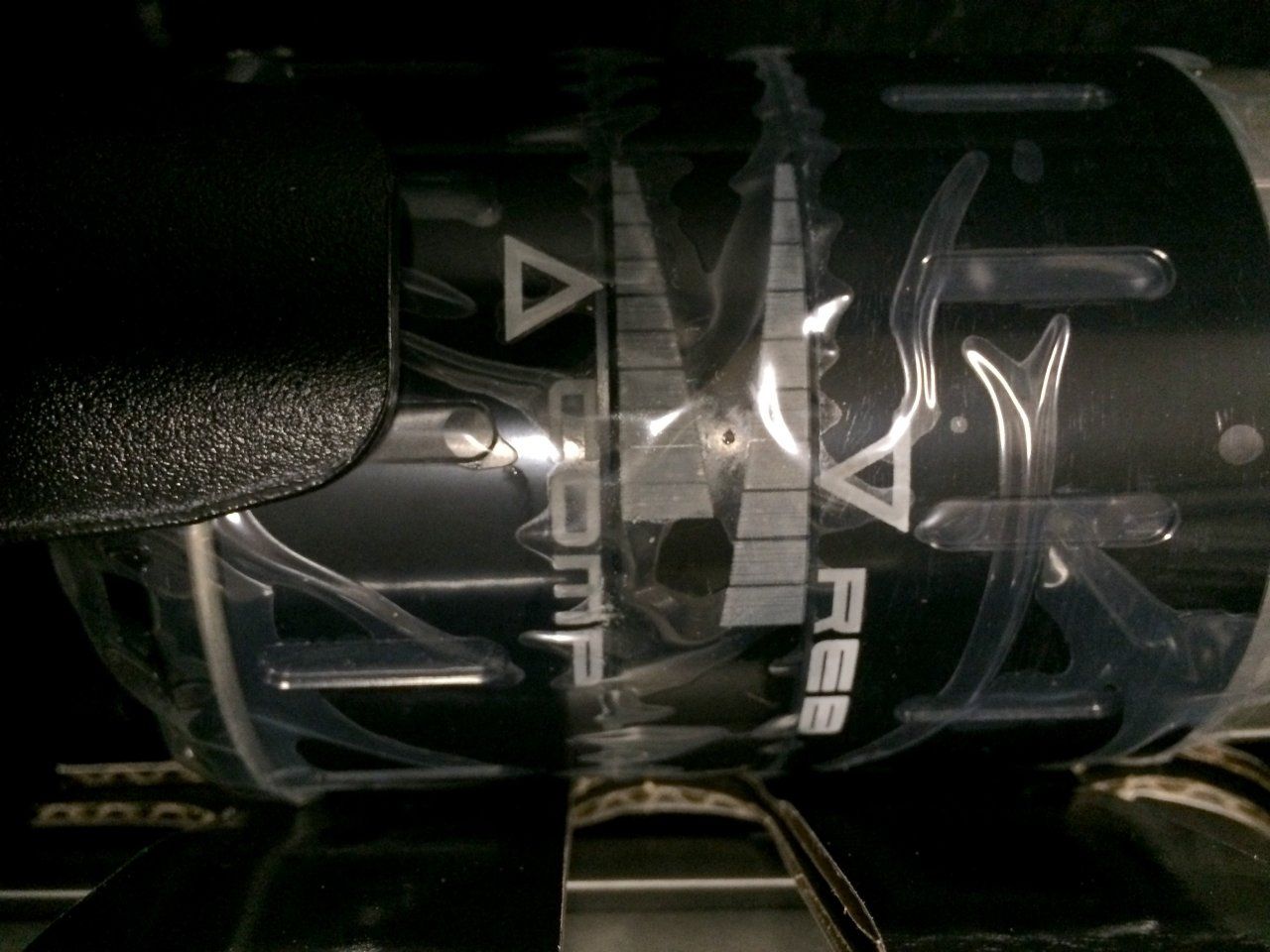

They come pre-set, BUT instructions say that they assume you have accessories installed (bumpers, etc.). So initial suggested settings are based on accessory WEIGHT (or lack of).
Here is what they come preset to (rears only in this photo)...
