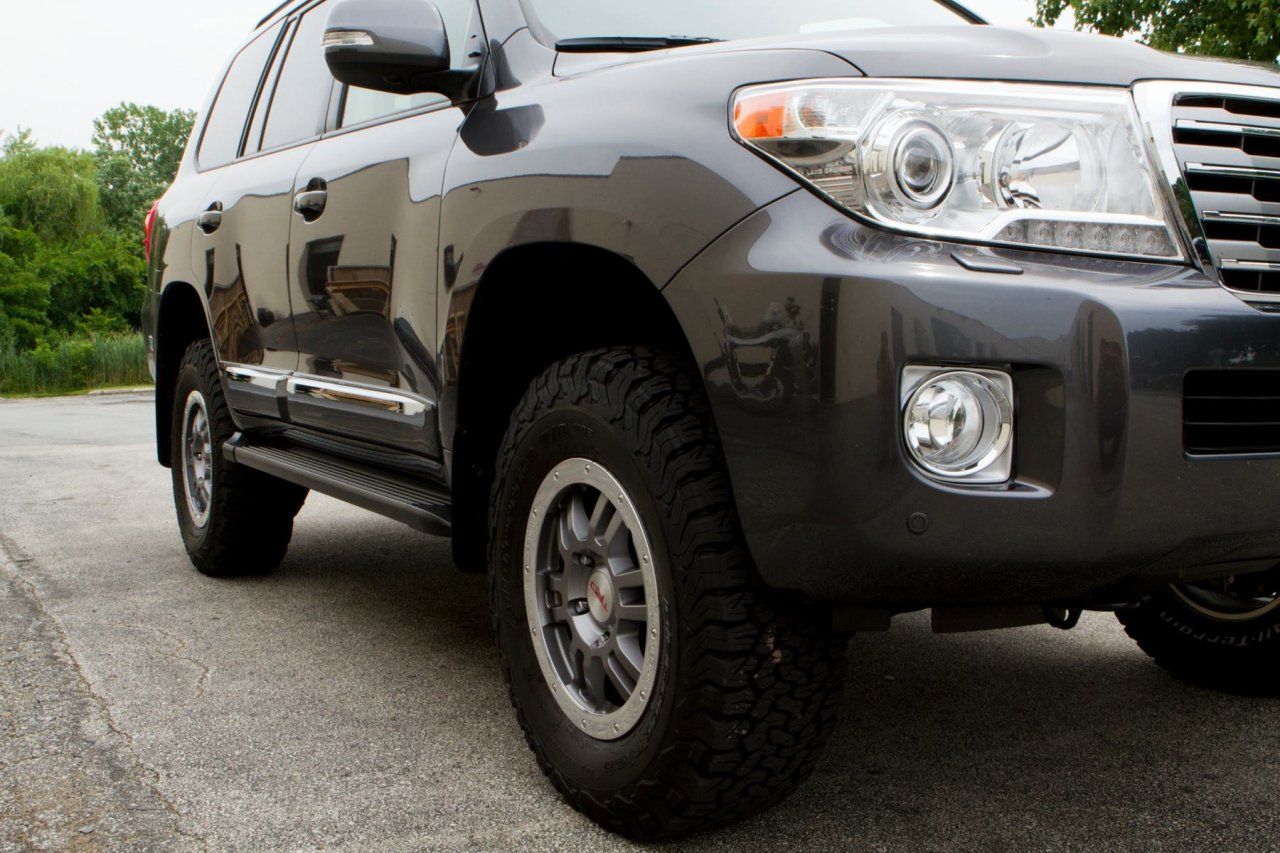

Can you tell us what size ko2's are pictured on your cruiser?

They are 285 KO2'S..

Thanks for responding re tire size. I asked what size KO2's because I plan to add your same suspension on an '08 200 I bought recently...but need new shoes BEFORE I can add the loft. So...the good news is I can fit those same 285/70r17 KO2's on rock warrior 17's even without lift...and will still be right with them post 51's.

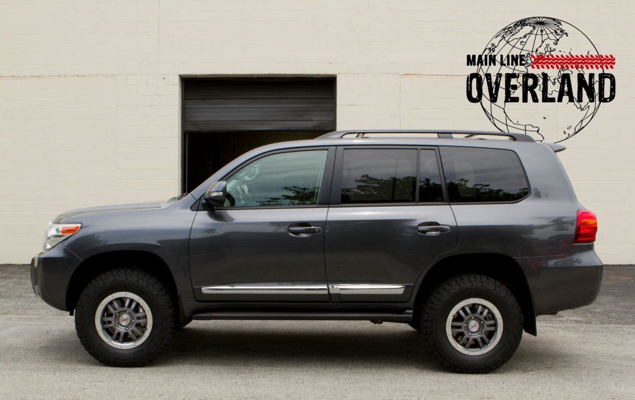

I did the tires and wheels before the lift as well. It fit with no issues until I had the lift installed. I did not install the lift. I had Main Line Overland do the install. Here is a link to the install News & Events. They did a excellent job and will be installing my ARB bumper shortly. I went with the medium springs in the front and rear.. I have a custom drawer, frig and gear in the back and the medium springs ride amazing.. I am glad I did not go with the heavy springs for my application..
You are going to love the BP51 suspension.. The ability to taylor it to your load and the terrain is just amazing. It is a pleasure to drive..
