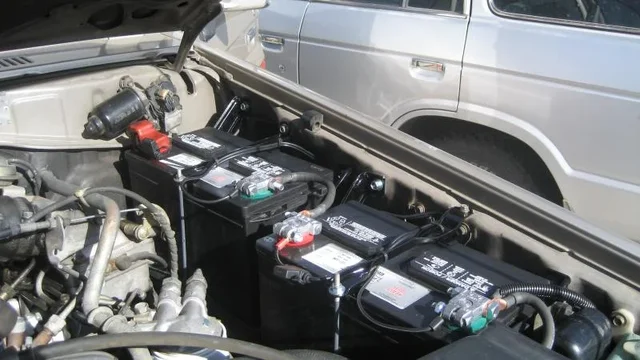

Well went to take the cruiser out the other day, and with a turn of the key nothing! Battery replacement was on my list of stuff to do... the batteries in it were mismatched, different age, and the low side was puking all over the inner fender!
I went with the Interstate commercial workaholics group 27 - the plates in the batteries are glued on both the top and bottom of the case, making it heavy duty. 675 CCA should be plenty for the moderate southwest climate. Thy also have a fairly decent reserve capacity.
Along with new batteries, military style terminals and 2G welding cable for the neg and jumper cables were used.

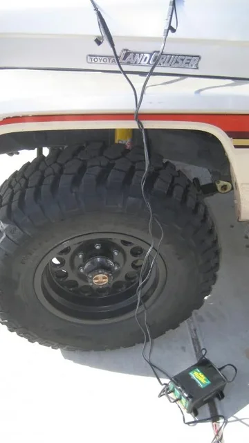

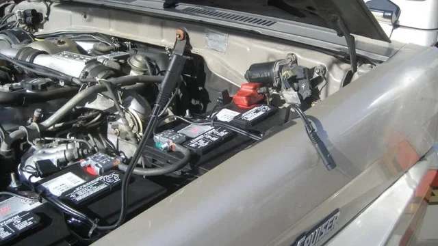

Because this is a weekend rig, I wanted a way to keep the batteries in top shape. I used a Battery Tender International 2 bank charger to keep them topped off.
The pig tails get tucked out of the way when not in use.
Here every thing is connected and charging. The cables are long enough to put the charger in the cab to keep it protected. Because the charger has two banks it treats the system as two 12V batteries even though its wired series.
The charger uses 6 volts to maintain the batteries, its not going to jump start it but will keep maintained.

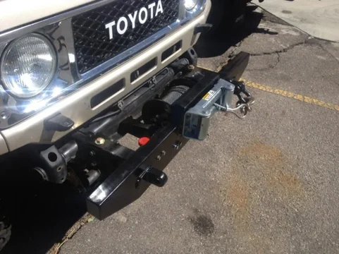

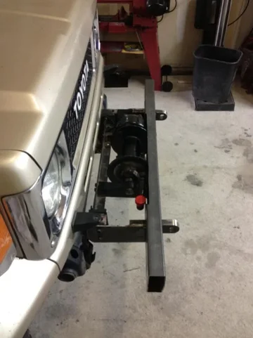

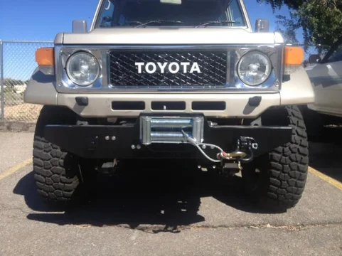

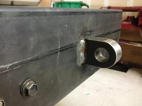

Zombie update...back from the dead! Bumper build. Simple 2x6 tubing with 1/4" plate making the connections. 1"x 2" Clevis mounts go all the way thru. Planning on a small hoop for lights, maybe a high lift mount,and some more protection for the PTO
