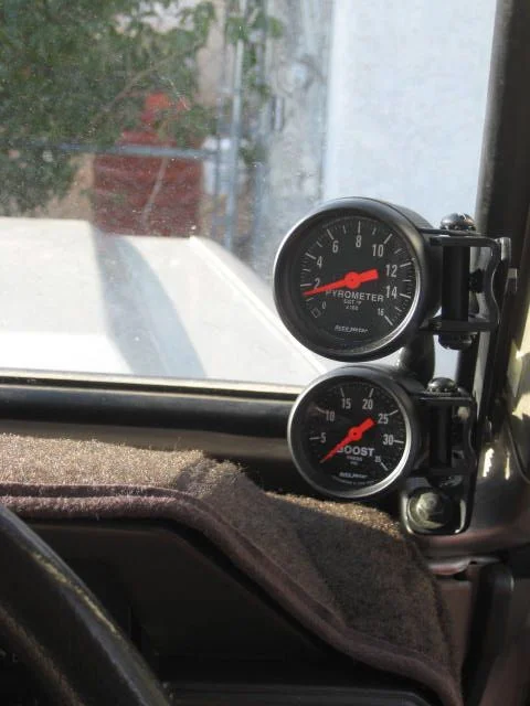

  • Autometer Pyrometer and boost gauge mounted to a custom bracket connected to the windshield frame bolt. Gives it the "A" piller look! It actually looks pretty clean! The Pyro probe is not quite mounted, should be done this Friday. The PO had a manual boost controller installed, but no boost gauge, i removed it to get some stock numbers. It will most likely go back on here soon.

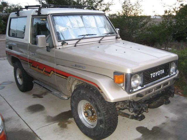

As promised... more pics!!!!!

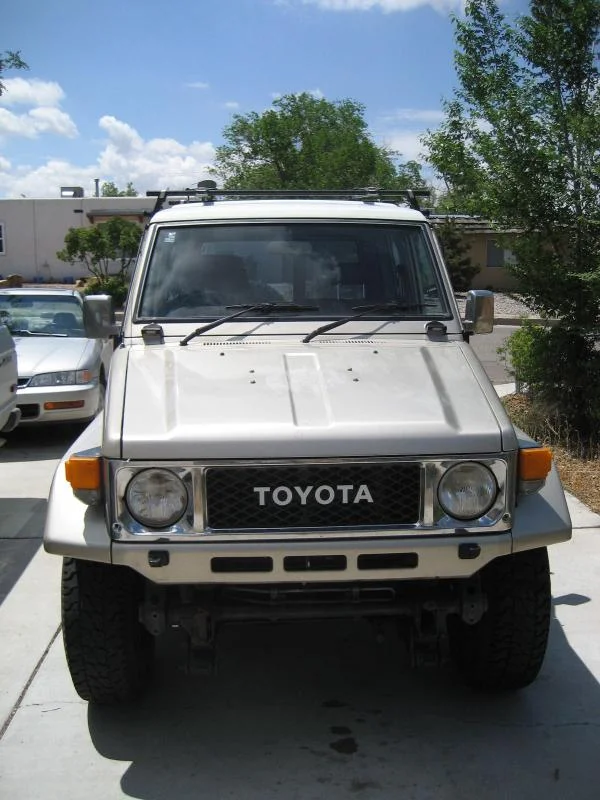

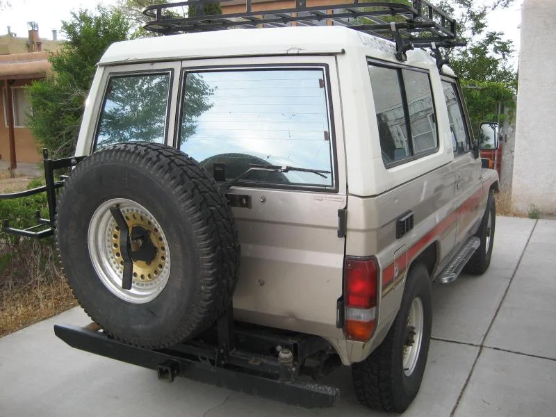

Delivery day - front and rear driveway shots.

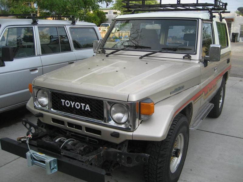

PTO winch, front & rear bumpers, and roof rack removed, planning stages for bumper. I am going to try and keep the PTO, but still have an appropriate front end.

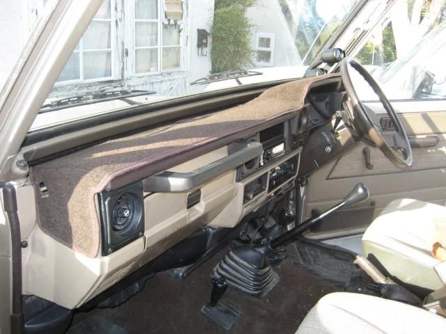

Slowly but surely... I was able to get some time this weekend to wrap up a few projects. Finished the gauge install and the dash cover was made (NM sun is brutal).
Pics of the gauges installed and the dash cover. I did the pattern then took it to the dash saver factory outlet. It turned out nice! Gauges are Auto Meter brand Z-Series 12v hooked up to the 24v=12v reducer. Replaced the bulbs with 24v bulbs and wired it to the cruisers lights.

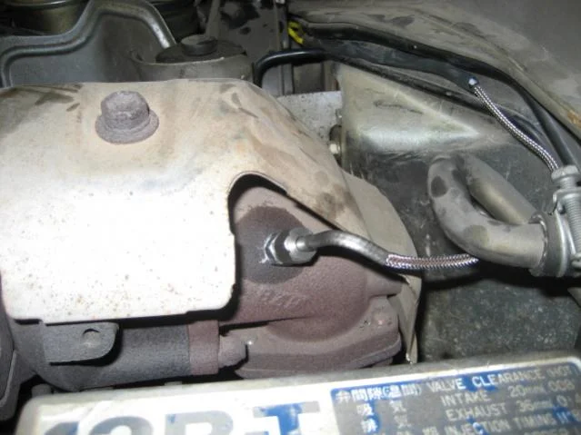

Pyrometer probe install - decided for post turbo. Several reasons: ease of installation, I'm not tuning it to maximum levels, and IMO i feel the numbers are all relative... have to realize what you have and what you seeing, as numbers go.

Hi Jericho,
I have the same set up as you almost. I have the pyro probe in the same location:

Im liking how your dash mat goes to the edge then folds down the side

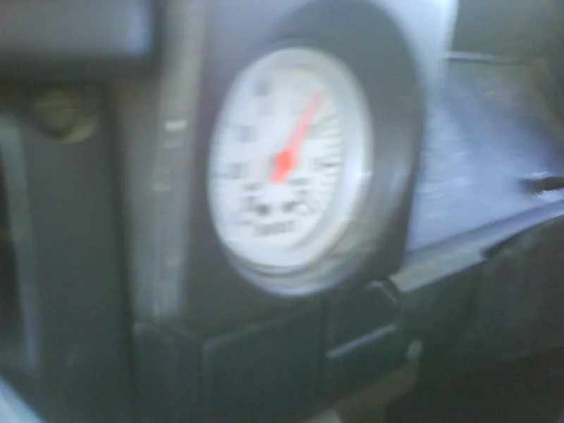

This pic is just another idea for your boost gauge its not very clear but you get the idea its in a turbo rhd 75 troopy

Im getting slightly higher numbers, maybe 50-100 more. Boost is at stock 8psi. I have a boost controller that I took off to get some stock numbers, exhaust at the end of the week, then the boost controler goes back on. Im using the same max limits, but try to stay closer to 950.
Thats a nice spot, what size guage?
love the dash carpet!@
Thank you! It turned out well, the dash shop owner was skeptical at first, I guess he gets some doozies of patterns.

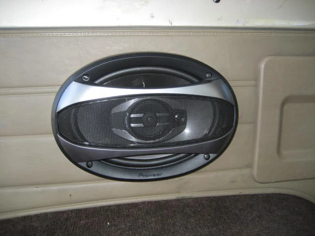

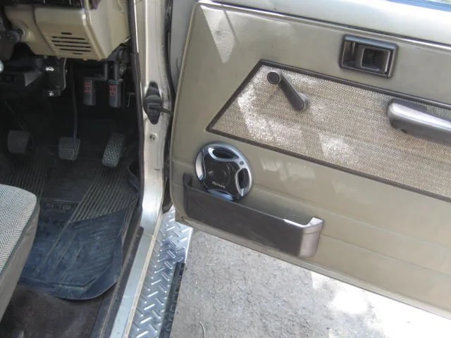

Several more things checked off the list! Stereo has been installed for some time , needed to finish up the speaker install: two 6x9's in the rear and two 5 1/4's in the door. Sounds nice, rear speakers were a snap to install - the fronts weren't bad...just needed some careful measuring. Factory tool box in the back was removed for the left rear, not sure what I'm going to do with it.
Door speaker pic
Rear speaker

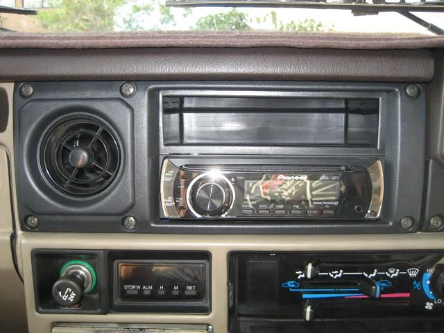

Stereo install with pocket. Like so many stereo trims, it was broken, i found a new replacement online from Toyota Parts - ToyotaPartsCenter.net. I plugged the part number in and they had it in stock! I've been using the EPC and that site to check on available parts, its been working out fairly well. 12v power from a 15A reducer mounted on top of the glove box. The cig lighter was converted to 12v ,and the old 24v key on power is now switching on the relay.

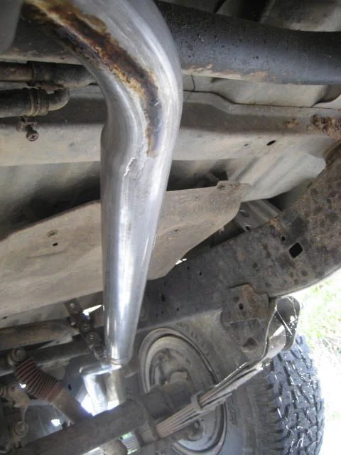

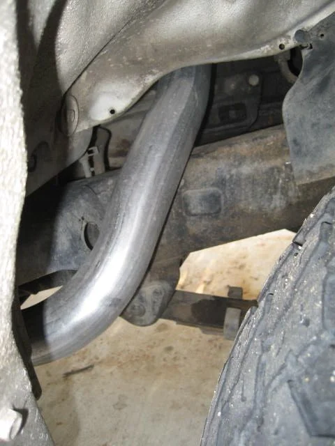

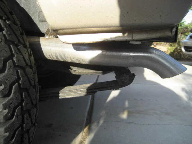

Another big item to check off... the exhaust. WOW! Awesome mod. I went 2 1/2 from the turbo following the factory route, minus the muffler. EGT's are approx. 100-150 degrees lower, but the biggest thing that i have noticed is the recovery time. The stock exhaust took a while to cool down, the new stuff drops the temps fairly quickly. Sounds real good, and its a quick way to drop a 100lbs. That stock double walled tubing is heavy! Pics to follow.
Another clock with 5 buttons makes me very jealous :D looking good mate i see no mufflers on that exhaust that make me very happy the turbo must whistle like a old man on a rocking chair
