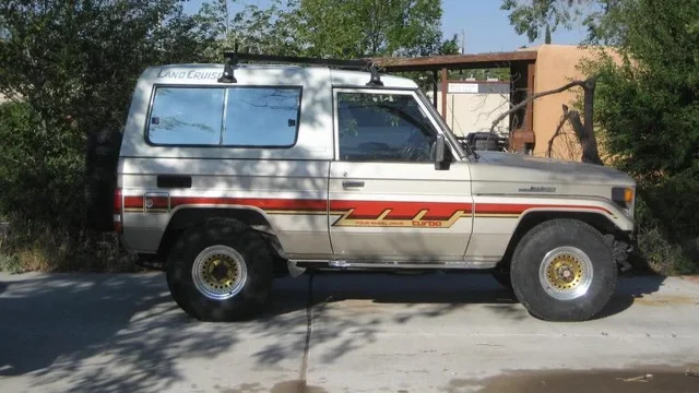

35's now on my 74
Jericho, thanks for the info!
I just deleted old PM's if you want to resend?I love the 35's on mine! My truck has 104,000km's on it:60,000 miles or so, runs like new, but with 35's where I would shift before @ 2800 rpm's, now I go a bit higher to prevent lugging the motor, which it has not done yet this way. I don't really plan to haul much(trailer) so will leave boost alone for now. I am doing the shackle reversal and move axle 1" to 1.5" next week(moving into new shop this week-Proffitt's) and add snorkel. The 35's fit well, but at full turn backing up I rubbed a little on back part where mud flap is, so hoping the added lift and space with relocating axle totally resolves any issues. The rear are fine, and do not plan to do anything there yet, until wheelin' and see if rubbing occurs @ top of inner wheel-well area. I bought Dick Cepek DC-1's from 4-wheel parts in Denver, and got buy 3 get 1 free on 5 tires: mounted, shipped free. The backspace is 3.5 and fits perfectly.

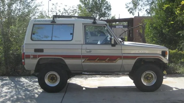

Before
After
OME installed!
Went with the CS006F and the CS004RA/B. I was not sure if I wanted that much weight carrying ability on the rear so I removed the leaf. I also wanted to move the axle forward - didn't get a chance to do it yet. Its on the list, but ran out of time and didn't have a drill bit large enough.

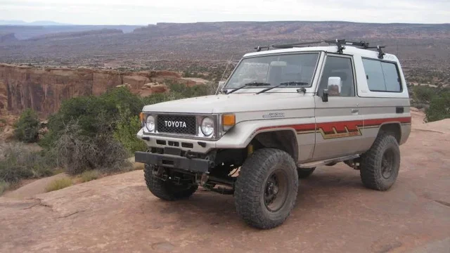

Poser shot form Moab! GREAT TIMES!
Tires 285/75 16s BFG KM2's on Eagle Alloy 16x8. Have some rubbing in the back that I need to sort out, other then that the Cruiser ran great!
