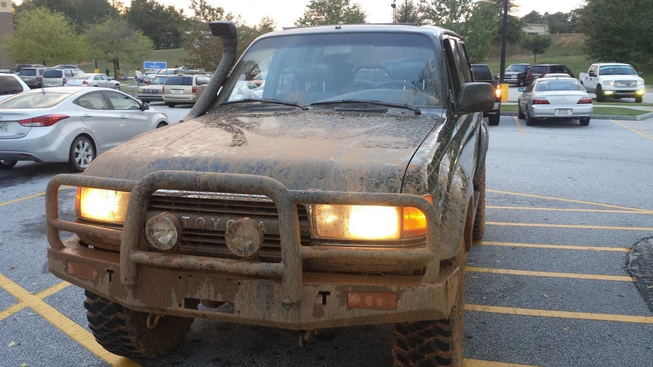

This is the most frontal shot of my TJM. This top half, with a better clearance bottom half would be allsome. One thing I dislike on mine is the lack of recovery points. But I do like the Hi Lift points.
Just some features to consider.
