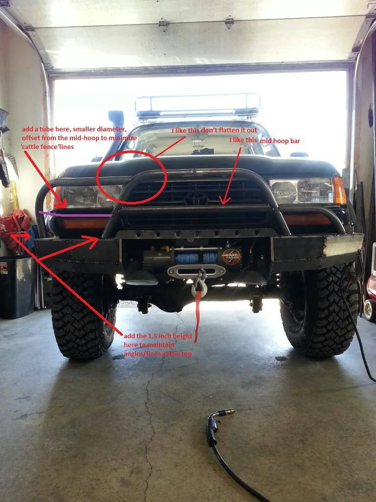

ARCHIVE New EXPO Modular Front Bumper Design
Looks good, dude! x2 on some sort of winch cover, don't know what that could be, as its a pretty open style in the front right now...
The only problem I see with the cover is this. If your running line out and the tension-er decides its gonna not function properly and you get a birds nest of cable. Your winch is completely covered up and you forgot to bring tools with you on this quick little excursion. Then what? No way to remove the cover(s), no way to untangle you cable, stuck and cant recover your vehicle... Honestly if you want a cover for your winch they make em.
http://www.amazon.com/Warn-91414-Ne...=1415711182&sr=8-1&keywords=warn+winch+covers
I'll do whatever you guys want for the most part but you have to look at it from all angles and scenarios.
I agree, I like having top access with the ARB bumper...I like where this expo bumper is headed though underdawg.
If theft is a real concern...seriously people will steal a winch with torqued down bolts and little to no access??? then get some of those 55 bolts or spot weld the nuts or whatever.
"then get some of those 55 bolts or spot weld the nuts or whatever."
You aren't getting anywhere near my nuts with a spot welder. Just sayin' :)
You are correct it needed to come up an 1.5" no big deal
Are you bringing the whole bar up that 1.5" or just the wing?
I like the geometry/lines across the top where the wing doesn't line up exactly at the top of the center hoop.
Also, any chance for a bar across the wing when you start on mine? (I'm after @Qball right?) Maybe just below the bar running across the middle of the hoop? (Which is a great addition btw!)

I am very much liking the lines you are creating. I agree with all the suggestions that @JasHook made above.
I also think that you don't need to be tied to the modular concept, you could also offer a single piece expo bar that has a solid face to cover the winch. This should simplify the build process and you could build it as strong as you like (easier to make strong than a bolt on cover, which you pointed out earlier). It also gives folks that don't need the modular design another option.
I have a new ARB, but if you had a single piece front expo where the winch is covered, I would be very interested.
Can't wait to see my rack with the couple of customization's.
