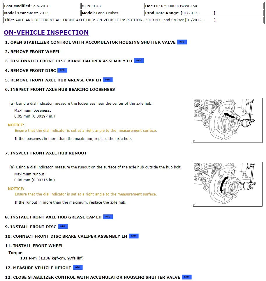

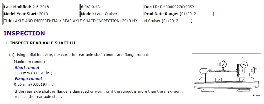

If you're getting a lot of noise and you're sure it's not the tires, then bearing are a reasonable next guess. If you know someone who has a Tundra/Sequoia you could see if they'd let you swap wheels/tires for a bit just to drive around and see if the noise changes.
IMO if you think it's bearings, just go through the procedure to check for play. Or if you don't have the tools any dealer should be able to do it.
Fair enough.
I haven’t set up dial indicators yet but have had all 4 wheels in the air with no discernible play at any corner. I do think whatever is going on is pretty early in the failure process.. so maybe with some time it’ll become more apparent.
I do have a friend with an LX that I could wrap tires with, thanks for the idea.
