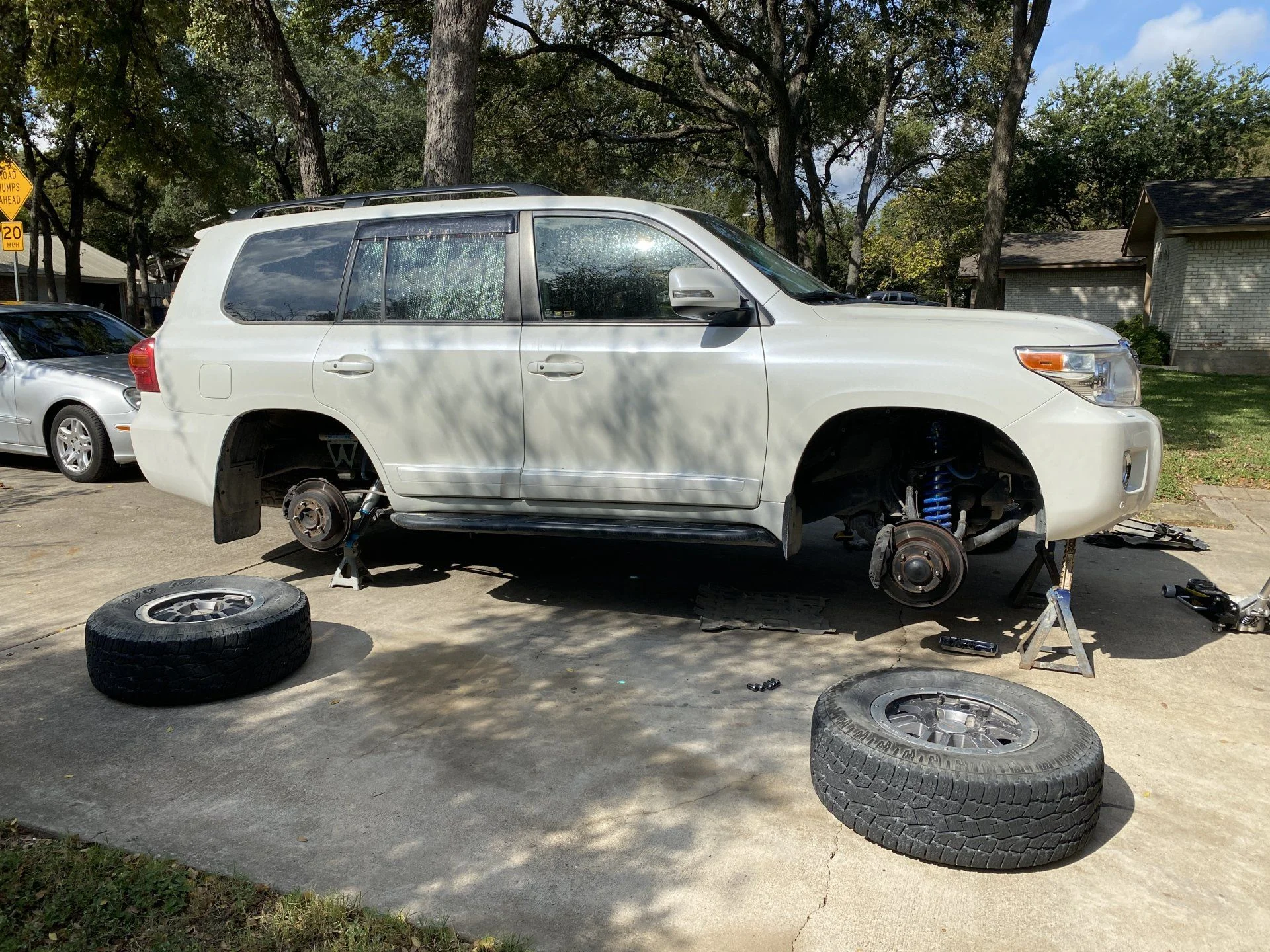

Thanks @TeCKis300 @cruiseroutfit @rlynch356 @dubaicruiser @Markuson nad @linuxgod for the suggestions. The following was about half of my day:
Pinion angle was within .2 degree of the TC output flange, and rear u-joints felt great on manipulation, so I don't think rear driveline is the issue. I didn't remove the front, but nothing should have changed with the lift so I'm betting that's not it.
As pictured I had the truck on jack stands then engaged the CDL, and put it in drive. Turns out the rear brakes were dragging and only one side spinning, so I had to remove those rotors. With a mechanic's stethoscope, there are no obvious bearing issues. Fronts were completely silent.. it was eerie. Rears were a nice hiss, just like I'm used to. Same for both bearings on the rear diff, front diff even quieter, output bearings silent too. So, I feel confident it isn't a bearing issue.
Tire wear is all very even, no cupping or abnormal wear to speak of. The shop didn't give me a printout but the tech seemed to know what he was doing (22yrs experience at that one "alignment only" shop.. rare) and said everything was in the green, and he didn't even need to max out any of my adjusters.
So at this point I'm back to @TeCKis300 theory that it is the spherical bearings sending more NVH through the suspension into the cab. Might even be made worse by my relatively quiet P-metric tires. Obviously I'll be paying close attention to whether the noise seems to get more prevalent, but for now I'm not worrying about anything at least.

Side note: apparently the extra suspension travel offered by the kings allows the front KDSS arm to lightly hit the body mount on that side under the core support, and the rear KDSS arm to kiss a bracket on the frame, tearing it's boot. I'll be putting this thing on an improvised ramp soon to see how bad these interference issues are.
I'd be interested in this as well. Ive had my setup flexed to its limit and haven't seen the issue you're dealing with WRT the KDSS. I have seen the drivers side KDSS LCA link angle being overly stressed in the forward direction when fully extended down, but other than that no issues.
I had the front end on jack stands with suspension totally dropped out as in the picture above and the bolt on the front end of the KDSS arm was definitely hitting the bolt under the core support.. though of course I didn't snap a picture. And yes I did see that on the link.
I'm not sure when the rear would have hit other than in Colorado a few weeks ago, but the tears/marks are there and the mark on the frame bracket is fresh... Hence my plan to put it on a ramp. And post about it.
