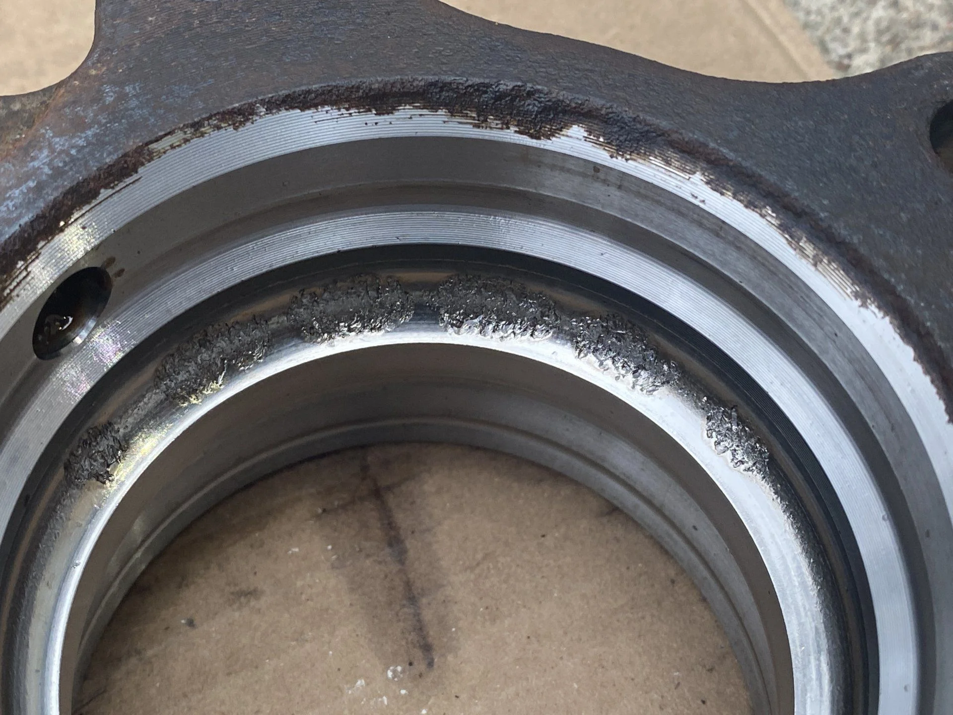

Turns out each bearing assembly has two opposing ball-bearing races that are each self contained with their own seals and grease pockets. The inner race was bad on mine, the outer was basically perfect.
I now remember what tire noise sounds like!!

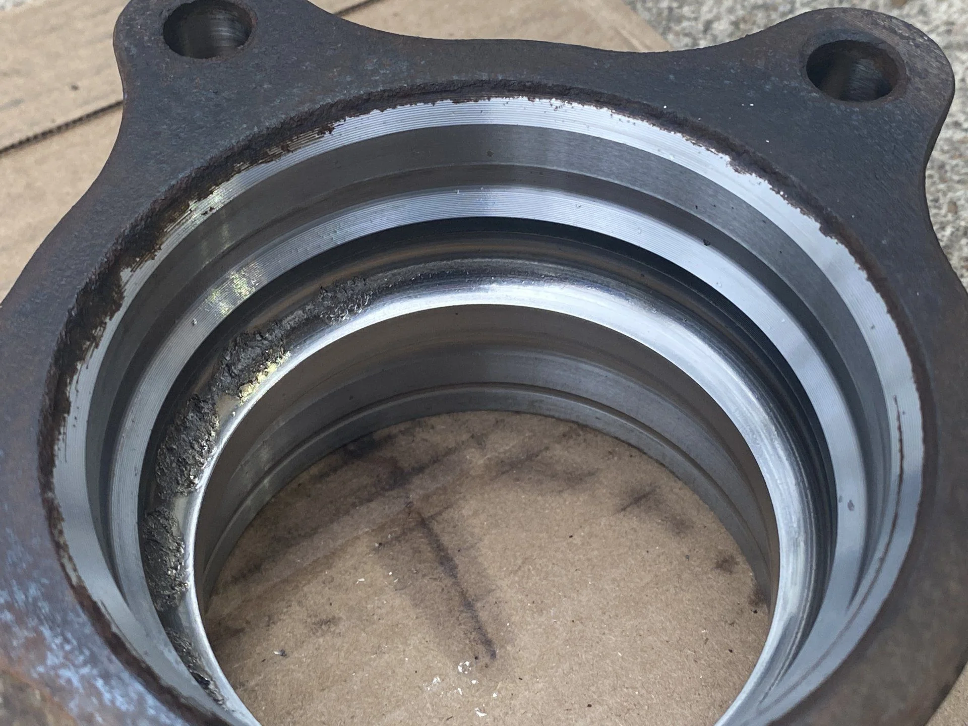

All of the damage was at the top of the race, which is the portion that sees the weight of the vehicle. There technically being four bearing races in back, the top of this race sees roughly one quarter of the weight over the rear axle. Sides and bottom of the race were in good shape, considering what was rolling around in there.

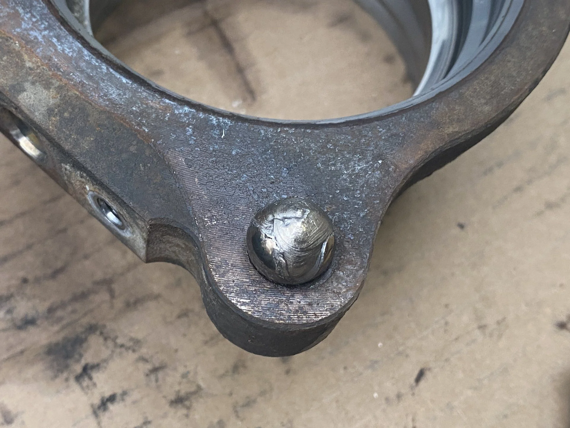

Oddly only one of the ball bearings was bad. The rest were in great shape, only showing what seemed to be incidental damage from the swarf coming off the ugly one.
And here's a close-up of the bad side of it.
More pictures. I plan to post a thread dedicated just to this failure for easier to find info for people, and another one for the process to change the bearing. The axle comes out surprisingly quick, but getting the bearing off the axle and new one pressed on requires a fair amount of special tools and some luck with press accessories.
Some of the swarf collected from the bottom of the gasoline bucket I used to clean the grease off everything
On this one you can see the clear difference from top to side/bottom of the race

Great work getting to the bottom of this. That ball is fragged. I wonder if there was a hard shock load that hit that bearing particularly hard?
I'm not a material engineer, but the wear on that single ball makes me think there was something wrong with whatever alloy was used or some other imperfection. I suppose shock loading could crack off some of the bearing but given only one was destroyed, even with all the metal floating around in there, it seems like @bloc was unlucky enough to get the one ball in 10,000 that had a flaw.
Honestly given all the shrapnel in there, I'm impressed how well all the other balls in that bearing held up
Roller bearings like this are designed specifically to distribute any loads to multiple ball bearings though.. I’m more inclined to believe either that one simply wasn’t as strong as the rest, or there was some kind of contamination issue. I’ll get some pictures of how different the balls from the other race look. It is curious.
