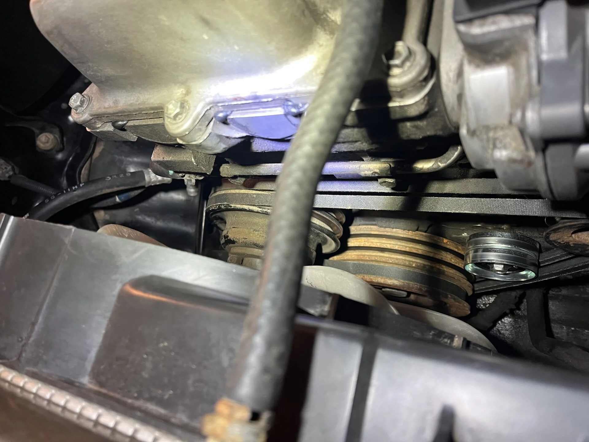

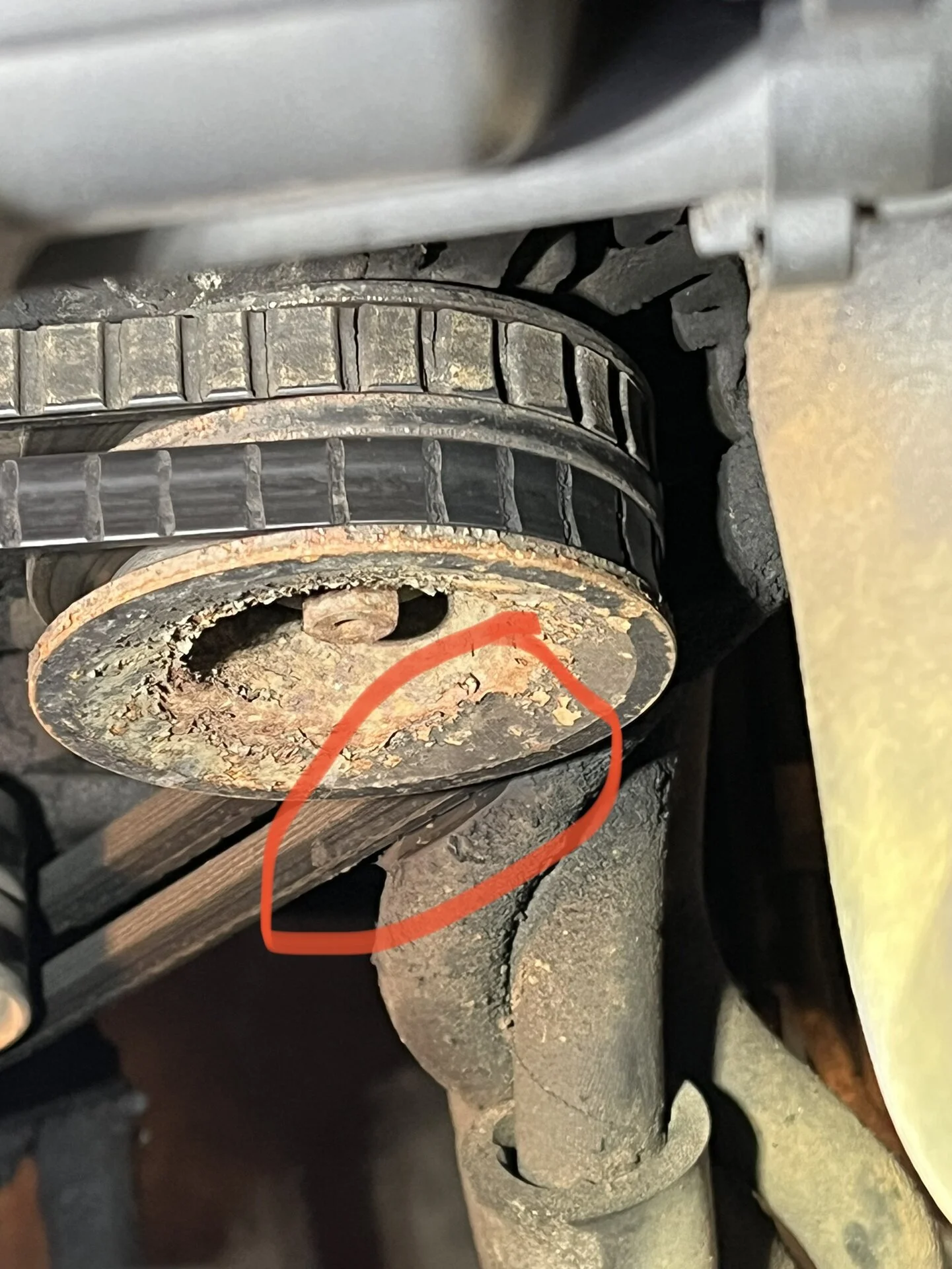

First off my 96 FZJ80 started making a random noise coming from belts(scraping noise) about a month after buying. I decided to change belts and both idler pulleys all in one swoop to see if that took care of it, thinking it was a bearing. Right before changing belts I noticed what appeared to be the power steering hose coming from the power steering reservoir hitting the alternator belt closest to fan(causing the scraping noise I had heard). Long story short I decided to change belts and pulleys anyway as I don’t know last time they were changed and already had the parts(all OEM).
I will post a pic of what I believe to be the power steering hose sitting against the alternator belt which I have since pulled away from it.

What belts did you install? Some pics of your handy work will help us point out any issues. I'd be checking all the rotating bits at the front given what looks like minimal maintenance by the previous owner.
Cogged belts (like in your picture) are well known to make noise - use toyota oem belts and you buy them as a 'matched' pair.

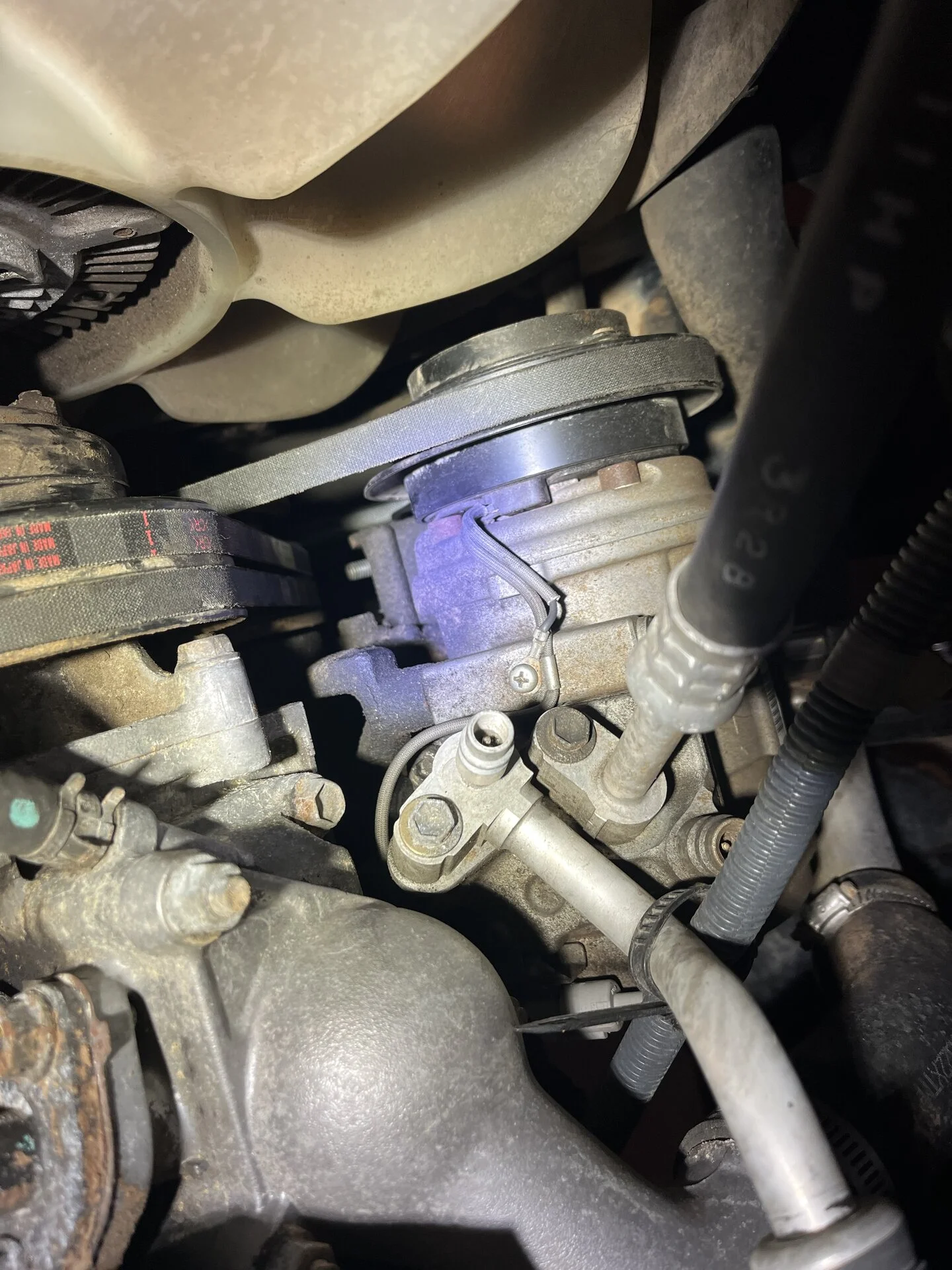

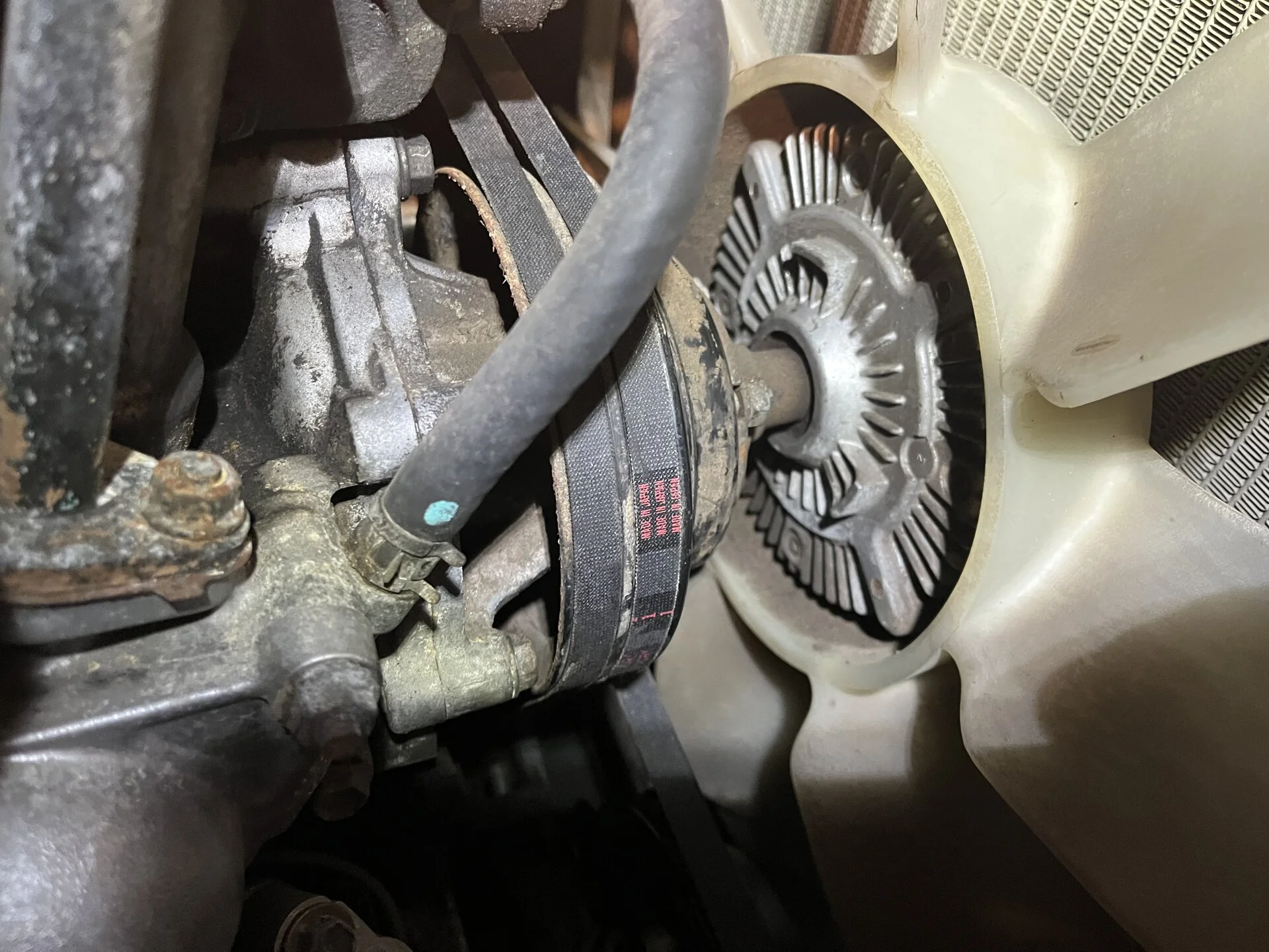

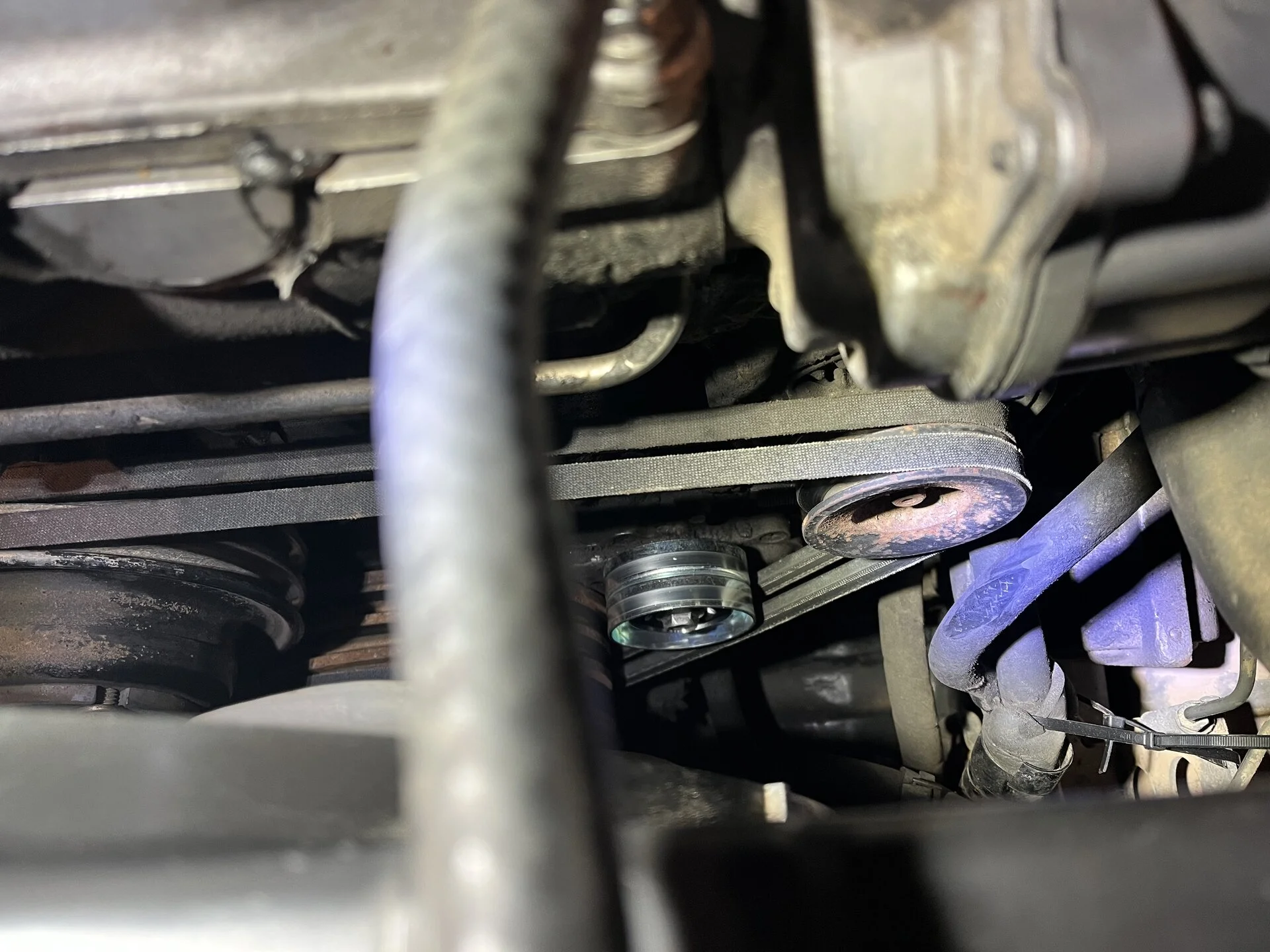

Just getting back under the hood today, here’s some pics of the belts in case anyone can see anything out of place. Also the noise is happening just barely revving it up now.

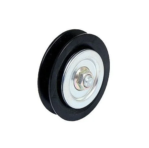

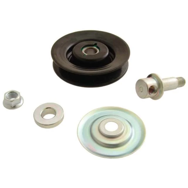

Did you replace the tensioner pulley for the A/C belt also?
IF so....the dust cover on the front of it needs to be oriented a certain direction or it can rub on the pulley.
