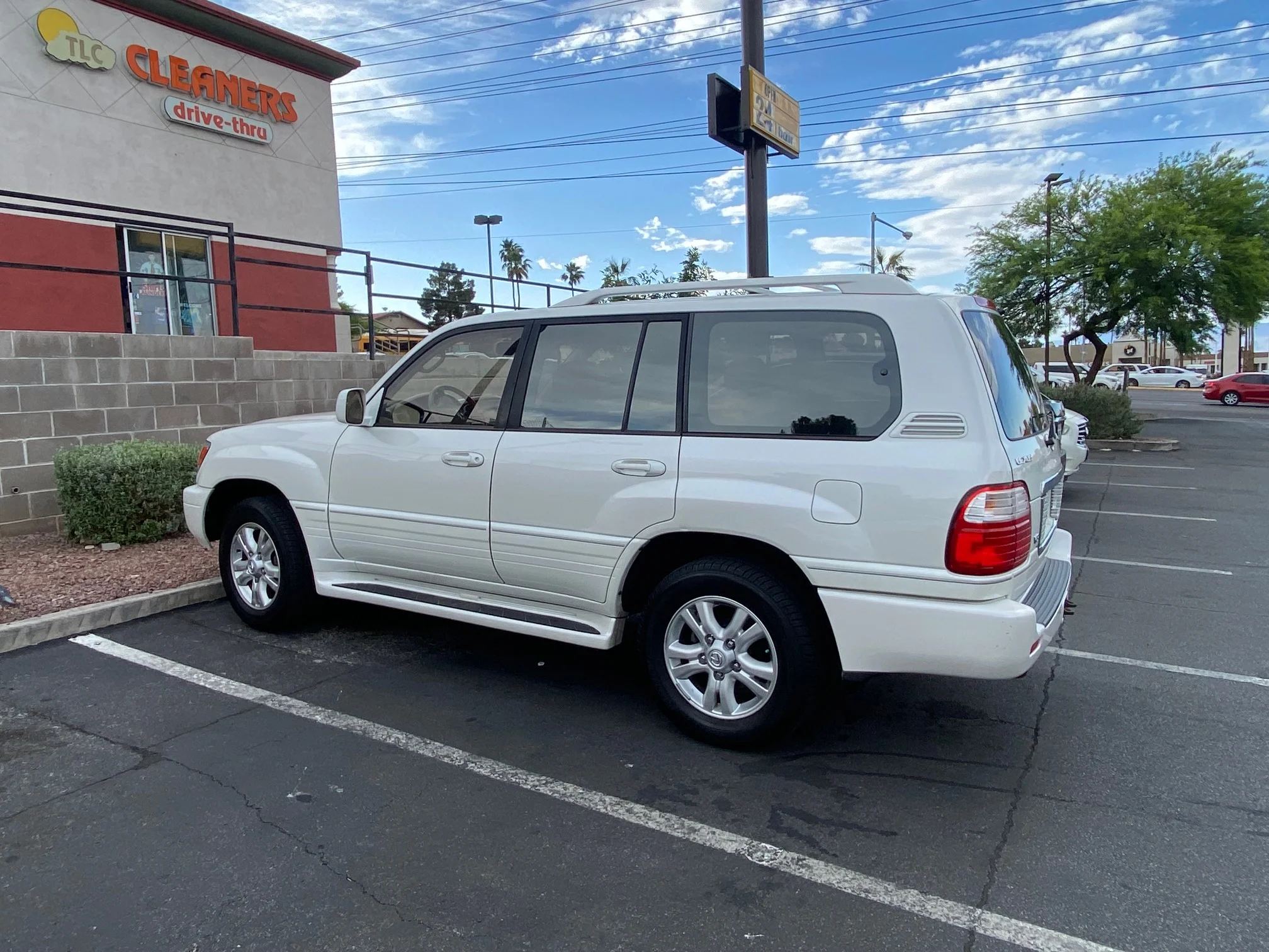

This is an AMAZING forum btw. Incredible how active and helpful this place is... I'm reading it constantly. Just picked up this beautiful one-owner 2003 LX470 in Las Vegas a few weeks ago. It currently has 107,500 miles and seemed to be very well maintained. Even though the used dealer did some prep work and it recently was serviced, I'm baselining all fluids because I'm OCD. Timing belt job done at 77K miles in 2017, so that job should be due by age next year.

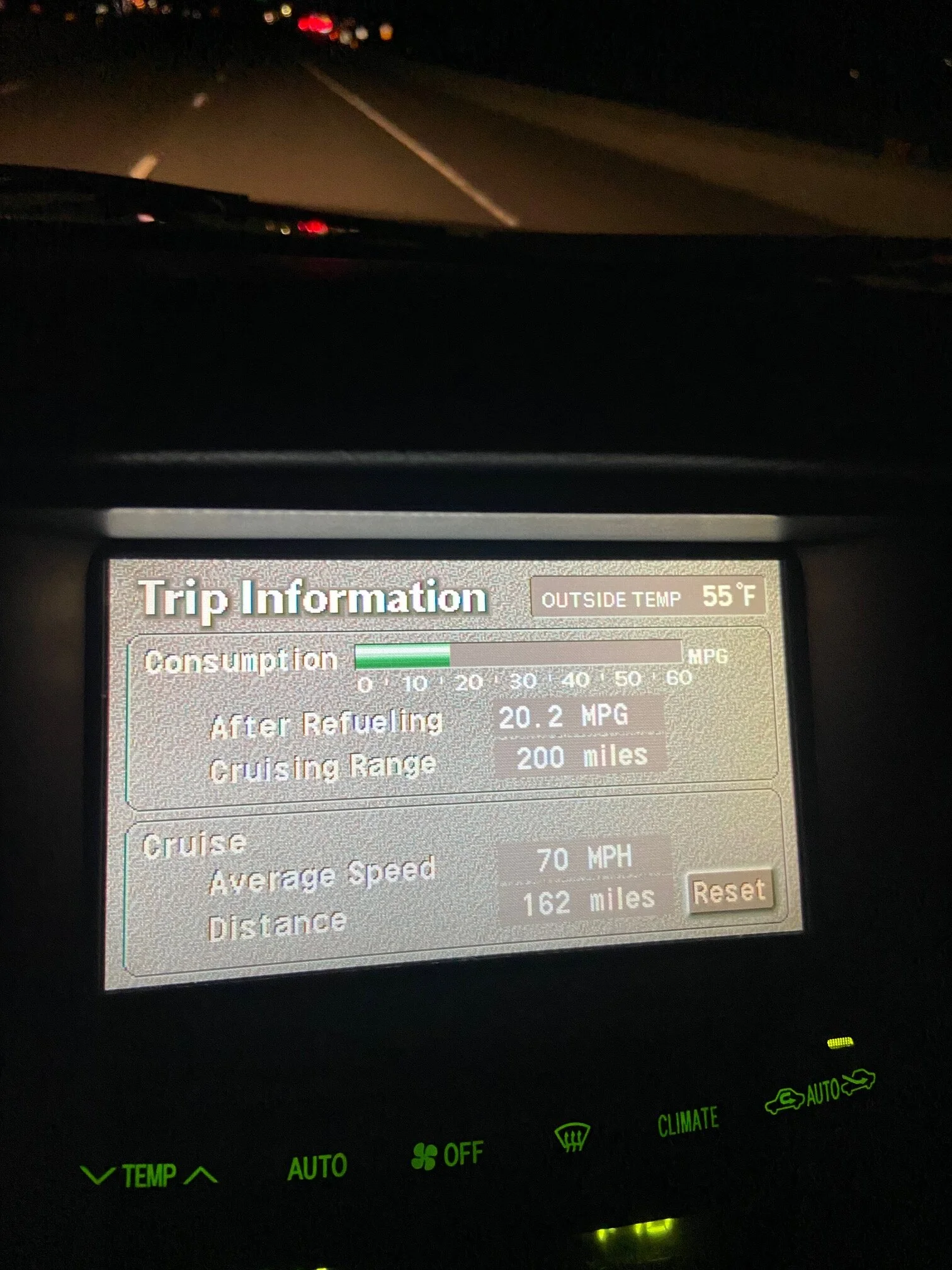

Anyway, look forward to becoming a part of this awesome community. Here are a few pics of the new baby. I was also able to average 20 MPG driving like gramma from Las vegas to UT going 70 (during the night, so roads were empty).

Also, 20mpg is wishful thinking. I’d cross reference that against some actual measurement. You’re more likely at 15-16.

1) Engine filter (base on 20.2 MPG read out).
Hey 2001LC, i'm checking out your awesome YT videos regarding wheel bearing change all your fantastic very in-depth posts. Thanks for all the fantastic info for DIY'ers. Regarding your comment about the "Engine Filter". Are you saying i should change out the Engine Air filter in the airbox? If so, it was just changed prior to my purchase and appears brand new. I'm doubtful its a OEM part, so maybe the airflow through it isn't correct. Did the MPG suggest i have some issues? Want to get it all sorted, so i really appreciate your help!
If new air filter, likely good enough air flow, even if aftermarkets.
Just seeing you got, 20.6 MPG, 162 miles with avg 70 MPH. Makes me think, air restriction. Even here in the mile high city (less oxygen), we don't see 20 MPG.
Could be non stock tires size. Or very conservatives driving, with lost of down hill.
I was driving very conservative. Slowing down a lot over hills and trying to baby it home. Was during the night so not much traffic. In the city I was getting around 15mpg. It’s bone stock.
