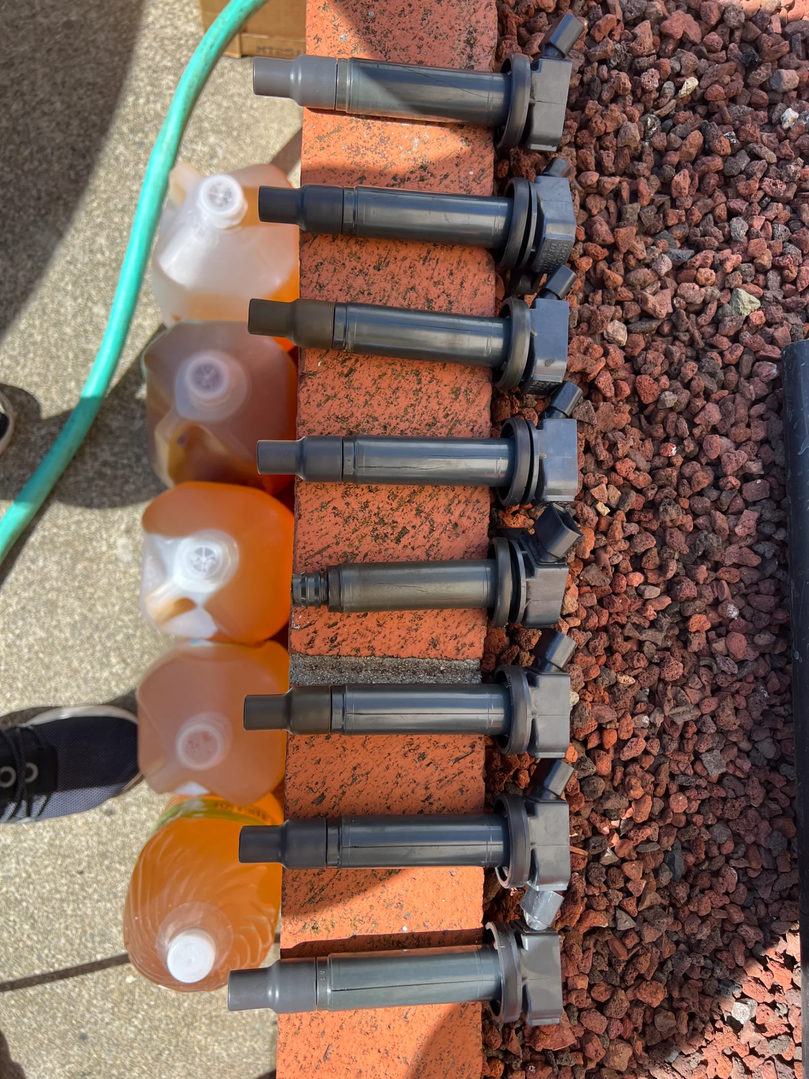

1- Spark plugs, all looked pretty old and worn out especially #8.
2- We were hoping to re-boot the coils come to find out that all of the coils had cracks, some boots were so crusty that they broke in my hand. Lexus dealer wanted $100 per coil, Toyota dealer wanted $150 per coil?!?! Neither one had them in stock. Luckily O'Reilly had a whole set of Import Direct brand in stock with lifetime guarantee for $199.00 total. They look better made than OEM, time will tell.

Here is what my coolant and coils looked like:

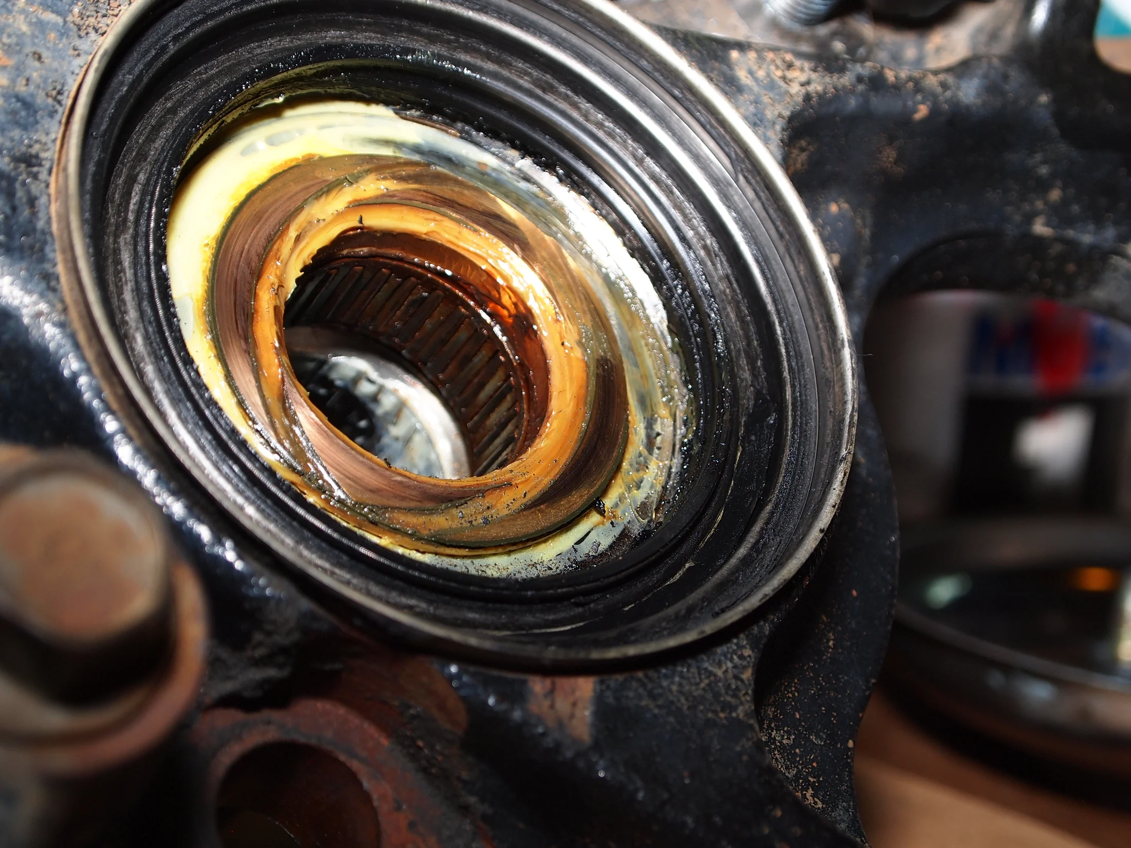

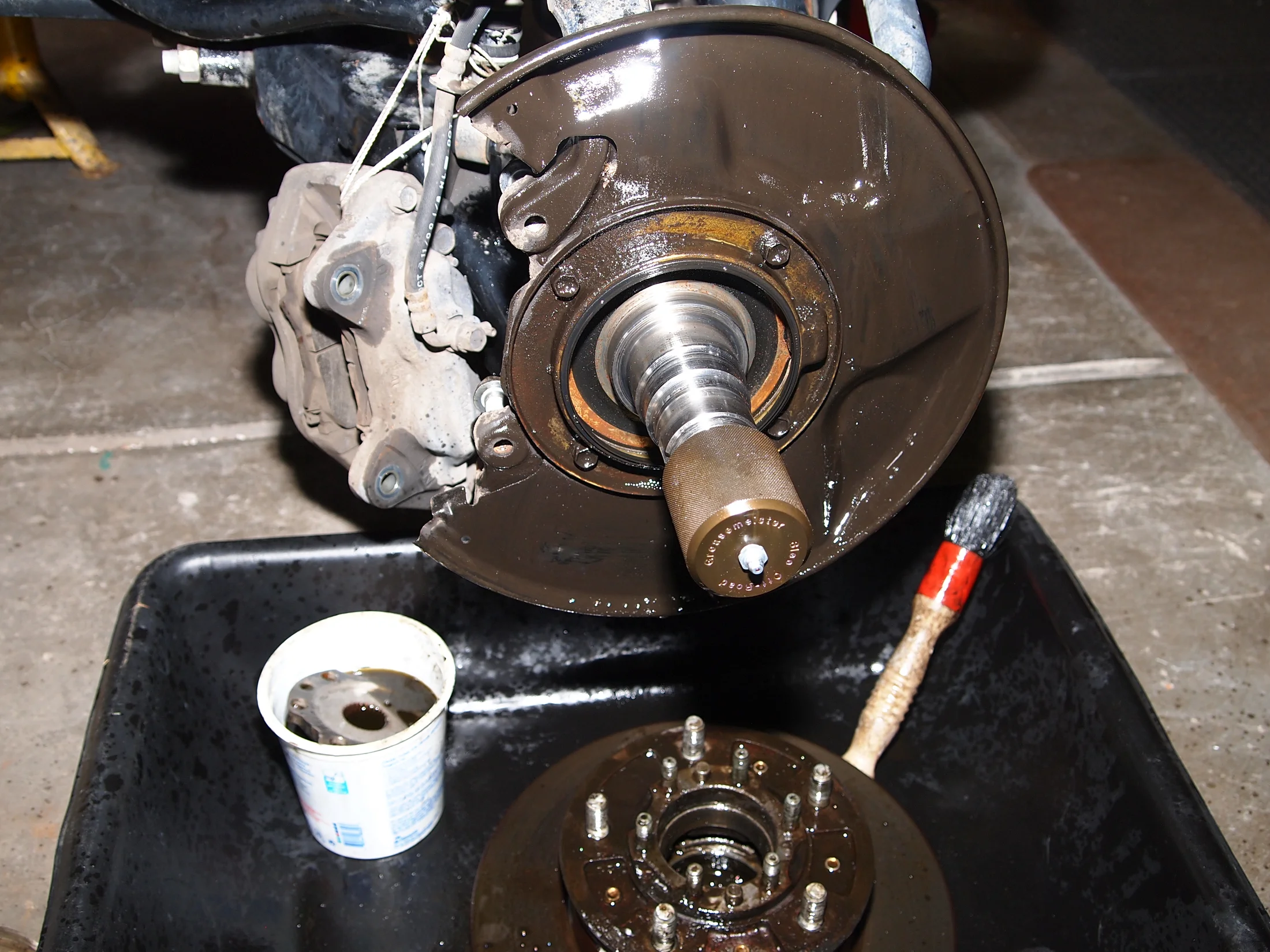

Almost every 100 series I look inspect, wheel bearings are loose. Make sure to check them.
It supper rare to every find a 100 series, that has had axle needle bearing and brass bushing lubed. Which is due each 30K miles, with wheel bearing service.
White grease is factory lube.

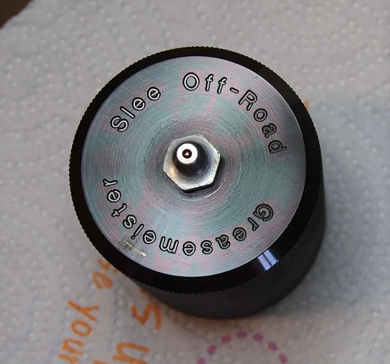

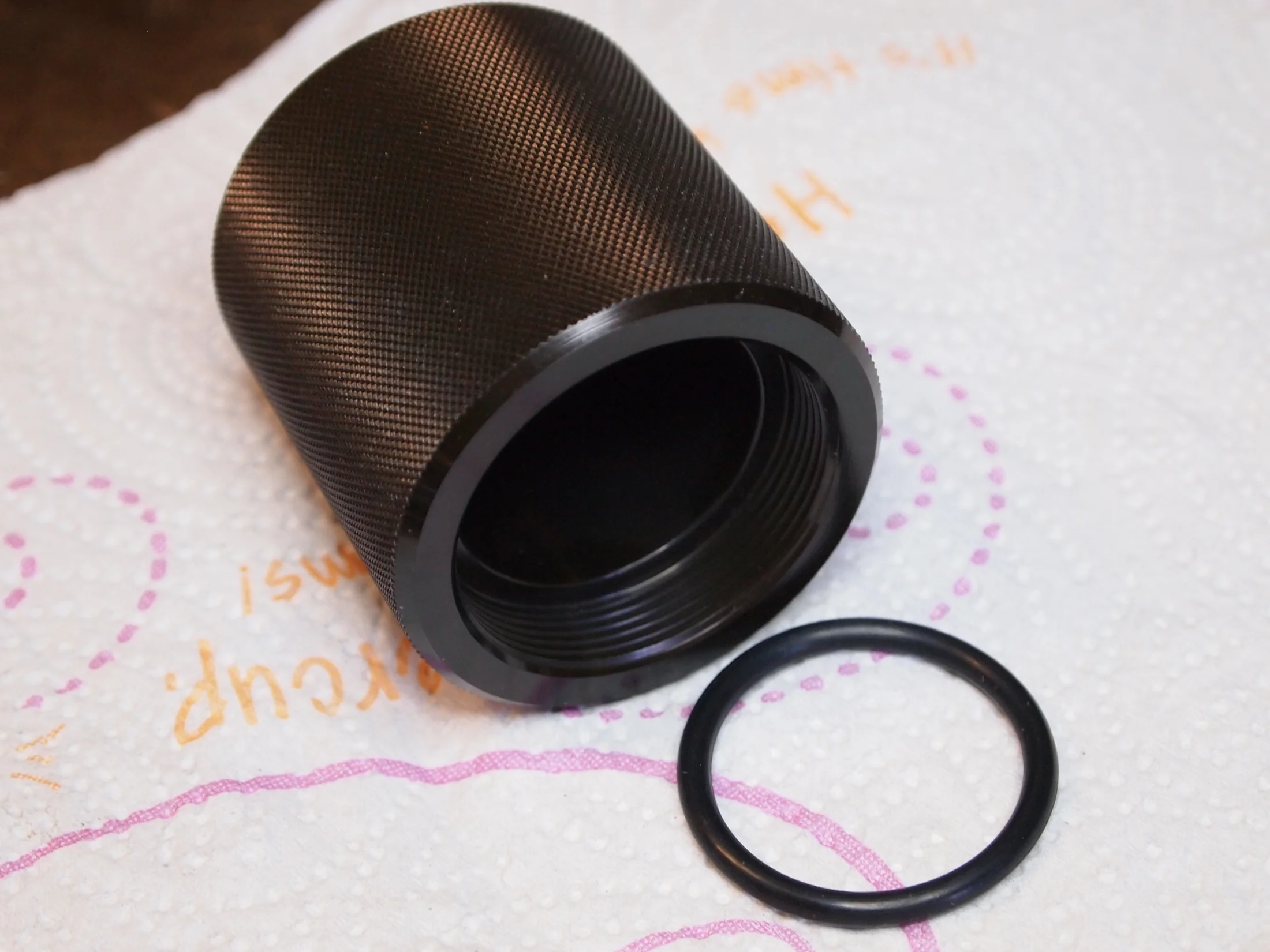

If not pulling knuckle, I use the Slee spindle lube tool

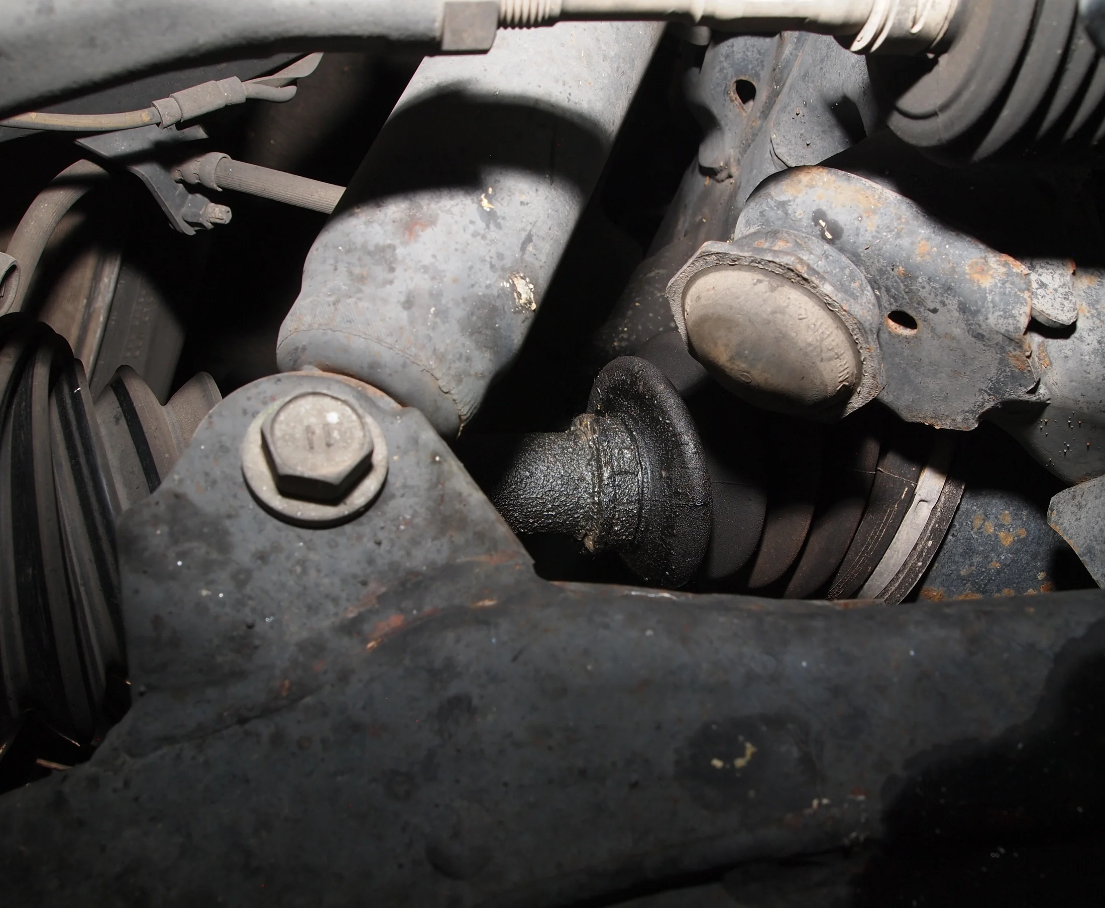

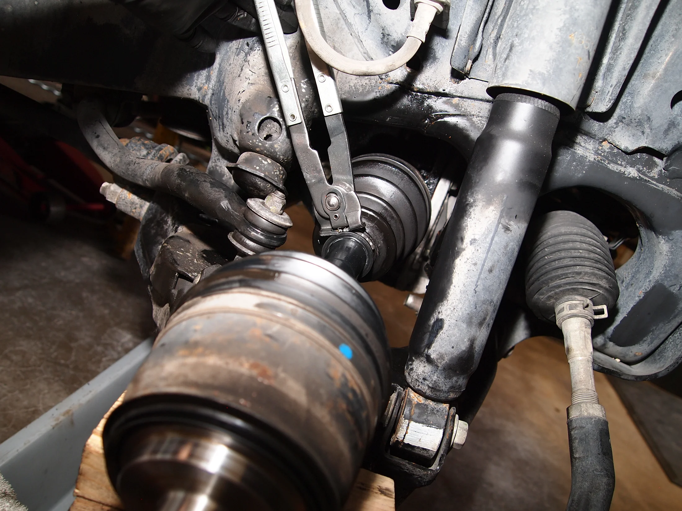

FDS (AKA CV) very often on the LX470. We'll find the inner CV boot weeping under small clamp. Replace the clamp with NAPA small CV crimp boot clamp.

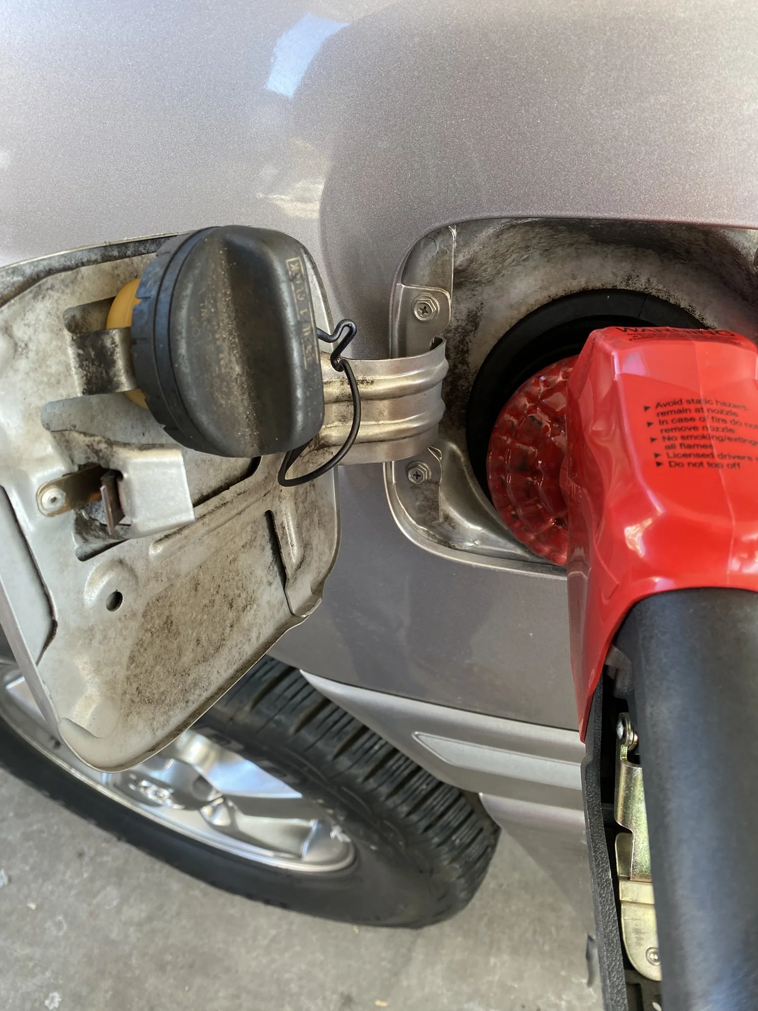

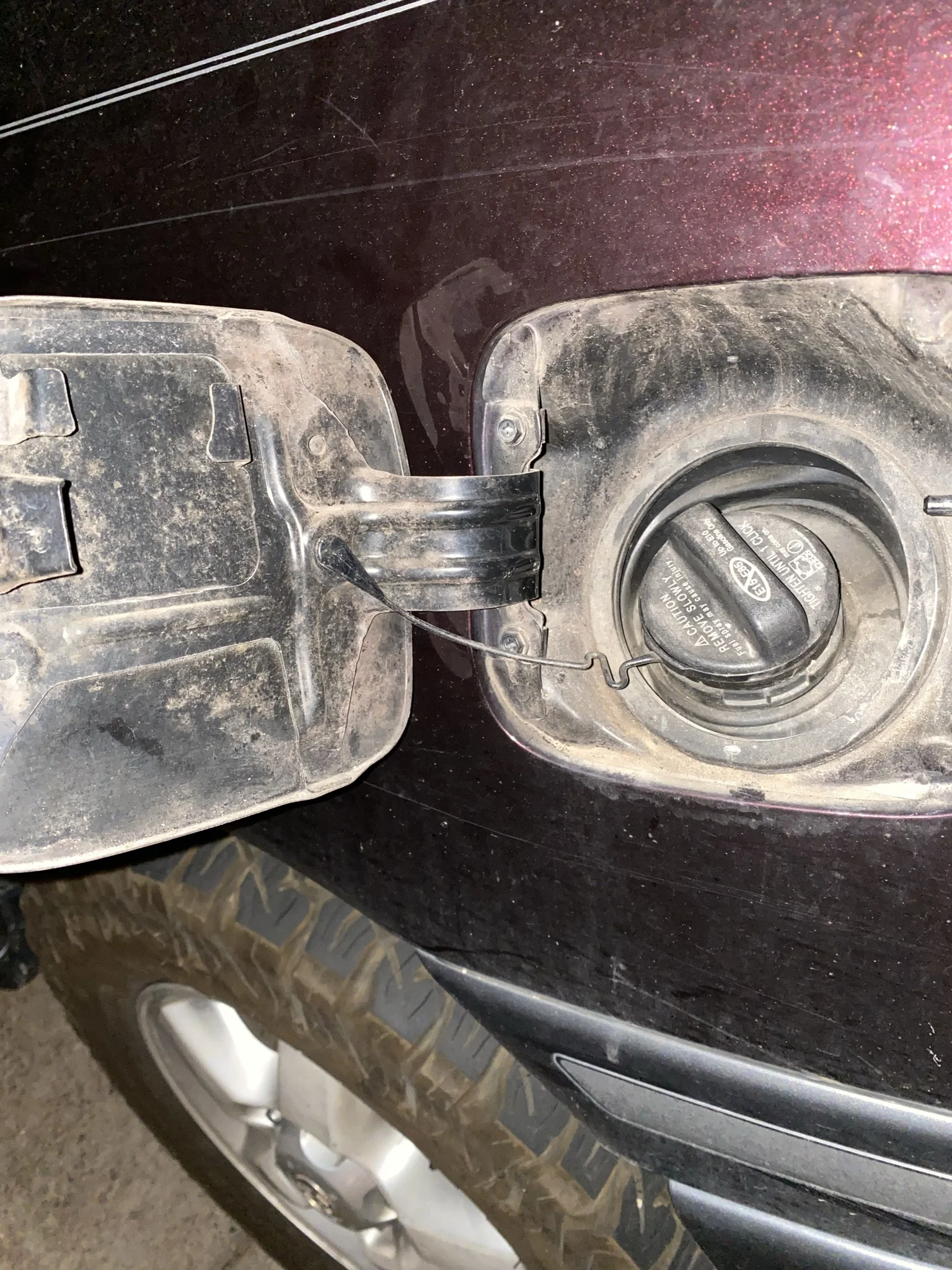

Look at gas cap area. If mucky, fuel tank has likely been overfilled. It has for sure been "boiling fuel". The OM states, in the 03-up: Never add more fuel, after auto shut off of fuel filling station pump handler. Doing so, will flood charcoal canister, which then needs replacing.

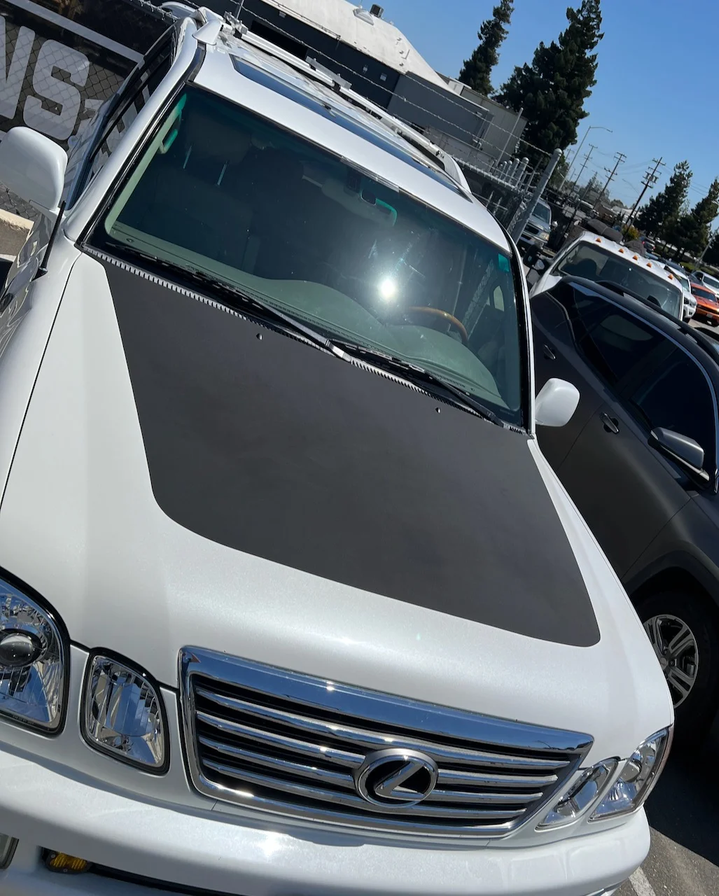

Where did you get the blackout hood panel? The guy I got mine from years ago no longer sells/makes.
I originally was going to install the premade one by CRAWLORADO but, because I sit high in the vehicle, I wanted a bit more coverage. I had the hood custom wrapped by KUTTEK in San Leandro and they did a fantastic job. I had them go out the front to where I couldn't see the edge anymore and went out to the hood lines on the sides. I also checked into the hood mounted solar panel made by CASCADIA 4X4 but ended up with the custom blackout panel. KUTTEK does not recommend matte black as it doesn't last in the sun for a long time. I ended up going with a 3M Textured vinyl that works great even though it is a little tougher to clean.
Thanks for the tip. I had mine done by Crawlarado, but he is no longer doing them and the solar panel is outside of my need/use case. Mind sharing how $$ KUTTEK charged you? I may have to go that route..Thanks.
It was just under $300 with the textured 3M Vinyl. They used knifeless cut tape to outline the shape, applied the adhesive vinyl, and then pulled up the tape to cut the shape. It's pretty slick. I've done countless vinyl applications before but ran out of time before a big adventure so I had them do it in a day for me... A month before, I had gone to Texas for the Solar Eclipse and the drive from California and back sealed the deal as the hood glare was just too much.

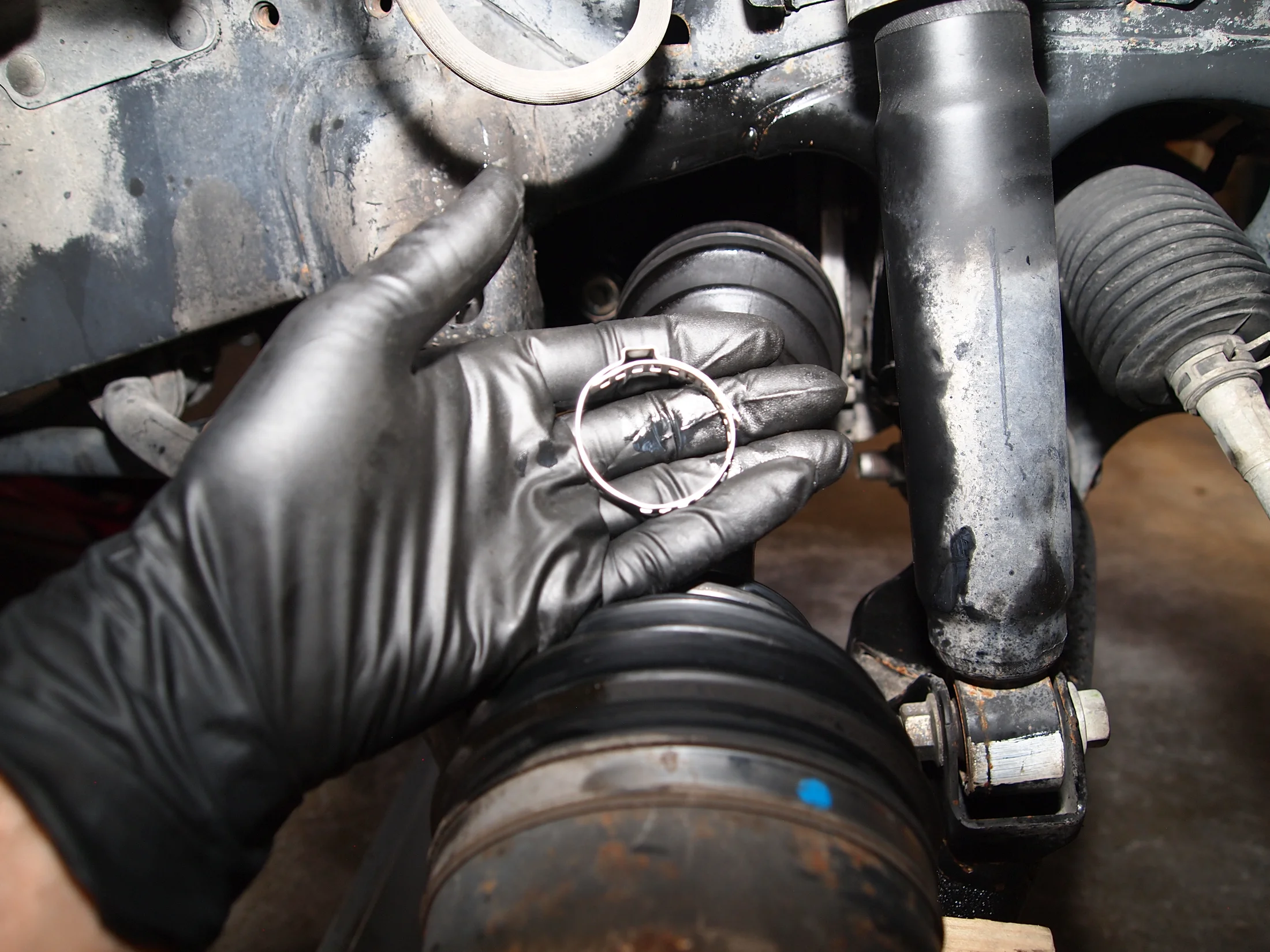

Thanks a lot for the tips and links! I am handy but some things I'd rather have a mechanic do. CV boots are definitely weeping, and I am pretty sure that nothing else was ever lubed either. I'll do the diff and transfer case this weekend, lube the dive shaft, flush the trans fluid. Everything else I'll have my mechanic do.
