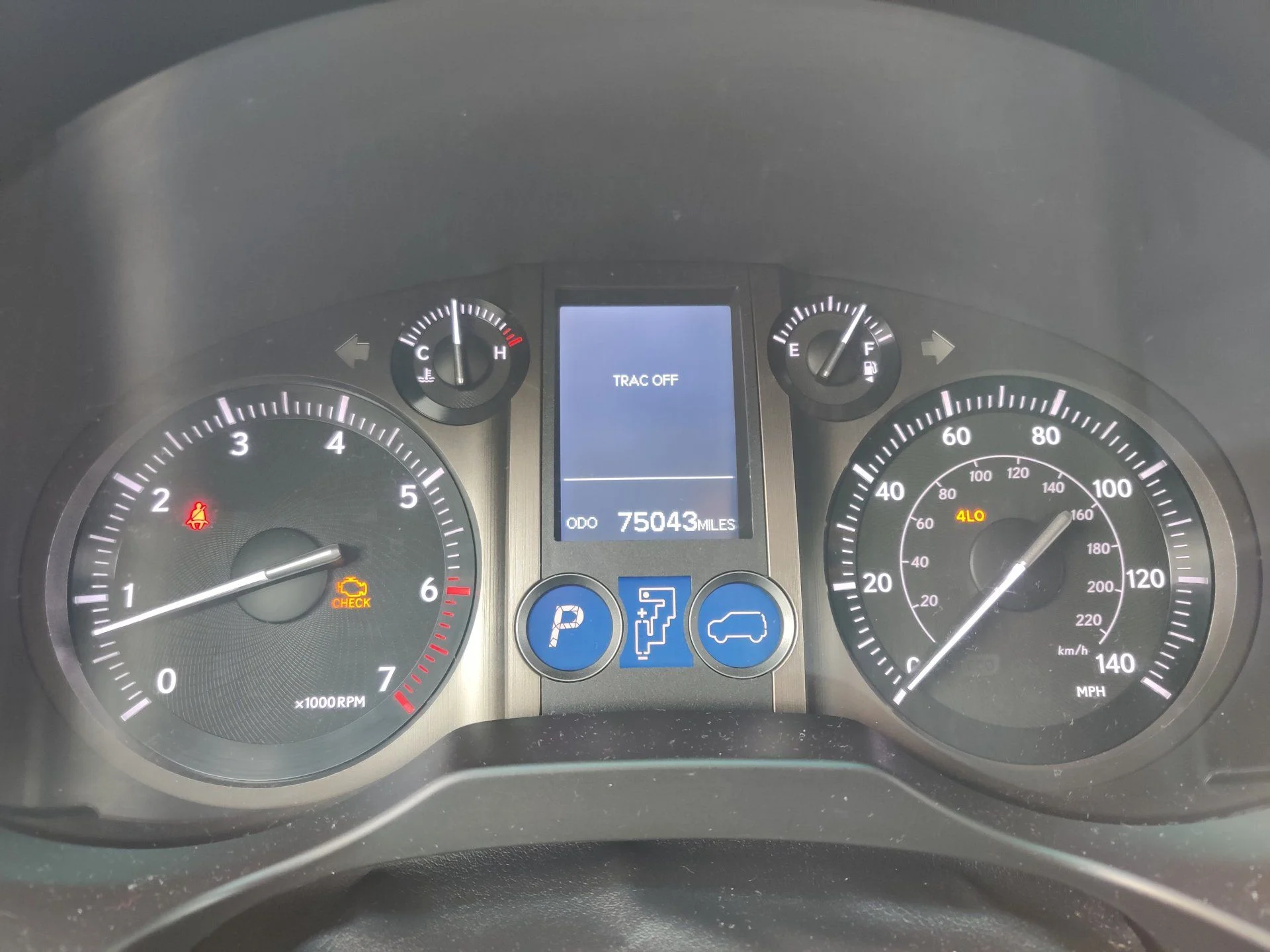

There is noticeable resistance when shifting from park to drive. The dash gear indicator does not show D when driving. Dash indicators: CEL (P0705), No Trac and flashing 4Lo. Drives fine as far as I can tell.
This has happened twice in the past year or 2. I cleared codes the 1st time and issue never resurfaced. 2nd occasion the dash lights and shift resistance went away after sitting overnight. Lexus could not replicate the issue when I was in for regular service.

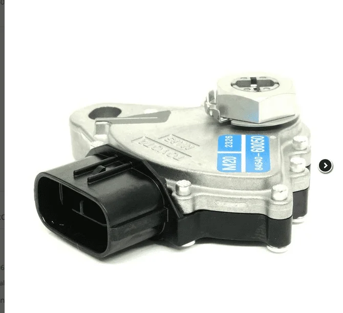

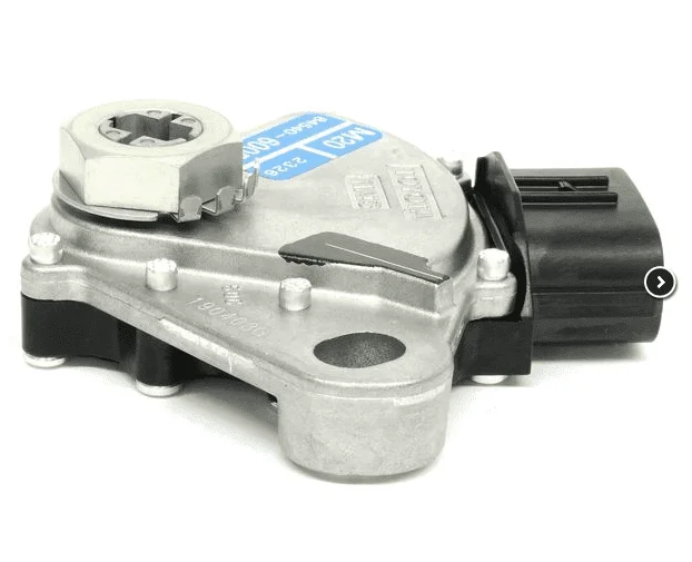

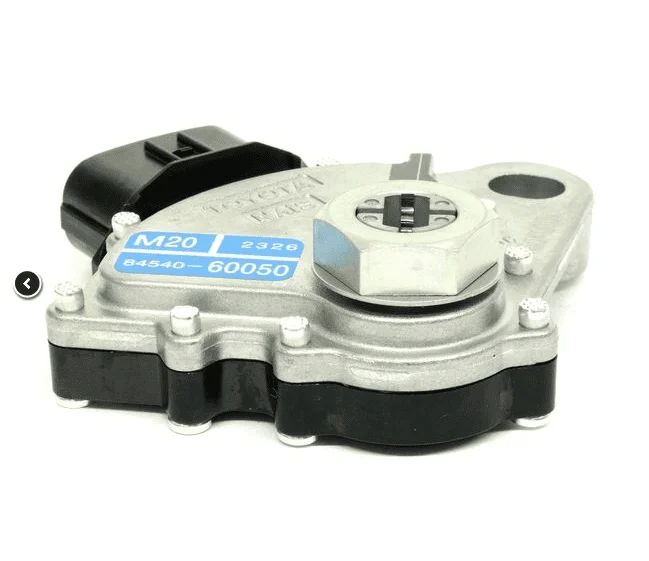

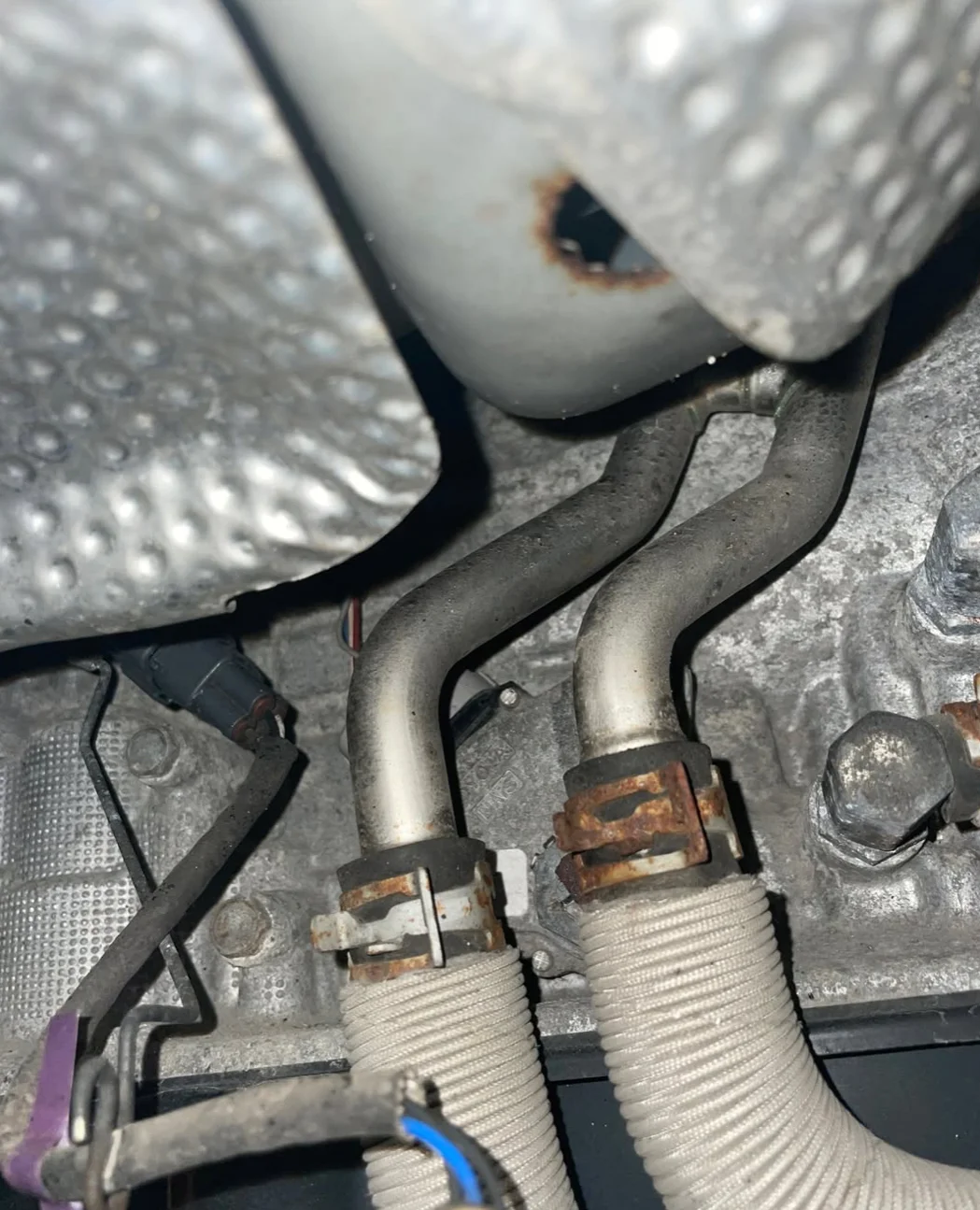

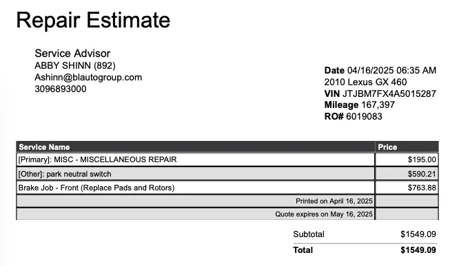

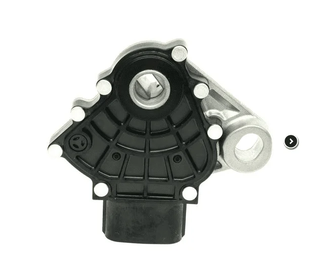

Took the truck to our local Lexus dealer (had good experiences there before). They did an inspection as I think you can watch below. The brake job I will do but I am having them put the switch on (it is pictured in the video and above this post as just the part). He says they might be rusted and they have had to cut them off. Below is also the PDF of the cost.
