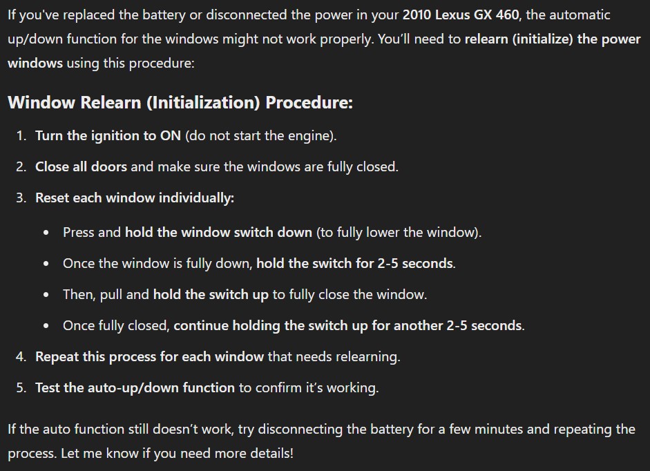

I asked ChatGPT, give it a shot?
Although this doesn't cover the lock situation but it's my shot in the dark.

Thanks for the response… I will give it a shot.
I did get a new battery a week ago because it was doing weird electrical stuff (interior dash lights cutting out at night, center screen resetting) the battery was at end of life. So it would not surprise me if this is a reset issue. It didn’t happen directly after replacing . I will try tomorrow.
Honestly, this vehicle is the most gremlin prone vehicle I’ve ever had! Always crazy electrical issues that go away by them selves or disconnecting battery!
OK, it didn’t work. Although that trick did help the other three windows roll up and down automatically, it didn’t help the door panel functioning on the drivers door.
