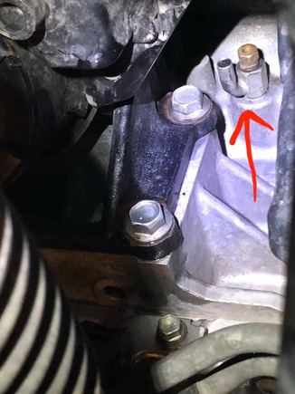

I'm sure someone more knowledgeable will be along shortly, but I just drained my radiator, overflow bottle, and passenger side block drain and I got out about 2.5 gallons. I was expecting a little more. What came out looked like it was in very good shape so I didn't worry about any further drain/fill cycles. If you're swapping coolant types I'd go to the trouble of accessing the driver's side block drain, refill with distilled water, run it, and repeat at least once or until it comes out pretty clear before the final fill. Measure what you take out so you know how much concentrate to put in. I believe the whole system should hold about 4 gallons.

I wanted to flush mine with distilled water at 100k miles, but decided not to since 50/50 premix is all that’s available in super long life. I bought 6 gallons. I drained everything I could out of the radiator, tank and two block drains, then filled it back up and ran the heaters in all zones for several miles and quite a bit since then. I plan to drain another gallon and fill with each oil change until I’ve used the 6 gallons. Since what I drained out looked brand new, I’m ok with having replaced most of the coolant.

I ended up draining the overflow tank, radiator, and both block drains and getting 2.5 to 3 gallons out each time and refilling with distilled water for 3 cycles. I drove around with all heat zones on and fan speed low for about 20 miles each cycle. Then drained and filled with 3 gallons on pink coolant 50/50. I know i am heavy on distilled water, but going to drive for the week and then do another drain and fill this weekend and probably the next weekend as well, then i should be close to winter protection levels. Pretty straightforward and easy to do.
