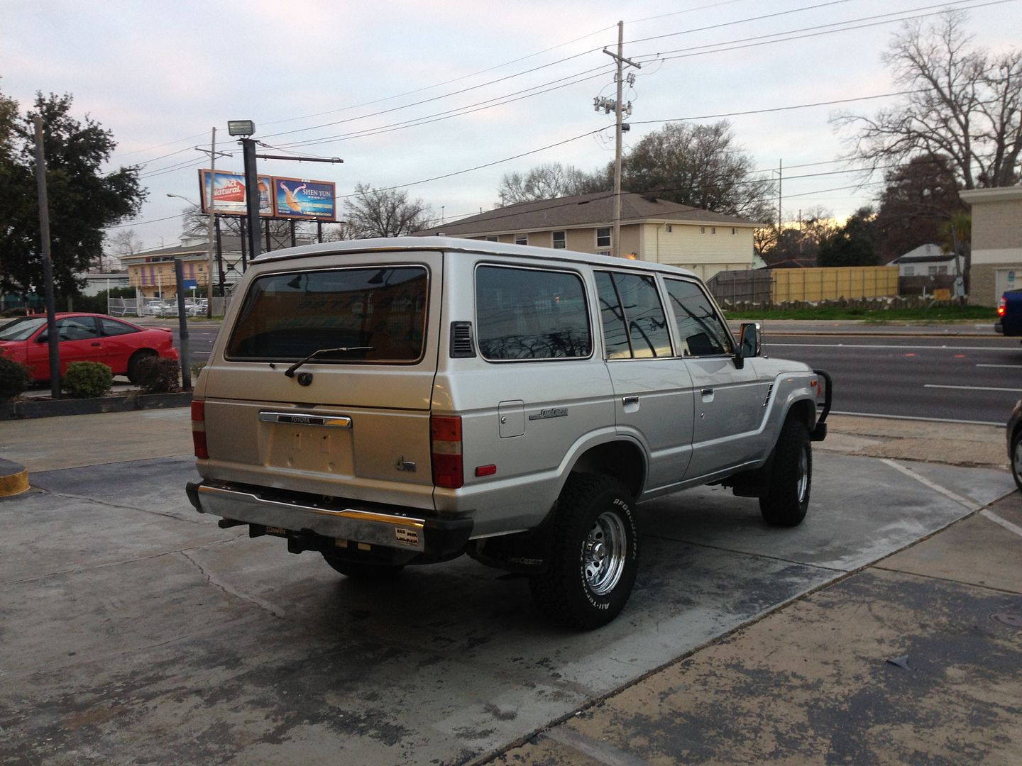

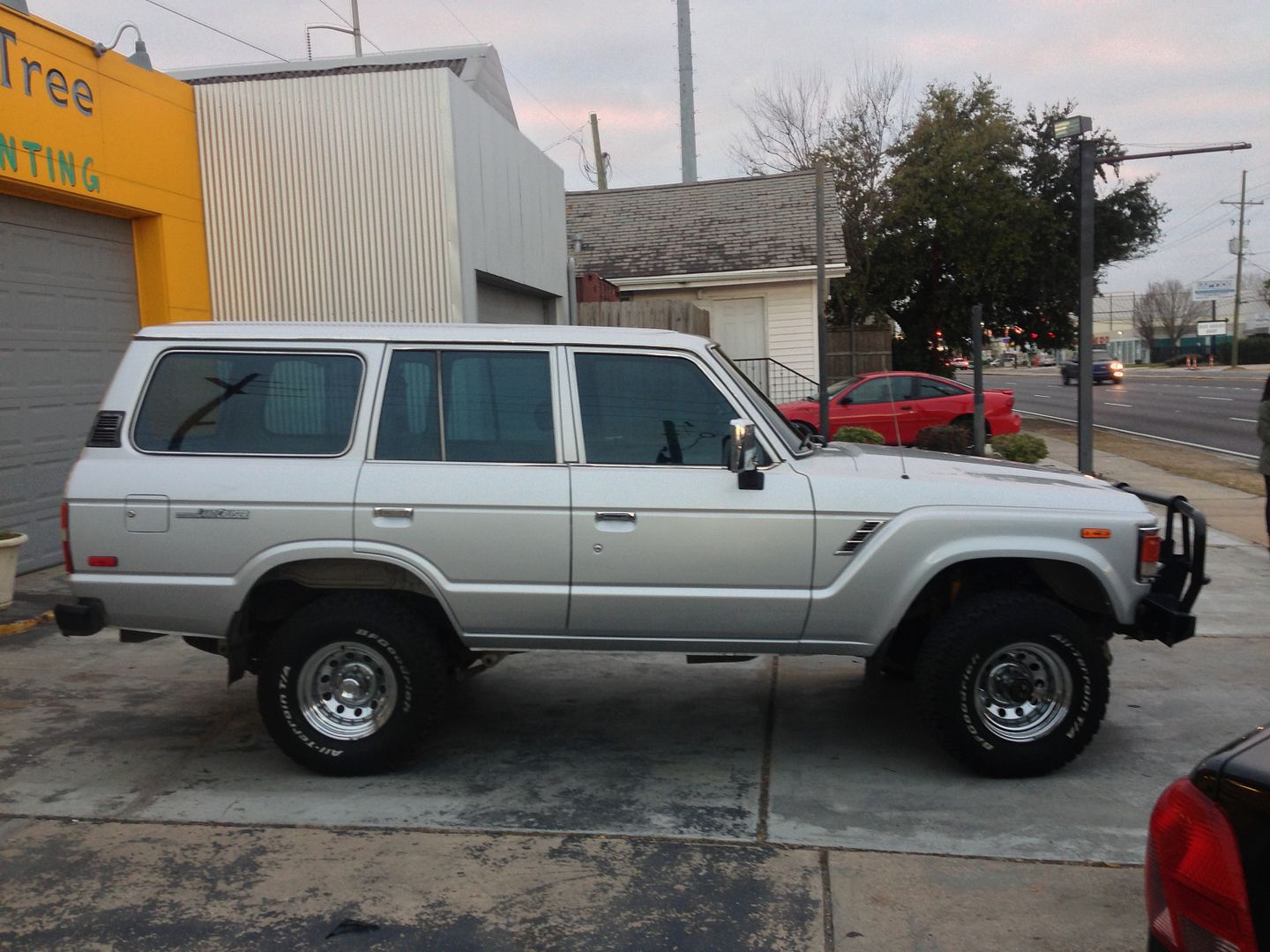

So, truck was delivered 6 Feb 2013. She's as beautiful as depicted in the pictures. Straight body, no rust, interior is better than average shape.
However, she has an exhaust leak (manifold), valves need a full tune-up and valves adjusted, tires have a ton of tread left but are dry rotted (disclosed before purchase) and the steering feels loose (she doesn't wander/drift, but there is a lot of slack in the steering wheel - including lateral and vertical excessive play/movement).
Over the past two weeks, I started planning and buying parts for 'projects'. I had the windows tinted already, spent several hours with my interior shop planning her 'spa day', and she's going in the shop next week for the following:
