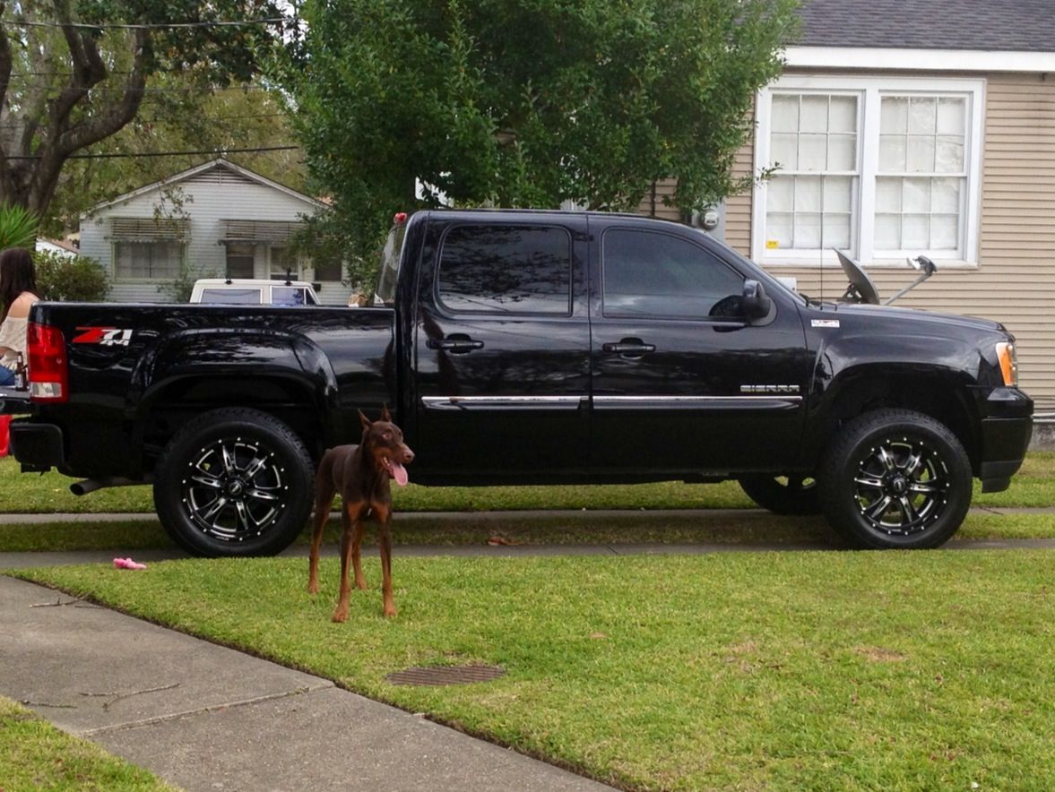

How's this for a testimony to my FJ's commitment:
Sold her last week in anticipation of the FJ60's arrival. Woot woot.
