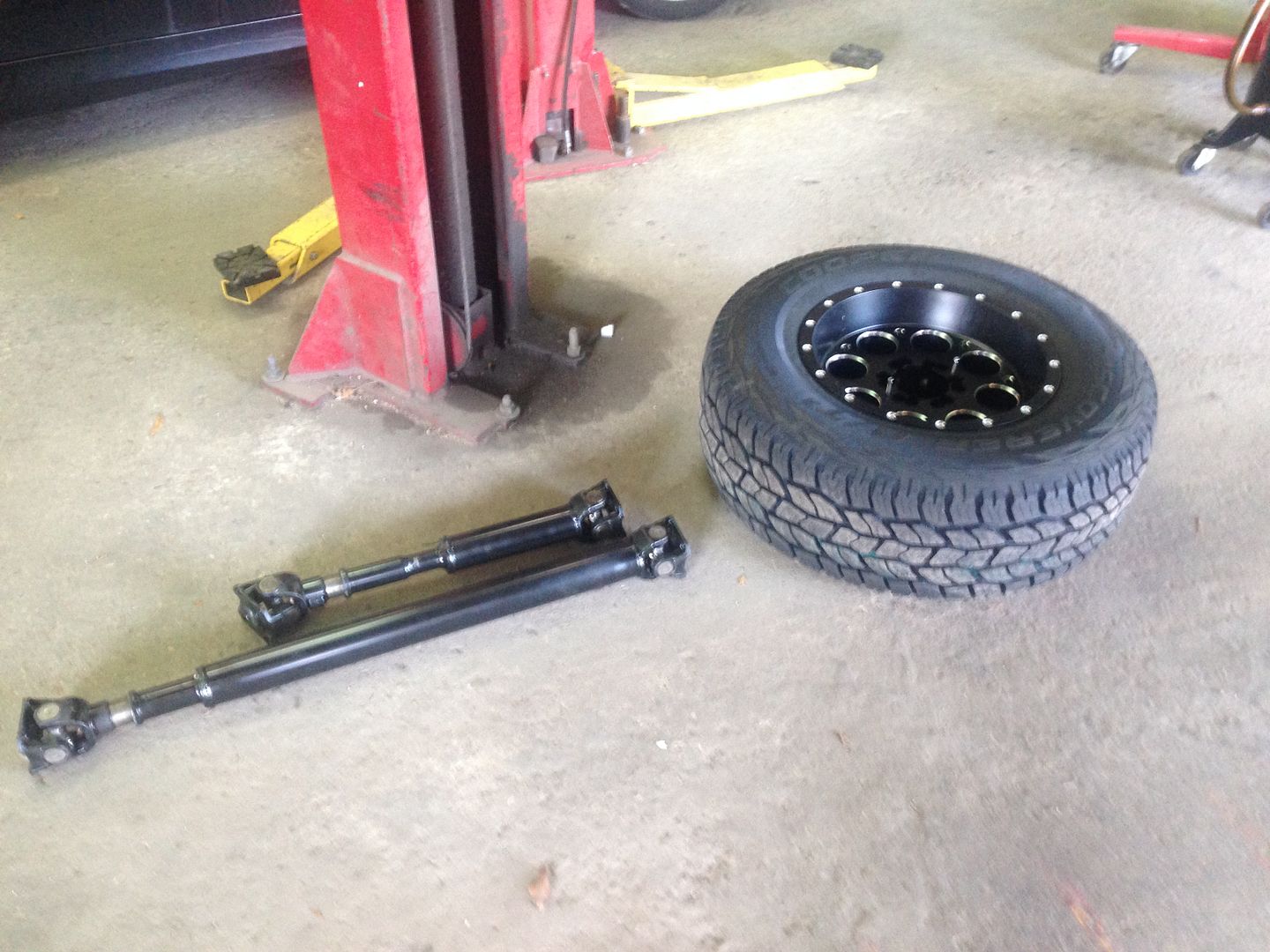

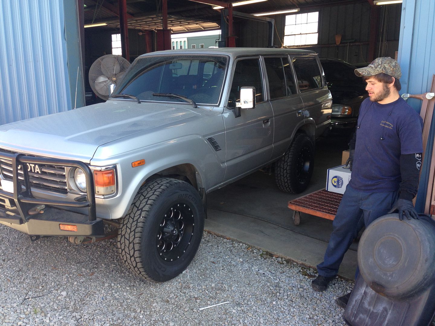

Learned that FJ60 projects don't always move as fast as you initially planned, lol. Been a while since I updated this thread:
Completed:
H55F installed
Drive shafts balanced, painted, all new hardware
Spacers, and Rims & tires installed (Fuel Revolvers (17x9) with Cooper AT3 33x11.5's).
Tune-up completed (but only to find another exhaust leak last week; coolant leak today)
Added rear sway bar, f/r bextended sway bar links, new f/r bushings
R&R interior dome lights
cleaned and got horn working
Parts on order:
Bunch of stuff from SOR (grill, headlight doors, wiper stuff, trim, gaskets, seals, front lens/gaskets, rear light assemblies, fender seal kits, etc.).
Battery cable upgrade (IH8MUD: four runner) - awesome customer service.
JW Speaker headlights (http://www.jwspeaker.com/other/8700evolution)
Tuffy Console (finally off of back order)
This coming week/weekend:
headlight harness/aux boxes (IH8MUD: wiredwagon - awesome customer service as well), battery cable upgrade, headlights)
SOR parts
Tuffy if it gets here in time.
Engine/brake decision:
Going to go with the 2FE build (justin @ red line to do the build)
Toyota V8 BBK conversion (justin @ red line)

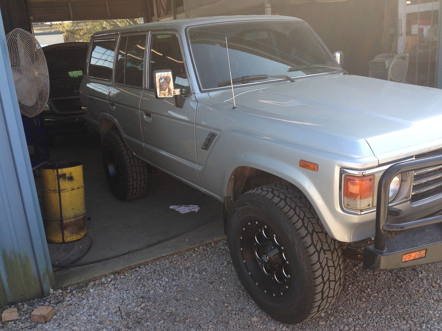

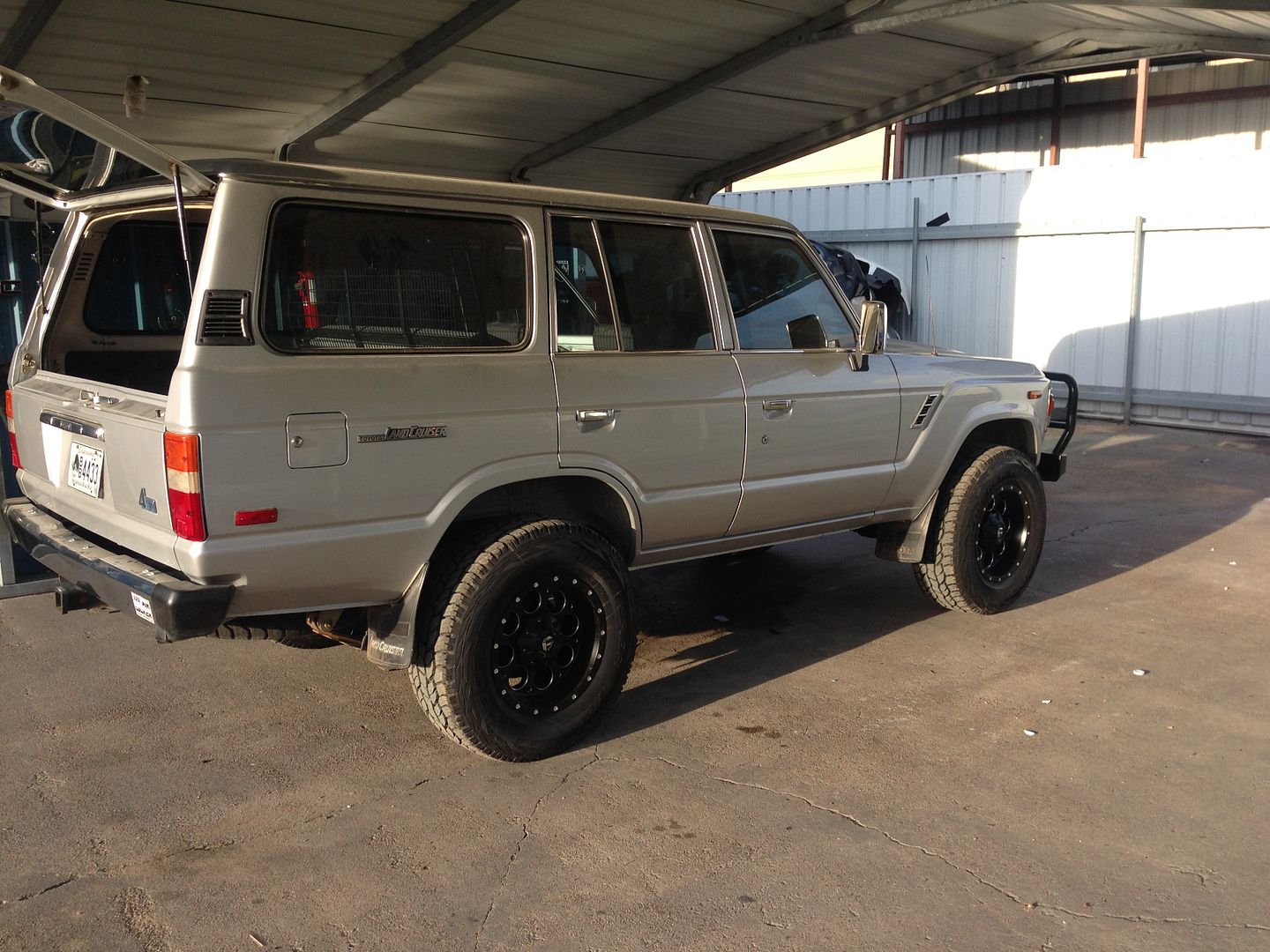

Here's a few pics:
Nice truck there mate and good write up, looking forward to see some.
Might be a good time to invest in some flares otherwise those tyres might start stripping your paint work with stones and rocks flicking up :D
:cheers: Spudman
:cheers: Spudman
Thanks, Spudman. . .compliments & advice much appreciated.
Wouldn't happen to know where I can get a set of flares, eh? From what I read, nobody makes FJ60 flares - and when I talked to my body shop about a custom fabrication, the costs didn't justify getting it done.
Shane
Definitely come a long way Shane and you are moving fast!
Nice job.
:clap:
Thanks, Onur. . .and no way I would've gotten this far without your help & guidance. It's scary to think the big jobs ($$$) haven't even started yet (motor, brakes, interior, electrical). Hey - might be in your area for a 2-day meeting. I'll probably take the dd vs. the FJ60 - but either way, I'll stop by and do an official 'meet & greet' if you have time.
Shane
Looks sweet!
The wheel adapters look good too!
Thanks, MicahMan. . .it was a really tough decision to put a set of spacers on her. The front two will come off when I do the BBK upgrade - the upgrade pushes the axle out 1.5" on each side - but the rears will have to stay.
Shane

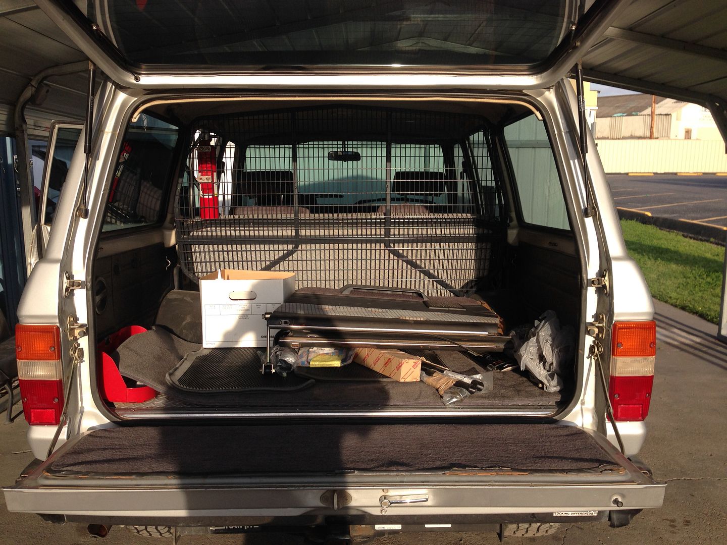

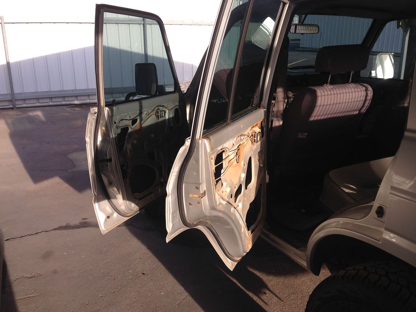

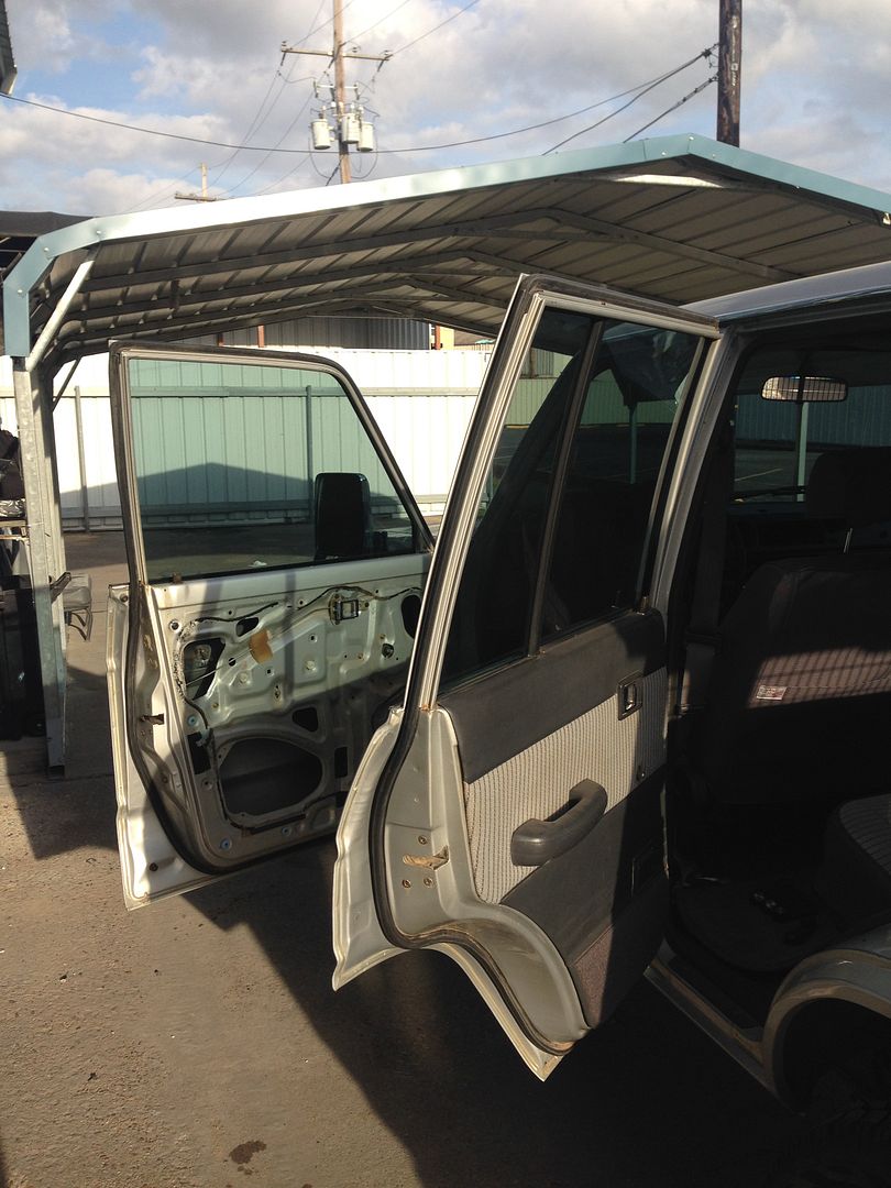

Finished work a little early today and started working on the FJ60 - pulling the interior to dynamat/sound deaden. Bulk pack = 36 sf, so I'm thinking 4-5 bulk packs to do the entire truck??? Also, quickly realized I'll be placing an order with Onur for some trim/door parts ;)
A few pics:
Wow! what an amazing Truck you just purchased. very very nice. have fun with her and enjoy driving it. the thumbs up you will get will just put a sense a pride and a big cheesy grin. looking forward to watching its progress.
Man, thanks so much for the compliments - and right back at ya'. I looked far & wide for a FJ62 but in the end, it was the headlights that kept me coming back for more on the FJ60 ;-) It's funny. . .I've had her for a bit now but she's been in the shop substantially more than I've been behind the wheel. To say its been an learning process is THE understatement of the year (for me).
Shane

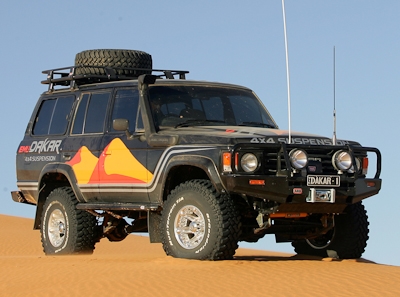

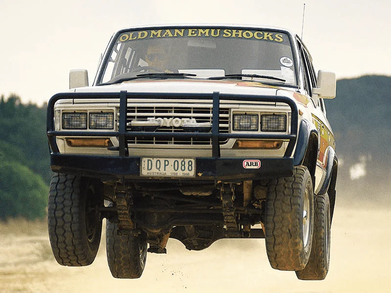

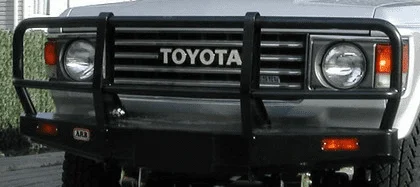

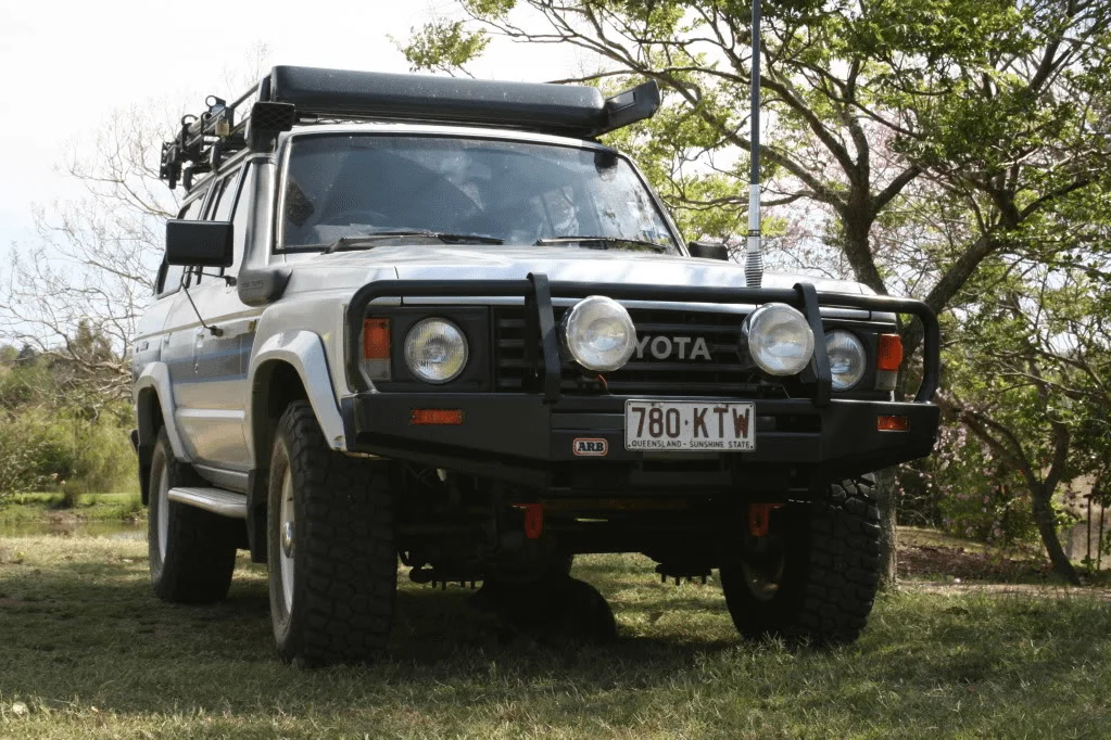

Shane, a few questions!! The ARB bullbar that you have on your truck, do you know the model number of it?
I was looking to buy one this week. However since I am in Mumbai, there's just one importer of ARB. So it takes about 40 days to be shipped from Australia to India. None the less, I was looking for the bullbar like yours. I don't like the bullbars that are mounted high!
This is what i dont like:
This is what i'm looking for:
Here's the catch - my cruiser has the rectangle headlights with the turning indicator under it. So i'm hoping to it looks like this:
I'm getting my OME kit too by next month end, so i was hoping to buy the bullbar along with it. Do you know the model number of the one you own?
I think... and correct me if I'm wrong. That is the "old style" ARB bumper. They only make the new "full" style these days. The PN of the new one is: 3410100. Un-fortunately you can't buy a brand new "old style" one from the factory. You'll have to look for a used one and pick that up, or have someone local to you re-create it.
I don't think its so much that the bull bar is mounted high, so much as the bumper is larger and offers greater protection than the old one. But again aesthetic is just as important as function otherwise no one would buy Ferrari's
