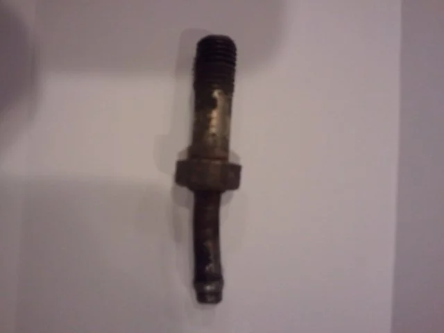

Sorry, not a very good picture.
I pulled this breather off an old rear axle for my 40 that I am trying to bring back to life. This one is bent and in bad shape. I have seen the ones with the little cap on top that can be removed to put a hose on, but this one looks like it was made to put a hose on. Does anyone know where I might be able to get a good replacement?
Thanks!
Cheat! If you have a GOOD auto parts or hardware store go buy a 1/8" or 1/4" brass hose mender (your choice, about $1), these have are barbed on both ends. Saw the existing tube off the bolt and drill down about 1/4" with a bit the diameter of the barb. Cut one end of the hose mender about 1/4" below the shoulder, insert into the drilled hole and solder (or JB Weld) into place. Be sure to check that solder has not plugged the hole. If it does, just run a drill bit through to clear it out. I use this method on older rigs that did not come with OEM breather extension tubes.
from the website:
100-11RX AXLE BREATHER, XTNSN TYPE $8.50.
