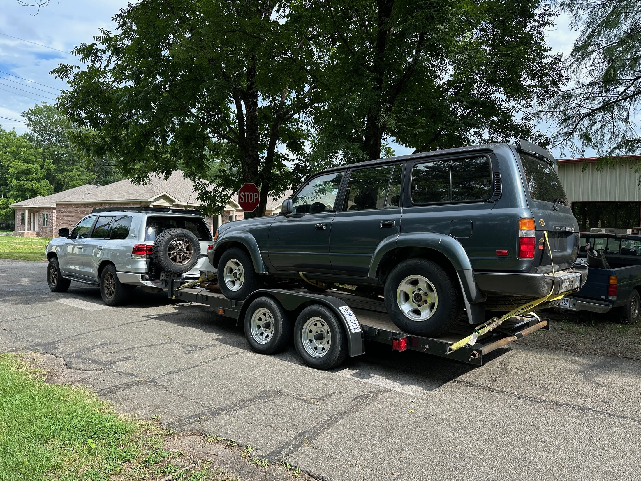

Long story short, my son bought a '94 80 series with a blown engine. I went with him to help haul it home. The guy he bought it from told him the head gasket had blown and the owner continued driving until it locked up. Seller also told us that he had put a little oil in the cylinders to see if he could break it loose.

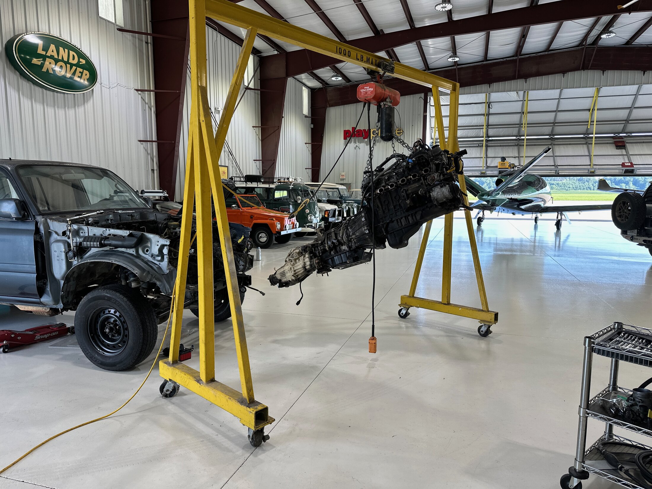

So out it came, transmission and all.

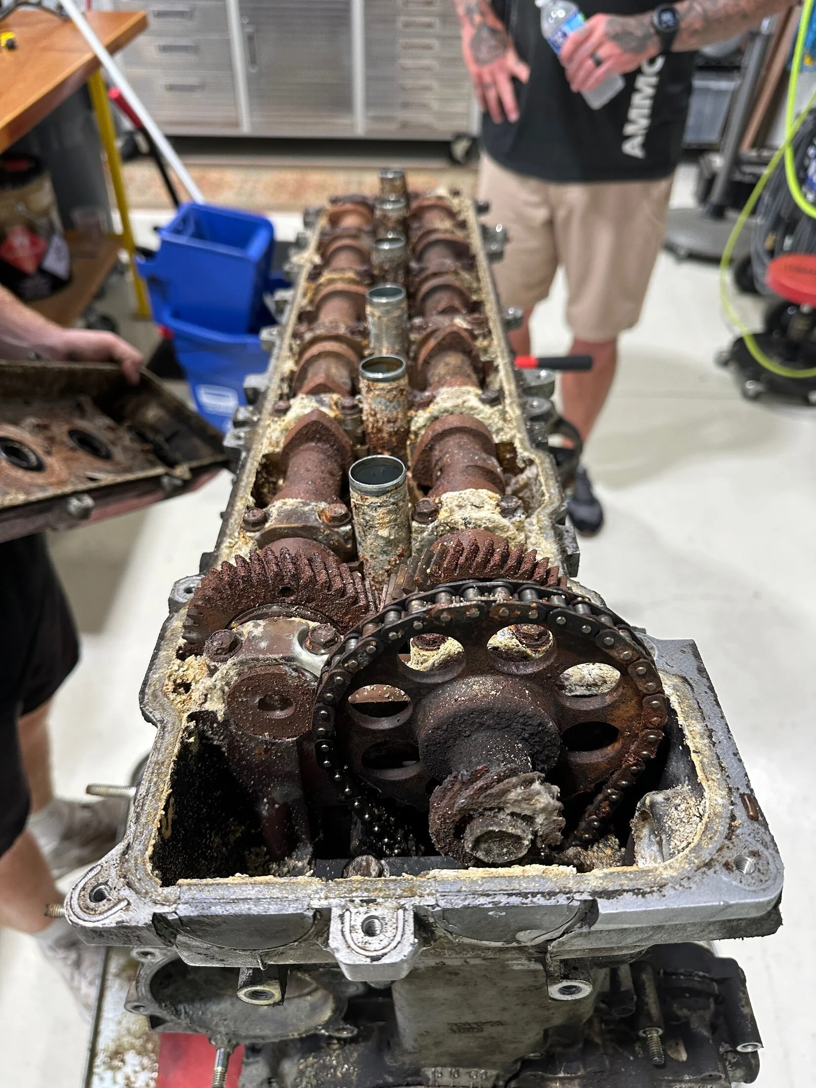

And we started the disassembly process. Sadly the valve train took the brunt of the abuse.

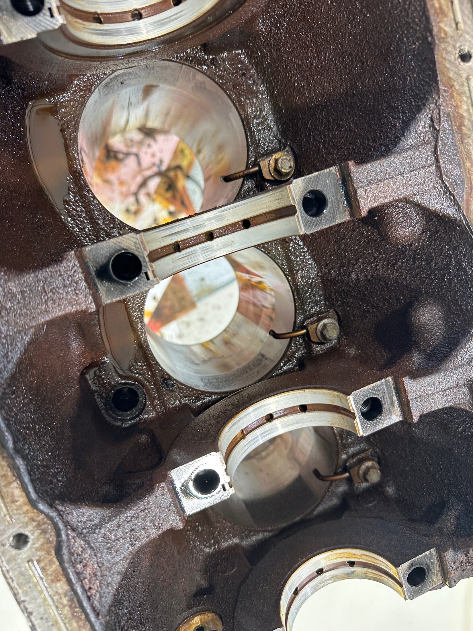

After pulling the head, we found that the engine would spin. Luckily the PO had filled the crankcase with what we think was Marvel Mystery oil. We must have drained 2 gallons of that from the oil pan.
So, with the engine completely apart, we are dropping it at the machine shop today. They charge $300 to $400 to measure and inspect everything. Once we get the estimate we will decide how to proceed. It has been fun so far. And the look on my son's face when he pulled that valve cover off!!! He just turned 19 and has come so far, from fetching tools as a little kid, to working on aircraft and now his first Land Cruiser. And he is funding this project himself. He keeps reminding me that I still owe him a car, because I bought his sister one, but he is saving that for later!
I guess I need to start researching cams, I don't think these will buff......

Oh man that’s rough!!!! You can still buy all new cams from Toyota and an empty head, you will have to reuse your buckets and shims but I would assume those are smoked and rusted Like the cams. I had an engine I bought and the head and block had water in it I could not save any of it had to scrap it unfortunately. Nice gantry crane!!! And work space.
Yeah, nice gantry crane & work space.

The machine shop said the cams might be salvageable? I can't imagine how that would be possible though.
The Google showed me that there are various "stages" of cams available. I need to read up on that a bit. The plan is to stay stock. He wants it to last another 30 years.
Ah you just wanna flex, I see. Kidding aside that is a phenomenal setup you have, love to see it. Glad you knew what you were in for with that engine, that's the roughest I've seen by far. @slow95z is another member here (in addition to @Fj80oregon) that will sell you an engine, he's not an engine builder but good guy and slightly closer to you in Georgia.
