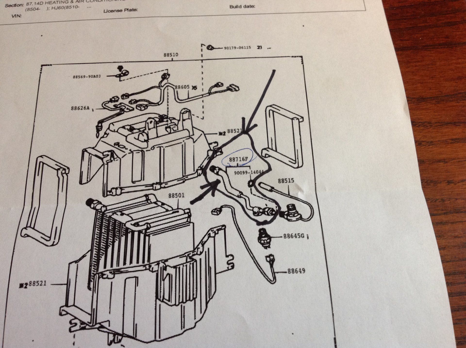

Need a/c hard line that goes thru the firewall. There are 2 lines that go thru the firewall, one fat, one thin. I need the thin one. About 12" long and curved.

88176 is the reference number in the diagram since there is a split between 80-84 and 84-87. The actual part numbers are below:
80-84 is 88716-90A05
84-87 is 88716-90A27
Yes, you are correct 88-90 is also 88716-90A27.
