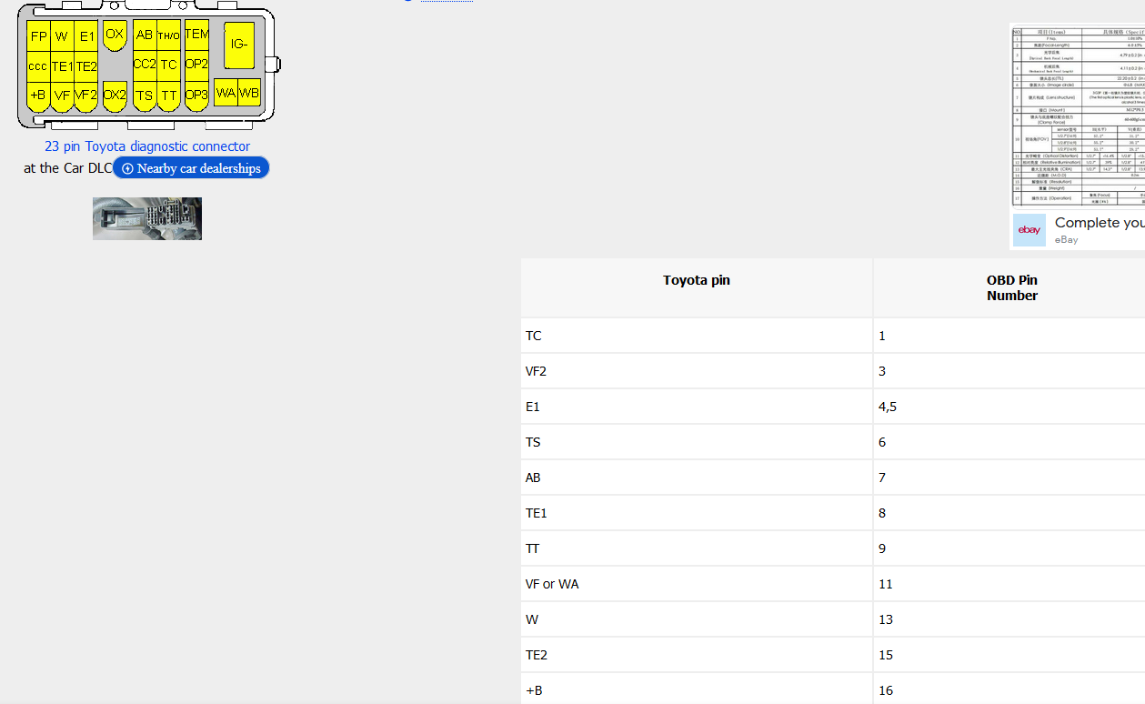

If you're just doing this one time, I wouldn't waste time trying to find one. Just make up a set of terminal-ended wires and screw them onto a board.

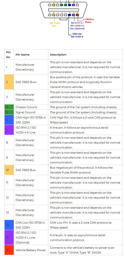

Here are the pinouts for both 16-pin and 23-pin connectors.
23-pin:
16-pin:

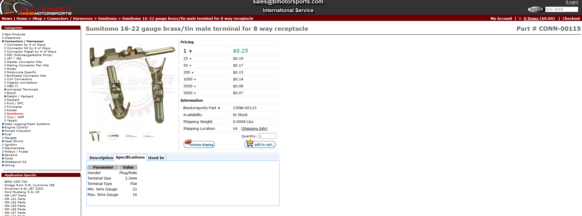

This isn't as neat as an adapter, but it'll do the job, and you should always have a dozen 6-inch lengths of wire with terminal ends crimped on them, for troubleshooting purposes. Type 2.3II males; Ballenger does have those. I buy them buy the hundred.

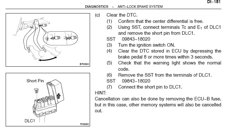

If you just want to clear the ABS of codes, just follow the FSM.
Connect TC and E1, and remove the short pin, followed by depressing the brake pedal 8 or more times in <3 seconds.
23-pin:
16-pin:
This isn't as neat as an adapter, but it'll do the job, and you should always have a dozen 6-inch lengths of wire with a terminal ends crimped on them, for troubleshooting purposes. Type 2.3II males; Ballenger does have those. I buy them buy the hundred.
First, thank you for responding - I appreciate it immensely. I have a couple of questions. I'm going to profess my ignorance and say I know very little about this topic. As for the wire, what gauge should I use? I think I have some 20 gauge lying around. For the terminal ends, are you talking about the Type 2.3II terminal blades? When I search queried that on Ballenger it came up with no results?

Sorry, I misread. I also had to clear the Airbag light during my rebuild..😁 page DI-229 on my 1996 LX450 FSM.
Here's the Ballenger page:

You need to find the terminals of the 16-pin map that correspond to the terminals in the 23-pin map.

Not every pin is used. Start from the 16-pin side. I think you only need five of the 23-pin terminals for the airbag system.
