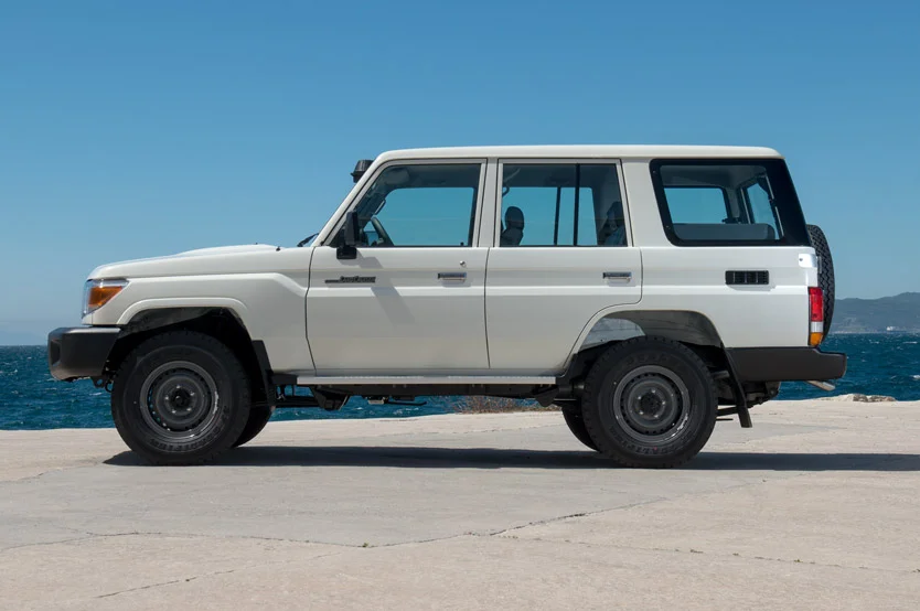

I have seen all the Toyota Gibraltar Stockholdings 70s are equipped with these and they appear to me based on photos to be a 16"x maybe 6.5" wide steel wheel painted in an ANSI gray powder coat I assume?
See photos here:

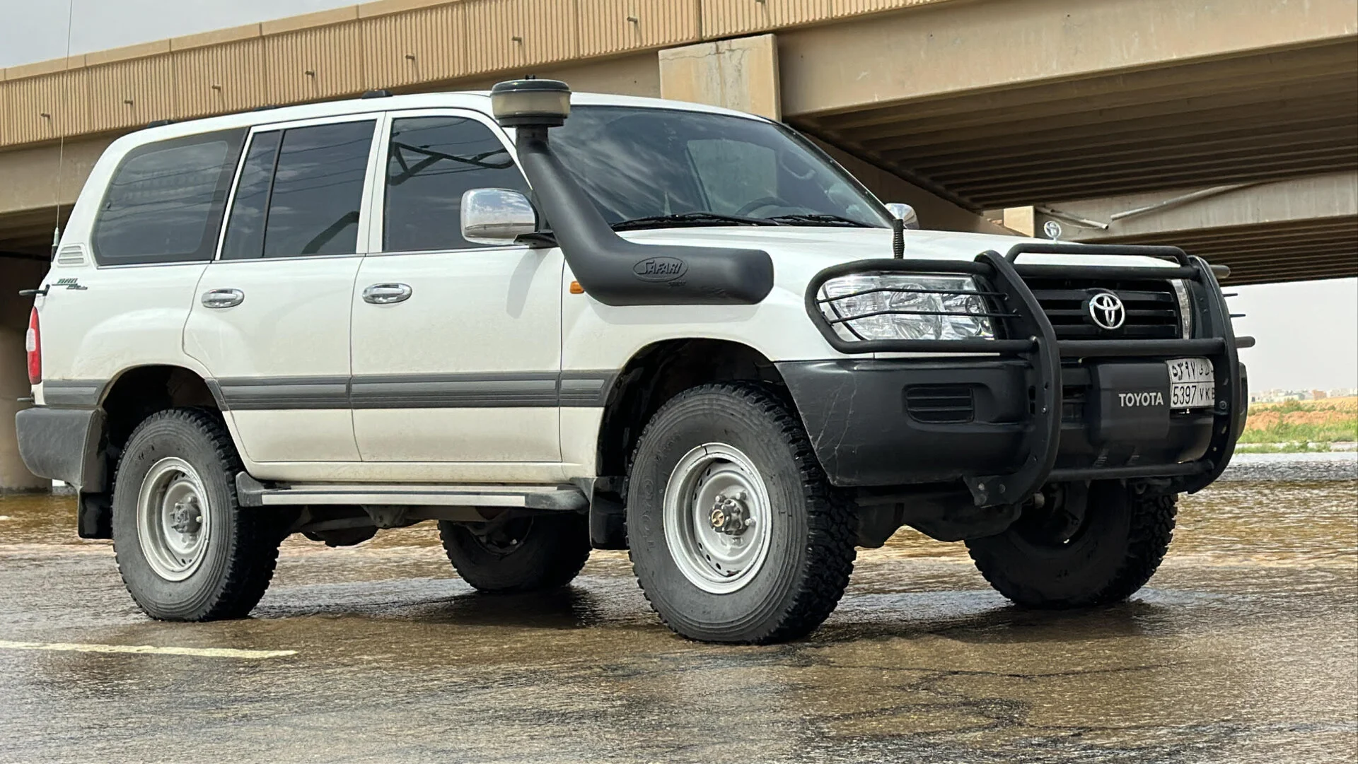

Here are the O.E. splits on the 105. These did not ship on the car. But I changed them after the fact. Tire spec here is 255/85R16 Toyo M55 AKA the best all around tire on the planet.

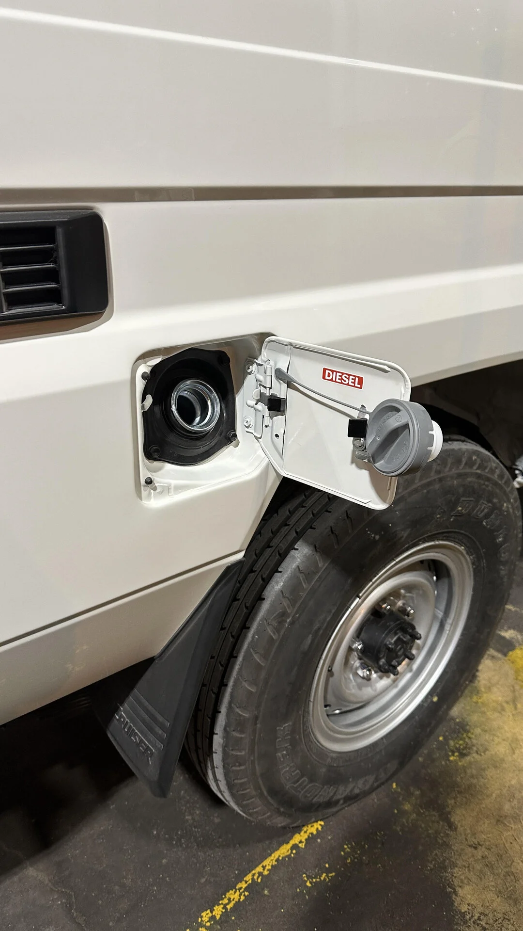

And here are the O.E splits on my 2023 VDJ78 with factory sand tires. Sorry, it's the best picture I have of the car right now, I know, weird. Tire spec here is 225/85R16
