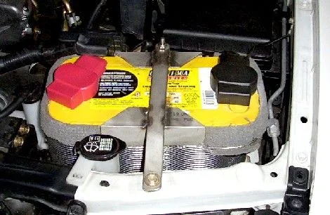

The first step in pulling all the pieces together was to build a tray for my secondary battery. First let me say that I took the baseline design of the Slee battery tray and Spressomons ideas for a fuse block/breaker holder and the additions of lower support legs to fab up the tray. So they get all the credit for how it is designed, I just pulled it all together with some scrap steel in my garage, so thanks guys!

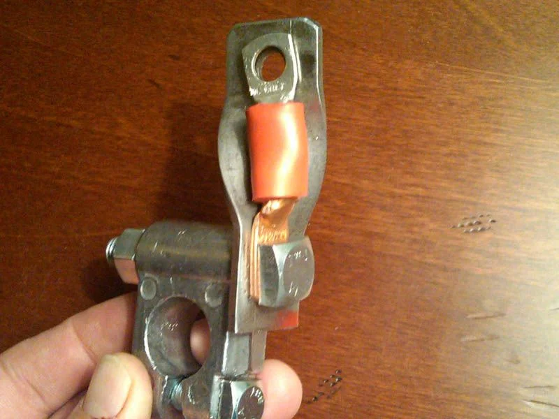

[FONT=&quot]To hook up the large factory fusible link as seen on your positive battery terminal using the military style post terminals I had to make a small bracket. If you use the ones that come with the kit this is not necessary. This picture shows what the bracket looks like. The very small cable I made is redundant and more than likely not needed, but I wanted to make sure to have adequate electrical flow from the battery to the factory fusable link. I will post up a picture of what it looks like installed once I get my red top in place. [/FONT]

You may want to get some of these terminal post covers, they cover my military style battery terminals very well.
That's an Optima Group31 in there, I have one both sides, they're big suckers but they fit and they spin the diesel really easily.
Get rid of the small cable that is now replaced by the buss bar.

Isn't your fusible link no longer fusible? Is it insulated from the bracket? I can't tell from the photo...

This wire is NOT a fusible link. it is just a wire. I know its redundant as the twisted bracket will pass the electrical flow to the factory fusible link (the one that is big and black that attaches to you positive terminal). I just wanted to make sure I had proper current to the primary factory system.
see picture installed and connected to the factory fusible link.
Trumped me again Zane! Nice bracketry and terminations. I like the way you moved the fuseable link away from the battery. It is a tight fit on the Optimas anyway.
