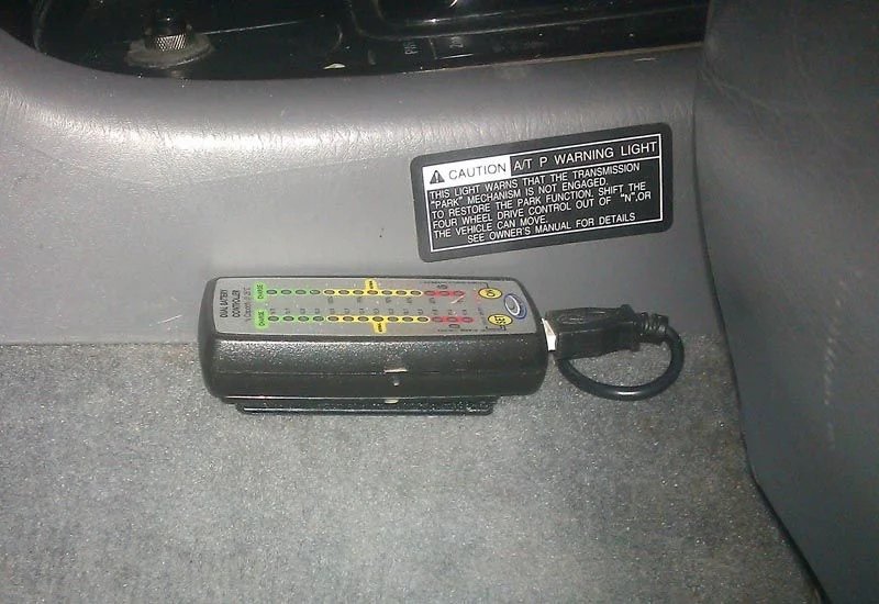

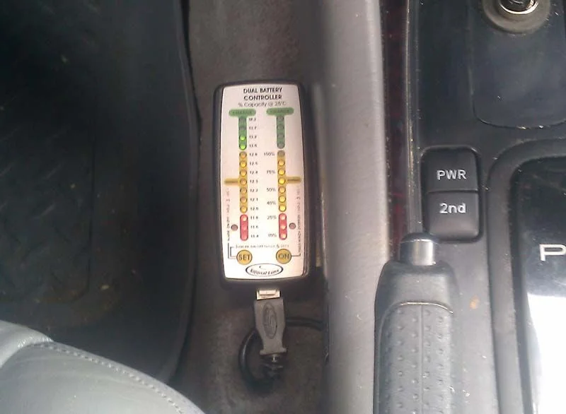

Do you have any pictures of what you did inside the cab to control the dual setup?
Zan,
Attached are some pictures of where I placed the National Luna controller. I made a little bracket cut out of a hard piece plastic for the controller to sit on. The bracket goes under the center console section and is attached via screws into the transmission hump under the "Power / 2nd" buttons. I then used Velcro to attach the mounting plate to the plastic.
See Pics of bracket placement and National Luna mounting plate:
