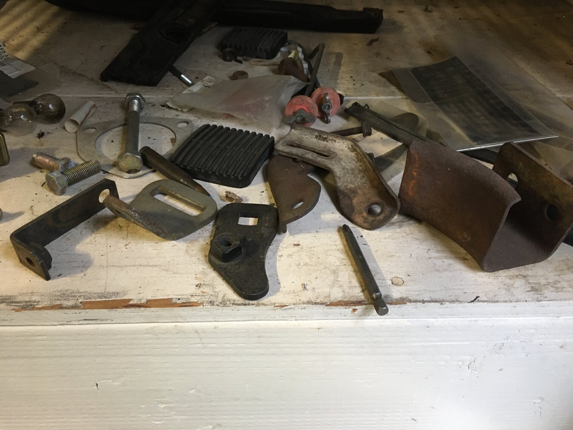

Here are some anonymous brackets to start. Disregard the bolts, bulbs, and gaskets etc, just need help with the other stuff in the foreground.
This is for a CA, Feb 79, 40 series.

Starting from left to right-of the six pictured--bottom brackets--1.don't know, 2. seat belt, 3. seat bracket-psgr side?, 4 & 5 Alternator brackets, 6.-unknown
I beleive #5 is a smog component bracket that is underneath the exhaust manifold on the left side.
Friends with the hose and finned smog box that departs when you desmog manifold.
Bingo on 5, just bolted that back on last night, holds the flex steel pipe to exhaust manifold between EGR cooler and EGR vacuum modulator.
