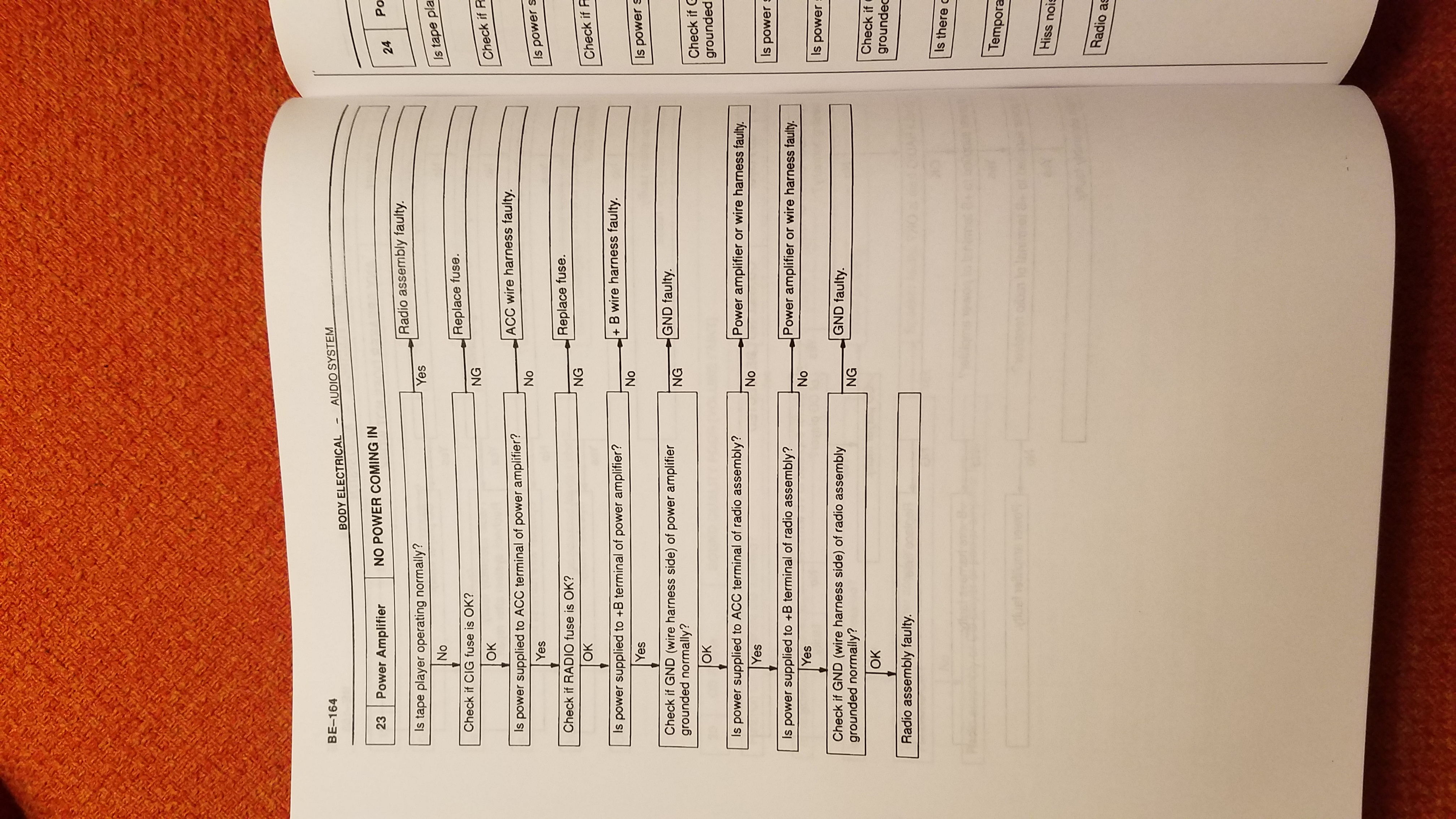

I just had a look at the stereo section of my '99 FSM. I don't have the full schematic to see why, but the amp no power troubleshooting flow specifically mentions checking the CIG fuse. Since you did have those wires out, it might be worth swapping it for a known good fuse to see if that helps.
I looked to see if any fuses looked broken. Nothing stood out but I may just change the cig fuse to be sure.
