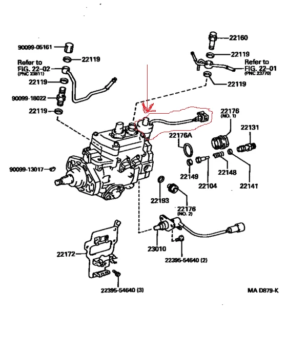

My mechanic says I need a new fuel cut off solenoid to fix this. Which part is that? I can't figure it out from the online parts diagrams. Also, does anyone think he (my mechanic) is mistaken?

OK here's the spill valve in a ToyoDIY diagram. However, they don't list it with a part number. Hate to say it, but you may need to find a whole pump if they don't sell it as a part. :(

OK, as Jimmy Prado said, it is a Spill Control Valve, not a Fuel Shut off. Make SURE your mechanic does not put 12V to it directly to test it, as it'll burn it out and then you'll really need a new one!
