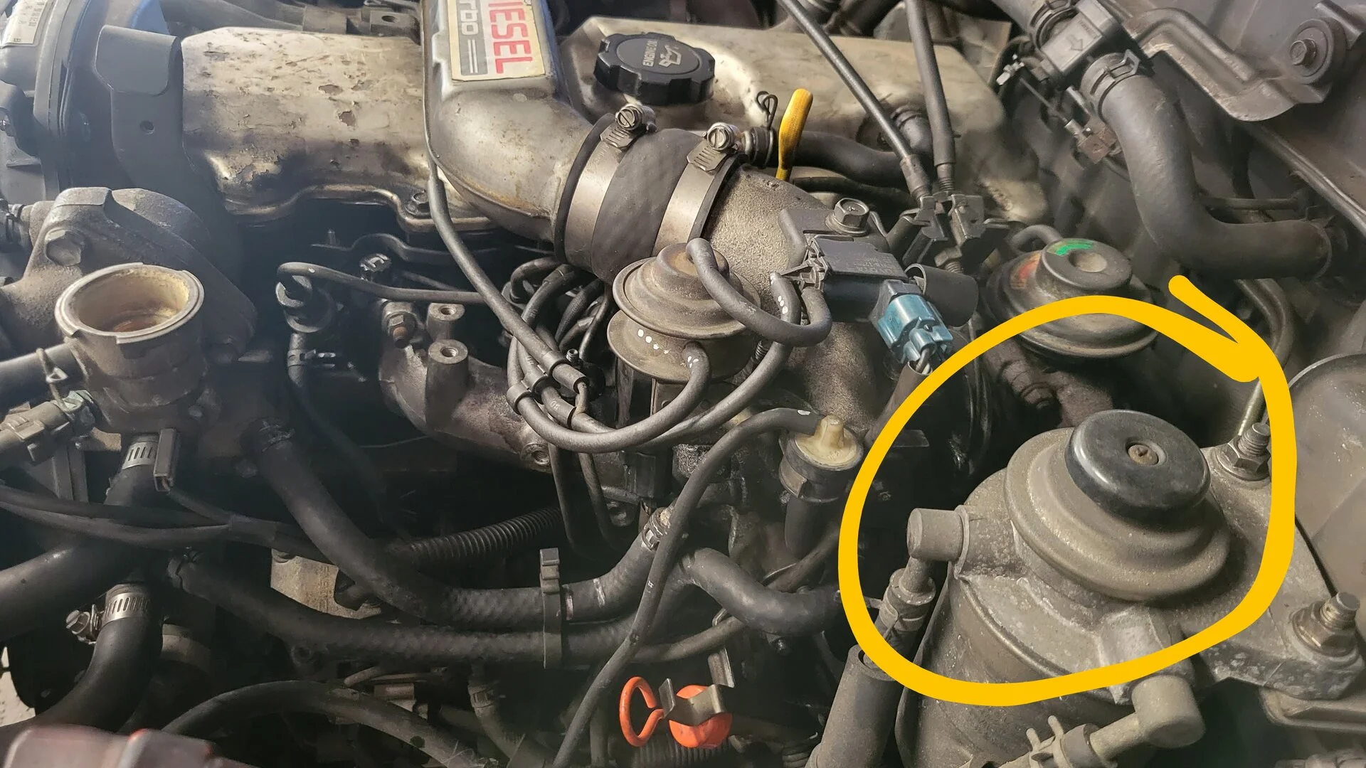

Ok guys help the idiot. I know the primer for the fuel system on the LJ is on top of the filter housing. I put a new head on this truck so the system is completely dry.
Have cracked the injectors so they can bleed and pumped the primer on top of the filter.
The primer button only moves about a quarter of an inch. Is that correct? I have tried turning it left and right to "unlock" it but that doesn't seem to matter. Am I just dumb, help me obi wan.
The circled part of the picture is what I'm referring to as the primer.
That's all mine has ever done. I think the next step is to crank the starter until you get fuel from the fuel injector nuts and then tighten them down.
Yep, that be the primer... it can take a while too if the system and filter were empty. Just keep pumping until it gets firm. I have never needed to crack fuel lines or anything else once I have positive fuel pressure in the system. I generally just start it up and let it idle and self bleed any air in the system. If this is NOT working, then there may be other issues going on like a leak in the system allowing air in.
Just to clarify: pumping the primer will not force fuel out the injector lines. Once the primer starts to get hard to press the system will be bled up to the injection pump. Once that’s done the engine has to be cranked until it starts. If it continues to run poorly then you can crack injector line nuts one at a time to bleed the injector lines out.
Correct. That is the primer. It's spring loaded and should only move about a quarter of an inch up and down, turning or "unlocking" it won't do anything, so is taking the cap off by removing the screw on top of the button.
