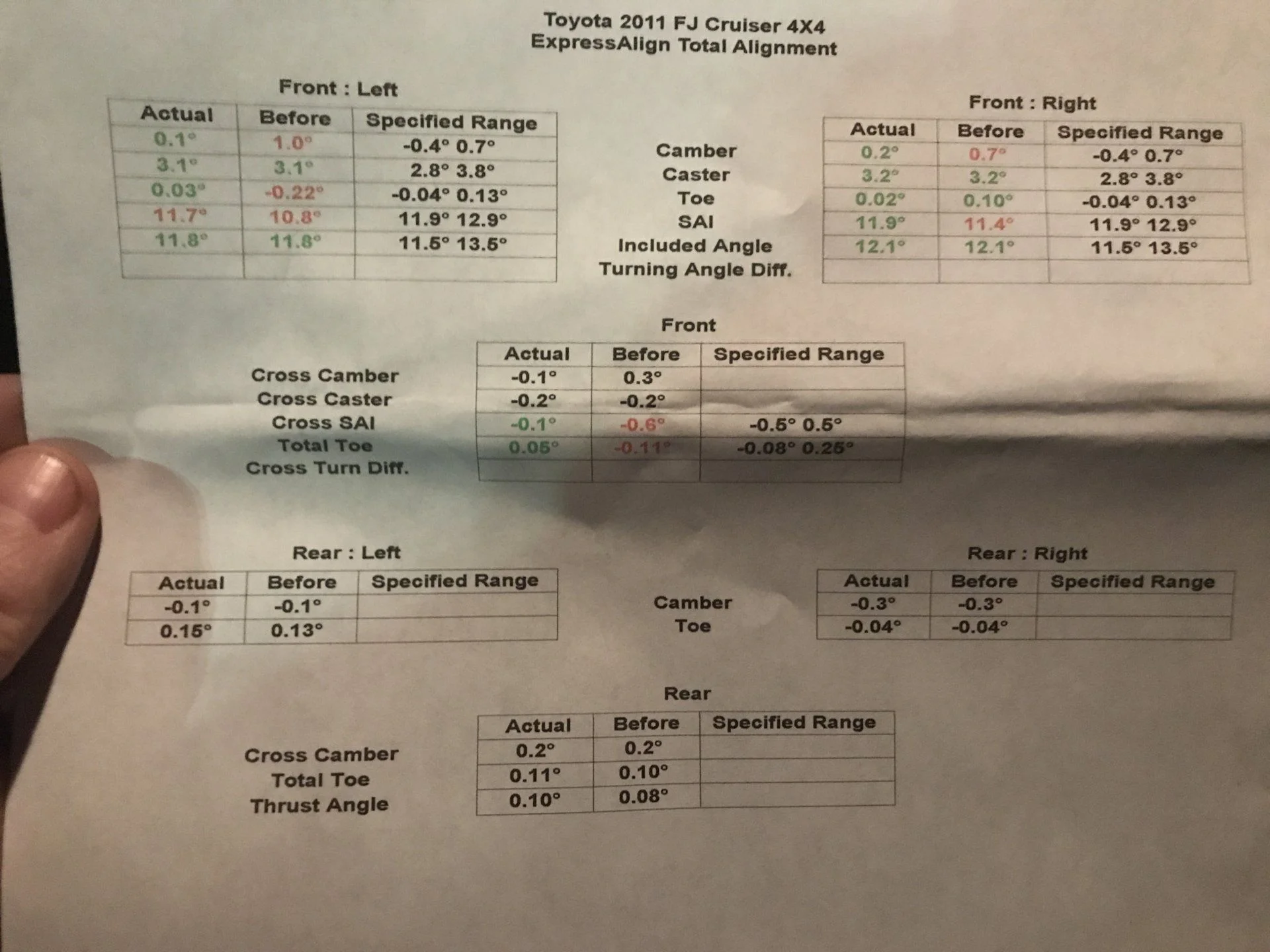

Squirreliness is usually out of spec castor. Can you post up your alignment numbers? I had 255/85/16s on my black 80 and it definitely wandered more on the road than my 285/75/16s did. Any 285 AT tire, especially new should balance out fairly easy if the rim isn't bent. Can you swap the fronts to the back and see if it's any better?

The new UCA pushes the caster up 2 degrees to get it in spec. I think the vibration is my biggest concern. I only bring up pizza cutters because they have a dedicated following in the fj cruiser forum... but then again so did the 285 wild peak folks... I like the look of skinnys but I don't know what to do.... hmmmm.....
