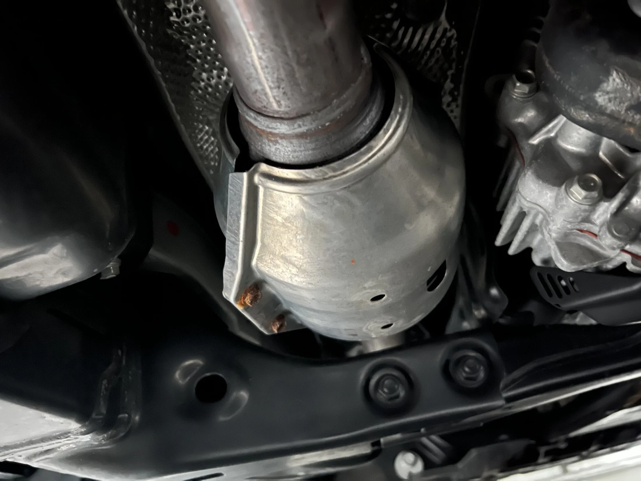

Two more for you all.
First picture, can anyone tell me what part I’m looking at? Appears to be some kind of heat shield on the exhaust (2 on each side, all on the front half of the vehicle). The housing itself is in good shape on all four, but all of the screws are completely rusted out and I’d like to replace. I’m fine ordering 4 new shields (?) in their entirety assuming they aren’t crazy expensive. But need some guidance or a part number.
Second picture - turns out when I said there was no visible rust on the KDSS I didn’t know what I was talking about. In any event, there is clear surface corrosion on the plate. The bolts look OK, but I haven’t tried to open them (never more than 3 rotations) yet. On the list for this week. Assuming they aren’t seized I will add this to the list for the rust restoration. Seems like folks either use an anti-seize in the threads and leave the bolts alone until they do a lift or marine grease the whole setup every time they lube the drive shaft. Thoughts on best way to prevent the rust from coming back after I have this cleaned up?
Those are your catalytic converters and the thermal shields that protect everything else under the vehicle from the huge amount of radiant energy they produce. The bolts and nuts are available separately.. If only two cats need them its four bolts, if all four cats need them it's eight.
Bolts: 90105-06011
Nuts: 90179-06007
That KDSS valve rust is completely fine, and better off than probably 99% of other LCs. Just use a wire brush to knock the stuff you can get to off, and coat with either LPS3 (aircraft industry grade, harder to find, more expensive, but designed for this exact purpose) or a thin layer of marine grease. You are free to remove the outer shield before doing so to gain better access.
Bolts: 90105-06011
Nuts: 90179-06007

Thank you! I thought those might be cats but I couldn’t imagine having four of those things on one vehicle. Wowzers. I will order a full set of nuts and bolts and replace the whole bunch. Super helpful.

As for the cat protector bolts, he hit them with penetrating lube and the goal is to get all 8 off the vehicle at some point next week. Mechanic is not optimistic and thinks there's a high likelihood they snap.
There is another part of the driver's side exhaust assembly that is badly rusted (where the front exhaust assembly meets the muffler assembly, with two large bolts holding everything together). Can't rust proof the exhaust anyways, so if things are too far gone I'm going to just drive happy until the exhaust fails and then replace the whole shebang. No rattles or issues at this juncture.
If you can, try to hit the bolts with "Kroil" or "aerokroil" penetrating lubricant. That stuff is expensive, but it's by far the best stuff I've used and IMO would give you the best bet of those bolts coming off intact without creative measures.
