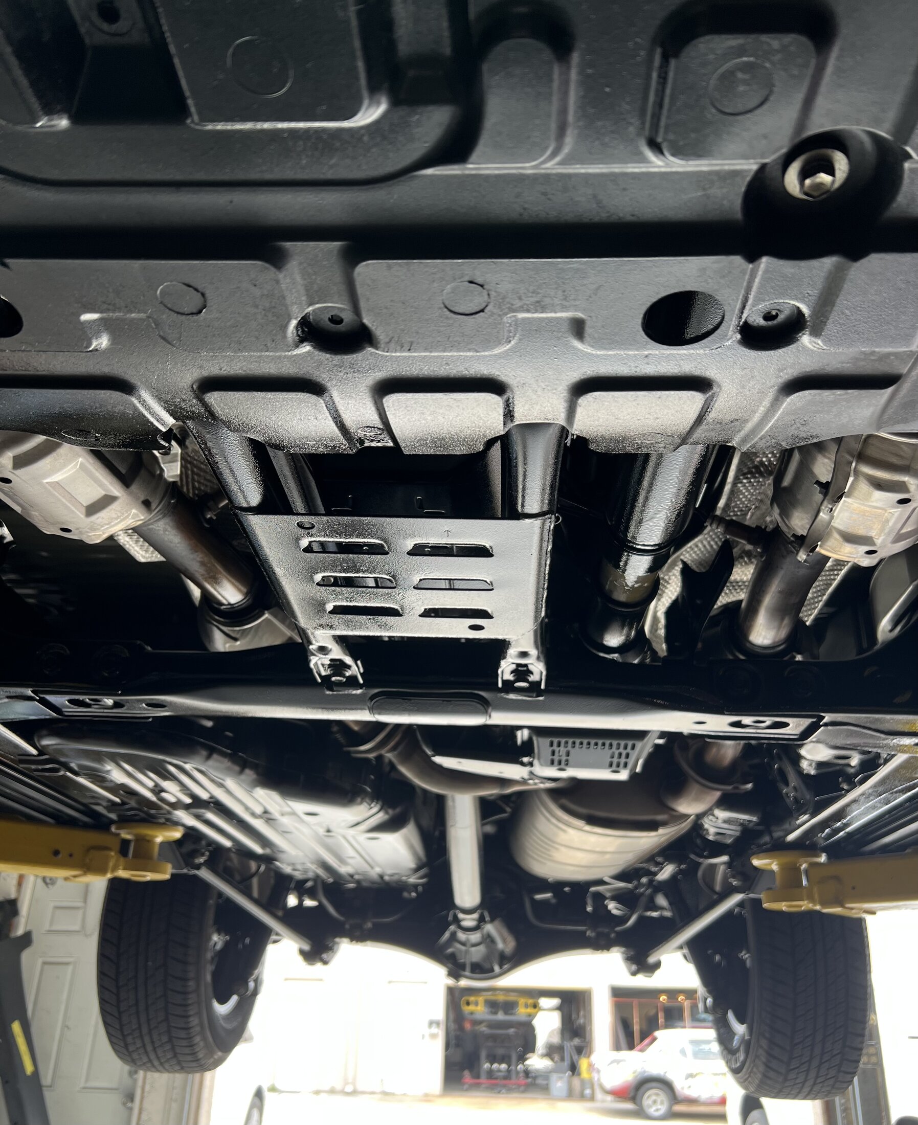

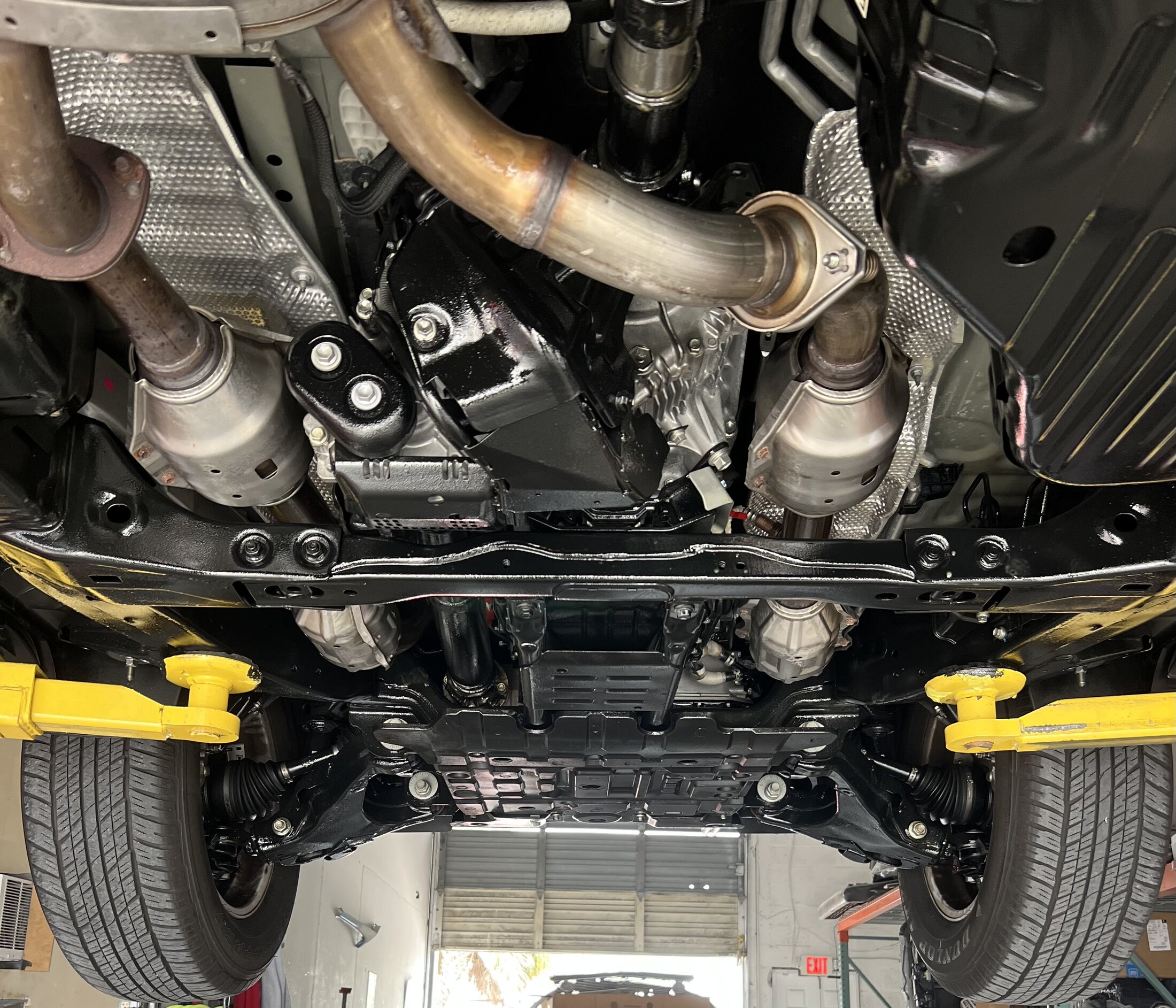

Update time.
I ended up taking the car to a local auto body guy for surface rust cleaning and fluid film application. He wasn’t familiar with FF but he was willing to do the work for a pretty good price. He used 3 aerosol spray cans, so probably not the most comprehensive application but the underbody looks nicely coated and he avoided the exhaust and brakes.
In terms of the KDSS valve, I had asked him to remove the surface rust with a wire brush and then spray liberally with LPS3. All of the rust came off easily, but he decided to paint the bare metal (and bolt heads) instead of just coating with the rust inhibitor.
I have seen some others suggest painting the assembly with Rustoleum, although I would have preferred he tape off the bolts. Rust on the KDSS valve should be off the table for the foreseeable future and hopefully the paint doesn’t cause the bolts to magically seize up lol.
Looks brand new
Yeah she cleaned up nice.
There are still a few bare spots on one part of the frame and on the fuel tank skid that will bug my OCD. I'll make a note to clean those up in the next few months.
Otherwise I think I've got a good, nearly rust-free baseline.
