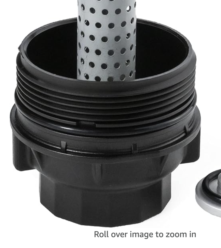

The drips are likely engine oil. The cartridge type filter is a source of mess if the lube guy doesn’t know how or take the time to drain the housing before removing it. The dealer made a mess of mine a couple times. And the access cover is pretty small for the oil pan drain plug so oil can get on the engine undercover if you’re not careful.
There was a very small amount on the garage floor this morning. Definitely engine oil. The mechanic had to replace the filter cap as he mentioned the OEM plastic cap was “wet”. I’m guessing that’s what I’m dealing with here. Hoping it goes away but I’m going to keep a close eye and will investigate further if it seems like something is loose under the skids.
Hmmm, might just be a communication issue but the filter cap is metal. The housing is plastic so I would be wondering which he “replaced”. You definitely need to drop the skid and look.
I had the same small drips after an oil change, was in a rush and did not push the gasket all the way down on the filter housing. Would be the first thing to check.
I’m thinking you are right. Some searching came up with this:
I think this is exactly what they did - plastic housing swapped with metal housing (part was like $20 and I can confirm it was aluminum).
I was in the area so I went back to the mechanic and let them know my concerns. They went through again and drips are gone now. Skid needs to come off soon anyways for rustproofing work so I’ll take a look at that time. Appreciate all your help man.
Thank you for the suggestion. The mechanic replaced this plastic housing with an aluminum equivalent during the oil change.
Regardless, drips have stopped now. I do think they were just sloppy when doing the work and some oil spilled and subsequently dripped on my garage floor.

@Mingus Dew an important part of swapping in the aluminum oil filter cap is to transfer over the longer support tube.. I’d want to verify they did that part of the job, personally.

Spoke to the mechanic - they didn't use the Toyota aluminum housing that would require the support tube swap. They used an aftermarket cap from a company called Dorman.
I might buy the Toyota cap and have them manually swap the support tube next time I'm there, but honestly the stock plastic cap was so crappy this is still an upgrade. Not sure how much I should care.
I hated that plastic thing. And the price to replace it wasn't cheap either. I guess I could get by with the plastic cap if it cost like $1 which is all it's worth.
I went with the cap made for the venza and swapped center tubes. It's worked great.

Yep the replacement plastic housing (15620-0S010) is like $75.
I'll roll with the aftermarket part for now and then decide what I want to do at my next oil change.

Oh you already put the Dorman on? I didn't know Dorman made one but it should be ok right? I don't personally know its quality.

Mechanic put it on yeah. The OEM plastic housing was cracked during an oil change prior to my ownership I suppose.
Mechanic said they’ve had good luck with this Dorman part and the online reviews are decent. Knowing myself I’ll probably get neurotic and opt for an OEM solution at the next change, but I figure even the worst Chinese aftermarket part can last 5,000 miles.
