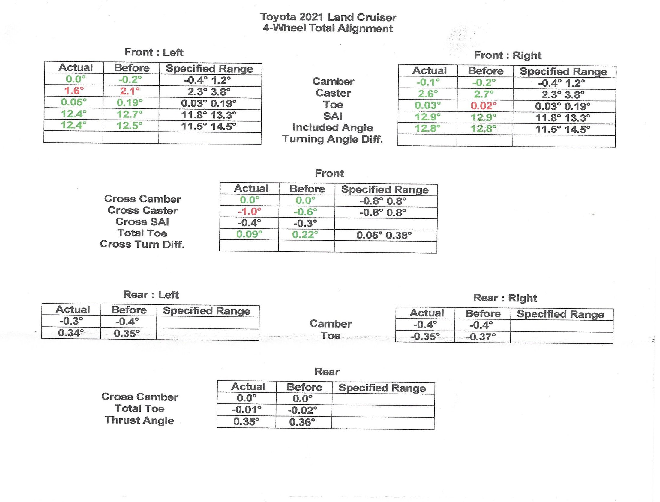

There are a ton of threads about alignment in the archives and lots of helpful information out there, but it’s a bit hard to parse for me as someone that doesn’t know much about proper alignment on these vehicles.
This could also be a useful place for general alignment questions and discussions.
My vehicle was drifting VERY slightly to the right previously (honestly it may have been the natural slant of the road) and an alignment was on my list of post-purchase maintenance items anyways.
Spec sheet below. The drift is maybe still there but it’s super faint. Smile and drive or should I ask the alignment shop to correct some stuff?
Edit: to clarify, no lift, stock suspension.
So the more I look into this (going down the rabbit hole of course…), it seems like my thrust angle and rear toe are way too high.
Hoping this doesn’t indicate something wrong with suspension components…
I’m probably the last person you want to have chime in on alignment as I believe I’m the most unlucky alignment recipient on the forum.
That being said, I also have a higher rear thrust angle and I mostly feel the pull to that side while under acceleration.
How is your drift manifest? At all times or more when accelerating?
I’ll add that you have more caster on the right side before and after alignment and this can cause it to pull.

You are exactly the person I want to hear from given your recent experience. Appreciate you taking the time.
Drift seems to be at all times. Like I said it’s very slight and not something you’d really notice unless you were specifically testing for it.
Noted on the caster, although a few of the threads I read suggested that you want 0.3 to 0.5 more caster on the right than the left. Not sure why admittedly.

Again, I know enough to just get myself in trouble. Looking at your before and after numbers, it looks like the only thing they corrected was the toe… also known and the “toe and go” alignment…
Since you have the same issue as before my gut tells me it’s the caster. While your cross caster allowance of .3-.5 may be correct, I’ve also been told to aim for as low as .15 or even square them up. The reason for the difference has been explained to me as correcting for the road crown but I’ve also heard that this is not necessarily true either.
Since you’re going down the alignment rabbit hole may I suggest grabbing a tape measure, or even using your hand, and seeing how the rear tires square up to the bumper or rocker panels. If one side is close to the rocker or bumper than the other than this could cause your cruiser to crab walk which would make you correct with steering input.
I’m sure more wiser than me will chime in and you and I with both be taking notes. A big issue mine was having was solved and it definitely came from help I received on here. I’m still having some pull to the right and I believe it’s due to my rear thrust angle. We just got home today so I have plenty of maintenance that’s now due so I’ll be under there this weekend doing fluids and checking over things.
15' (minutes) is 0.25 degree
Find a 2 lane road, preferably in middle of nowhere and drive on the other side of it for a minute, obviously make sure no one is around. I’ll bet it drifts slight left due to crown
the reason I prefer zero cross caster is it can conceal issues and for the reason noted above - not all roads are crowned to the right ditch and cross catering generally annoys me when I drive
Thanks for all the replies everyone. I was less than impressed with this alignment shop so I’m going to just leave things alone for now. I plan to go to Palm Beach Toyota early next year to do a full fluid replacement on the truck (tranny, power steering, transfer case, differentials, coolant) and will ask about the alignment (and especially the caster) at that time. Supposedly they have some master techs that are familiar with 200s. Fingers crossed.
In the meantime, I would be interested to learn why the thrust angle on my and @Artie’s truck is so high. My understanding is that normal angle is between 0.0 and 0.2. And I’ve definitely seen other alignments on here that achieve that (including with lifts).
I know there is not much you can do to adjust rear alignment outside of replacing suspension components so it is what it is I guess.

For what it is worth, here are the last alignment numbers for mine:
It has a 1.2 split to the left.
